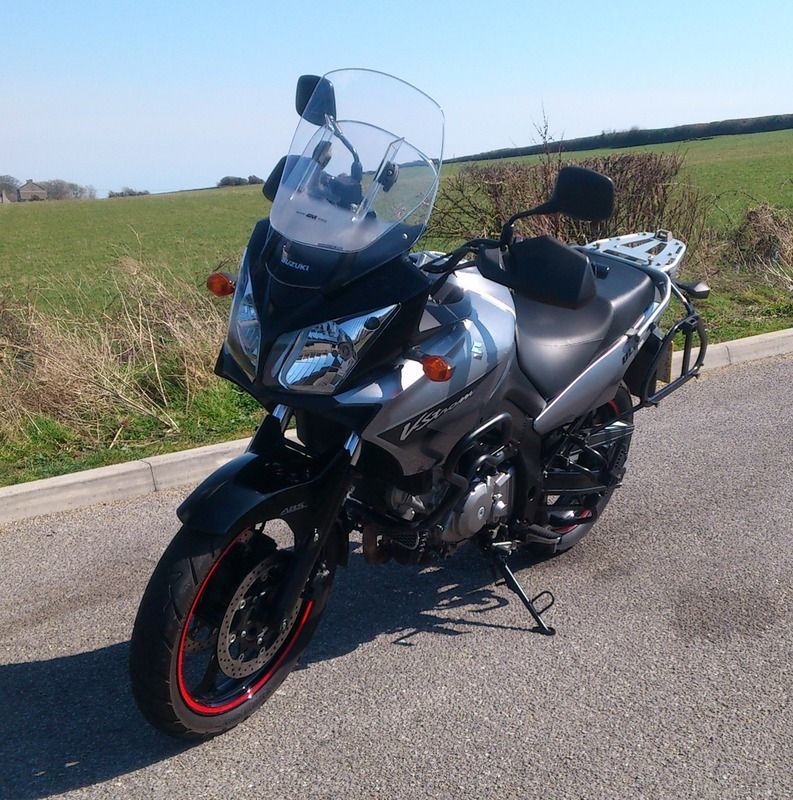

Splashed out yesterday and treated the stable to another bike. Something more suited to 2-up & touring.
..and a love her... :)
Here she is with the pannier & top box attached
2007 Suzuki V-strom 650.
I was expecting to be underwhelmed compared to the Hornet 600's power but I'm not, she's plenty quick enough..., and cruising at 70-90 is pretty comfortable. I'm doing the same speeds on my local A roads as do on the Hornet currently so she feels just as fast. There isn't that power surge though so the Hornet will still be 'nipping out for scratch' bike. :angel
Just really need a bigger garage now...

A very handy bike - you can do the weekly supermarket shop with that luggage! :D
The sv twin is also a great engine :D
Bling it up with a couple of projector spotlights on those engine bars :)

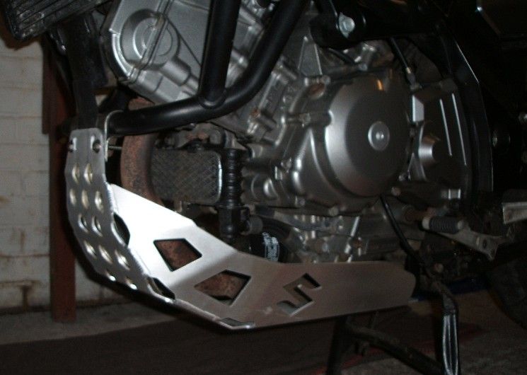

Tonight I finally finished installing the skid plate, it was a bitch of a job due to restricted access, and the Suzuki skid plate comes with a front fixing kit specifically for the Suzuki crash bars... however mine are Givi. :Bang So out came the sheet of stainless sheet I keep for special occasions and I made up some strong P clips to attached it at the front.
Went on OK in the end.
I also glued in some thin alloy sheet inside the pan to close off the front holes and stop the engine from getting plastered with stones, grit & water from the front wheel.
Just the oiler & Sat Nav to go now. :)
Glued?
Did I hear you right that 'bodgers material' has been used as opposed to nuts and bolts or least pop bloody rivets??!
You should feel ashamed of yourself dear boy :Bad
No hidden corks in use I hope laddie...?
:rollin :rollin :rollin

Glued?
Yup! :)
When I did a similar thing on my DRZ I drilled & riveted..., but only because large stones bounce off it. The main reason I 'glued' this one is that it's a bloody expensive skid pan so I wanted to avoid as many additional holes as possible just in case I need to set it free on ebay in the future.
I'd normally get hold of some proper auto bonding stuff like sikaflex but I have just picked up a couple of tubes of Screwfix's finest "I CANT BELIEVE IT'S NOT NAILS" and it said it was suitable for metal so I thought I'd give it a try - so far so good...

That's a good idea blocking the holes up. :clap

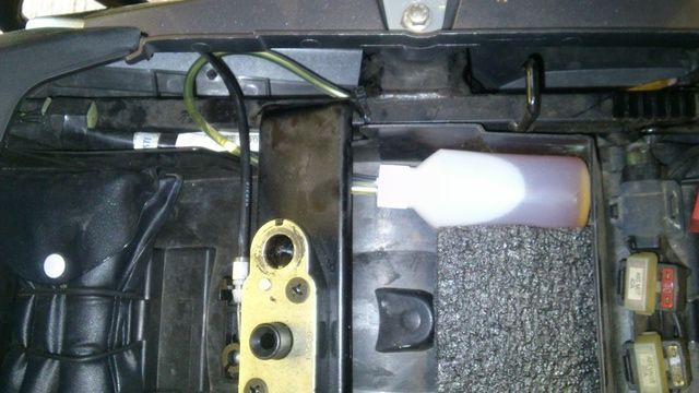

Here it is...
Standard reservour

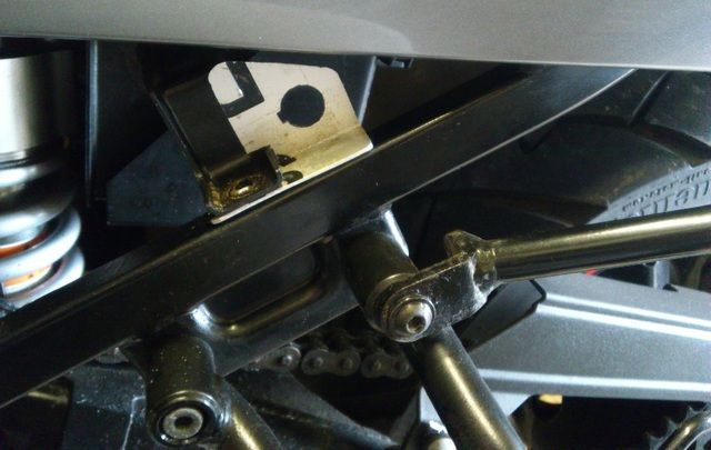

The bracket took some thought but came up with this shape
It fits under the ABS box bracket but also rests against it for support when pressed
Painted black to blend in

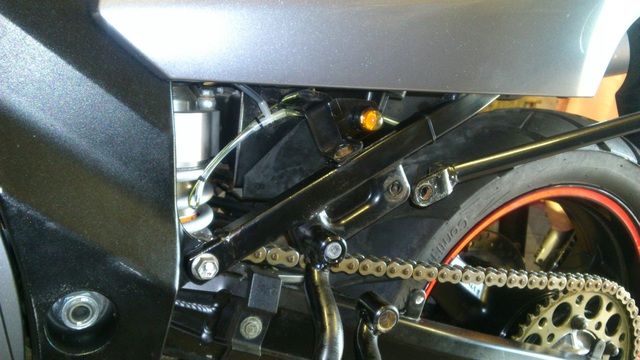

There it is
Quite a drop for the oil to fall to meet the chain but if any lower the chain can get it when the suspension grounds out. If it misses in use I'll just extend it in towards the sprocket more, and lower it.

Nice one :clap
Like the bracket with the little cut out 'tab' ready to accept an unmodified primer bulb :D
Oh... also noticed the chosen site enabling left hand operation, mind you how could one not use the Hornet's clutch bracket... it's made to measure!!
Really pleased with mine it works faultlessly, I just wish I'd fitted it three years ago!!!

Cheers :)
Yes..., no point making a bracket when Honda supplied one.
Can still pump on the move, just have to do it down hill. :angel
