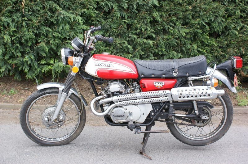

It's goodbye to the monkey bike, shortly to be advertised for sale.

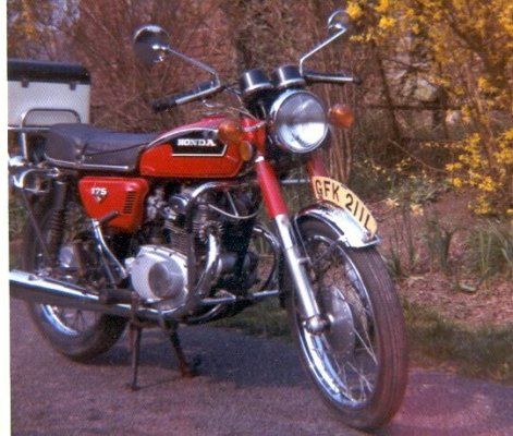

I've bought myself a 42 year old Honda CL175, very similar (apart from exhaust) to the CB175 that I owned 42 years ago. Went to look it over this morning, a few problems noted, but not bad considering its age. US bike, one owner, 14K miles, last used in '79.
Back in the day ..

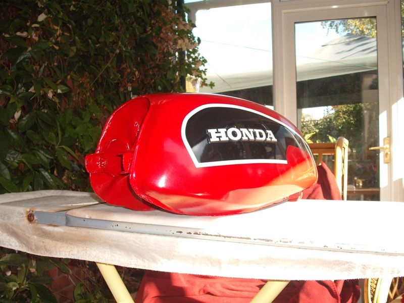

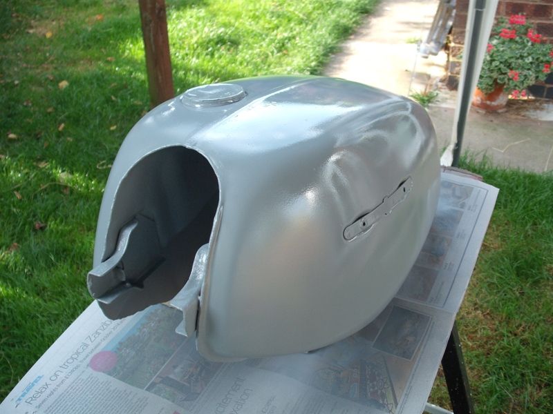

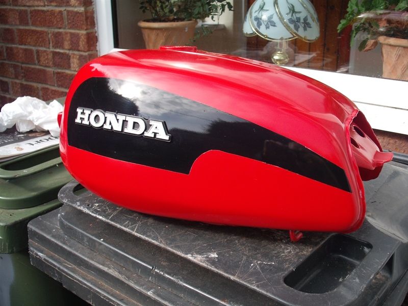

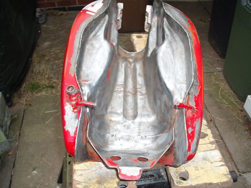

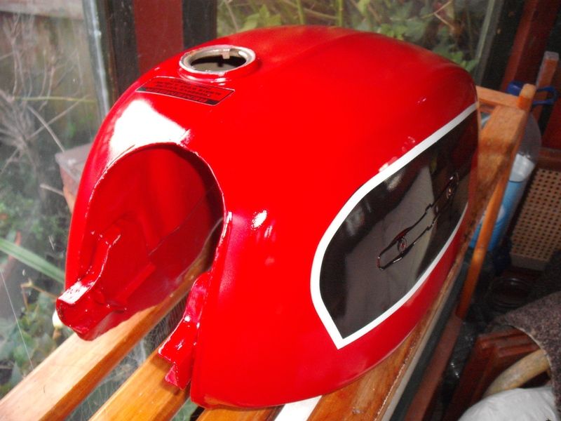

Getting on with painting the fuel tank. I want to go for the CB175 look, even though the CL (Scrambler) tank is a different shape.
Rust removed.
Zinc primer, followed by standard grey primer.
Four coats of Honda Milano Red, flatted down between each coat, then masked off for a couple of coats of black. White pinstripes to follow, then a few coats of fuel proof lacquer.
See that brick wall ? I built that. 8o
I'm aiming for something like this, 1973 CB175 tank

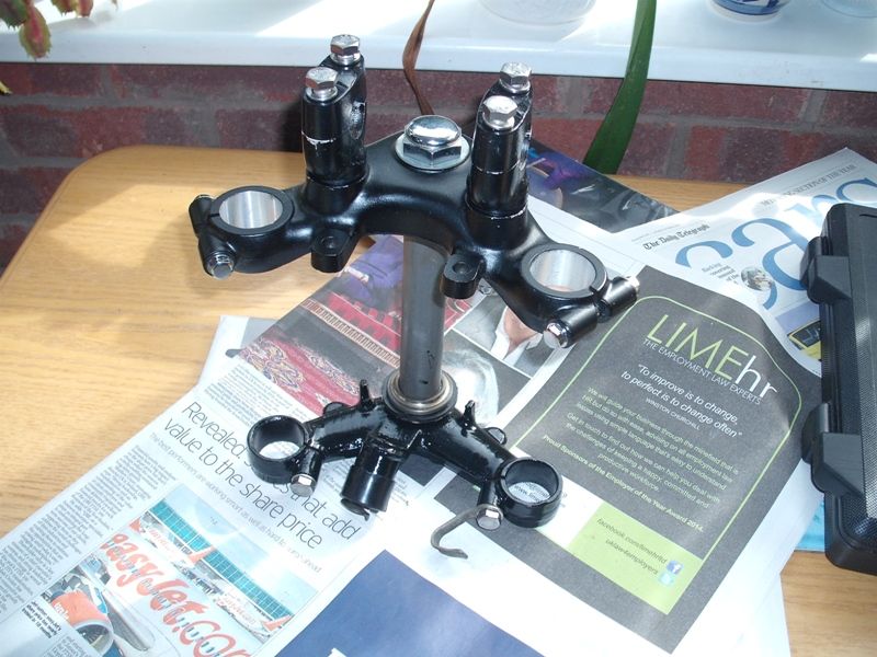

New top yoke and repainted bottom yoke, stainless bolts fitted.
This all started out with every intention of it being a rolling rebuild, but every time I find a rusty bit it seems a shame not to sort it out.

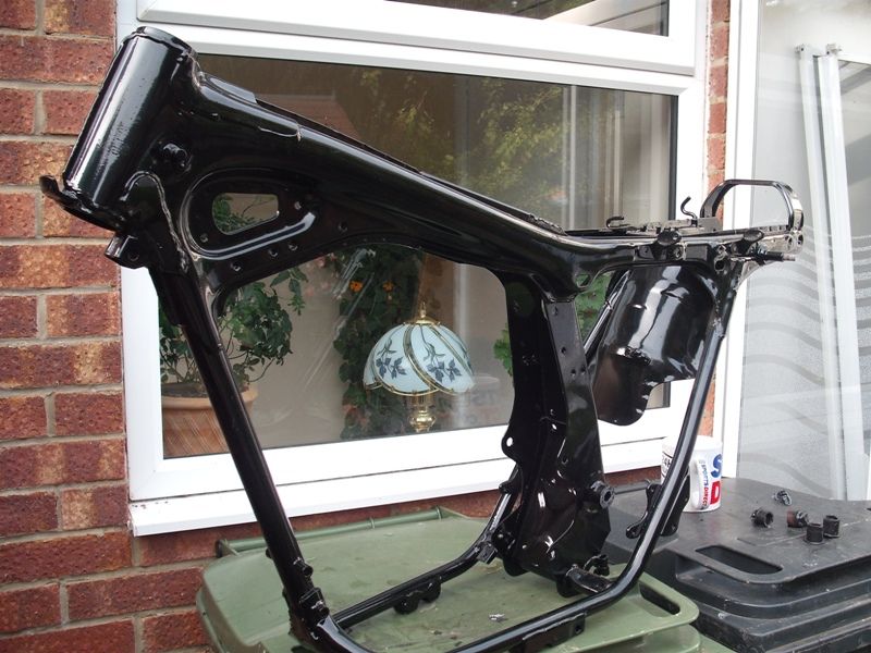

Frame, swing arm and centre stand went off to the powder coaters yesterday.
There is a small rust hole in a lower frame rail, which I was going to get sorted after I'd had the frame cleaned and coated. Arse about front I know, just couldn't stand the sight of the greasy dirty frame.
However, lad at the powder coaters told me that they also have a fabrication business, so they'll sort the welding out at the same time, result !

Just needs the fuel resistant lacquer now.
Just hope I don't bugger it up at that last stage.

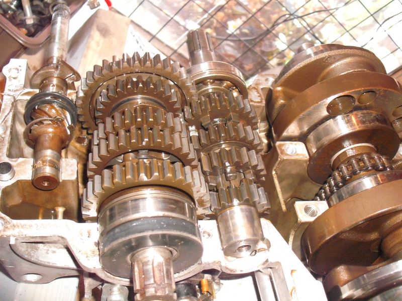

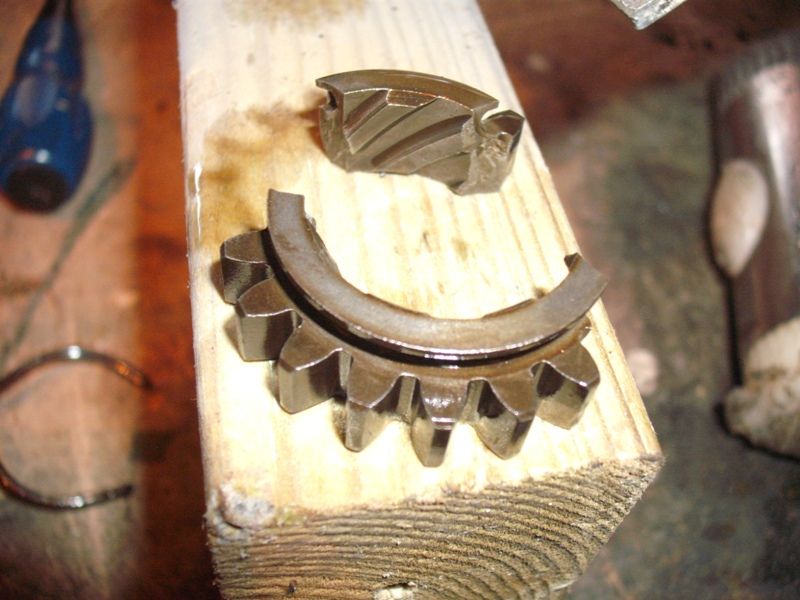

And this afternoon I took the gearbox apart, discovered why the kick start didn't work ...
This little blighter. Need to find the rest of the fragments now. Whether I'll be able to source a new bit is anyones guess, not looking hopeful at the moment.
But then, it's got an electric starter, so why worry ?

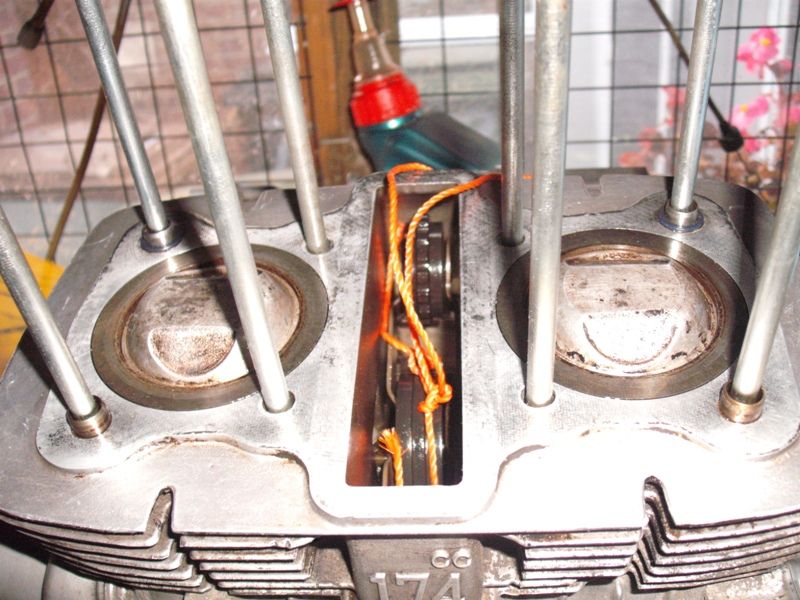

It's an odd one, this.
The bottom half of the engine was untouched, virgin case screws etc, which all came out easily with impact driver. Apart that broken cog ( found all the bits, reconstructed it, happy that nothing is lurking), gearbox looks like new. My digital photo suggests that it is rusty, it's an optical illusion, just a golden coating of oil. Clutch plates are unworn, actually slightly thicker than spec.
Top half is a different matter. Cam, rockers and rocker arms all look fine. Some muppet has had a go at the left hand cam bearing / tacho drive, screws in there all chewed up, bearing face doesn't look to clever.
Head and valves well coked up. One side leaks through the exhaust valve when combustion chamber filled with paraffin, so a good decoke and valve grind is indicated. Pistons crowns also well coked up, cleaned up easily with a brass brush.
Bores don't feel worn, no wear ridge. Haven't checked the rings yet, couldn't budge the cylinder last night. WD40 down the bores doesn't leak away, but brings up a lot of rust when crank rotated to TDC. At the worst, David Silver has 1mm OS piston kits available, just need a decent rebore specialist, take it out to 181cc, more power :lol
14K miles on the speedo, assuming it a) works, b) is original.
My guess is that kick start broke and bike was laid up. Maybe someone over there decided to restore it, then abandoned the idea, because a lot of the chassis bolts were loose, wheels had been cleaned up, layer of light oil over everything.
Anway, I've now sourced the 'unobtainable' gear box pinion, three times over. Got a complete assembly coming from the US, then I found a dealership in this country with a list of old new stock Honda parts, two of these gears in stock, ordered one from them this morning. As well as the one I'd previously ordered from MSP in Holland, although I expect they took my order but will then report 'part unavailable'.

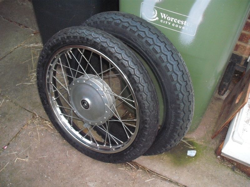

Dunlop K82 tyres expected tomorrow, for that old school TT100 look.

Lacquer went on OK without pickling or lifting transfers. :Pray
Now to let it cure for a while before final cutting and polishing.
K82 tyres arrived today. I'd forgotten what fun it was, wrestling with tyre levers and inner tubes. Amazed how heavy the chromed steel wheel rims are, we are spoilt with todays cast alloy wheels. I will wrestle with the rear wheel at the weekend.
For the old timers here, TT100 tread pattern on K82 tyres. Made in France, rubber feels 'stickier' than I remember.
And finally, a gratuitous look at the pistons.

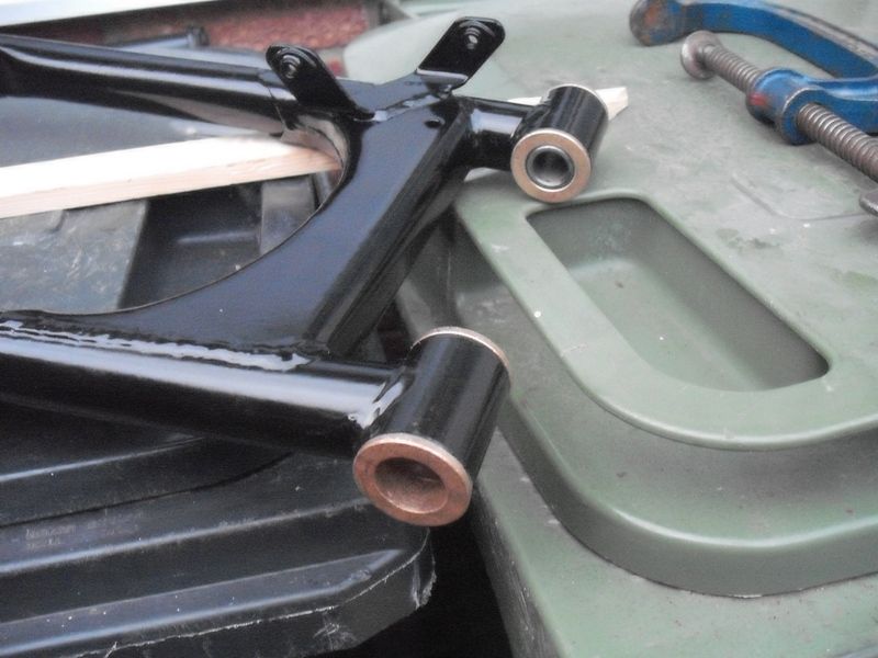

 Post Posted: Thu Oct 16, 2014 5:37 pm
Posts: 5330

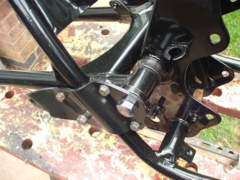

Shiny bits back from the powder coaters this afternoon.
120 quid to blast and coat frame, swing arm and centre stand, including welding up a rust hole in lower frame rail.

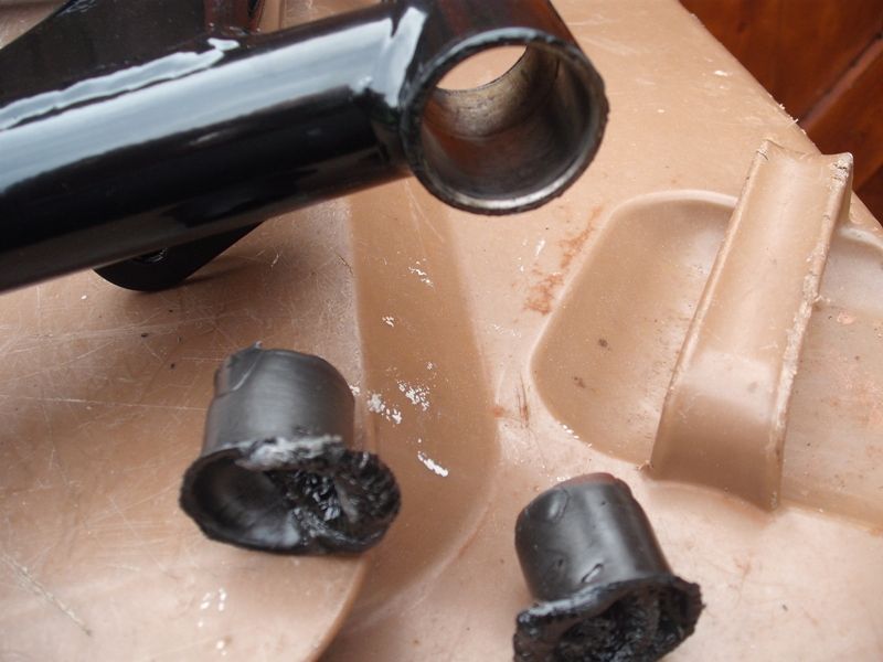

One problem. I'd masked off various bearing surfaces, and assumed that these bushes in the swing arm were metal, certainly felt hard enough.
Turned out that they were rubber. :Bang Worse still, they are no longer available, and even if they were, it'd be the thick end of 50 quid for four. :eek
However, I've found some bronze bushes with the correct dimensions, for 17 quid for four, delivered.
Thank goodness for the internet:D

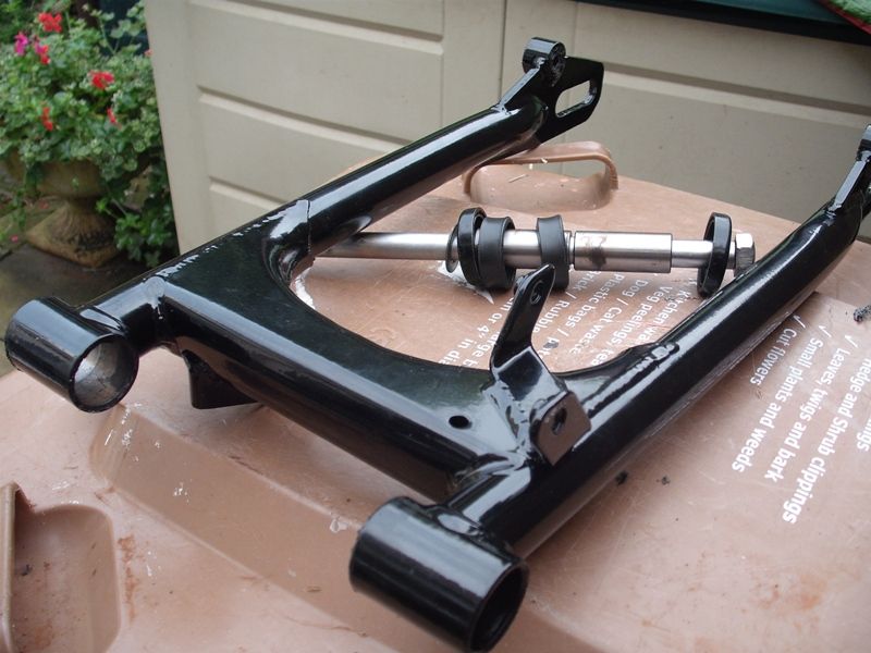

Back from a weeks hols away from bikes and computers. Looks like I missed the MotoGp race of the year, I have it recorded on the Sky box but not the same now I know the result, foolishly opened my MCN when I got in.

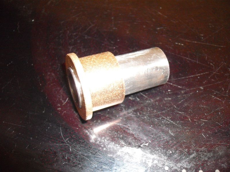

Bronze bushes have arrived, and look as though they'll be a perfect fit. Cam bearing has arrived from the US, waiting to be collected from sorting office (underpaid shipping fee :Bang ), and a package of sundry parts is on its way from the Netherlands (CMSNL).
Engine is going to need a rebore before I put it back together, some corrosion damage to bores, and rings rusted solid into pistons. I will get oversize pistons from David Silvers, but wondering who to trust with the machining ? Local car engine place has been recommended (Malvern Rebores) but I wonder if they can do it to Honda standard ?
And there's a classic bike show and autojumble at Malvern tomorrow, will try to attend that.
 Post subject: Re: New Project
 Post Posted: Wed Oct 29, 2014 9:05 pm
Posts: 5330

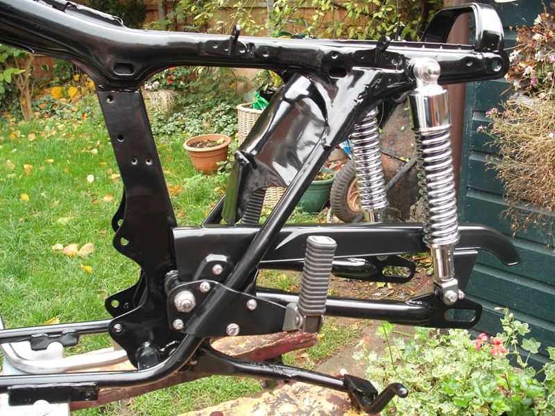

A bit more progress today, although nothing goes as simply as expected.
The bushes were a perfect fit, bearing on the swingarm spindle was a nice sliding fit.
Until I pressed the bushes into the swing arm. I then had to ream them out, using a 20mm blacksmiths HSS bit, to get back to that nice sliding fit.
And then the shoulders on the bushes were too thick, so that the spindle would clamp up onto the bronze bushes rather than onto the ends of the bearing sleeves. So I had to file them down until it all fitted as intended.
I've visited a few local hardware places in the course of the above. Screwfix are consistently excellent, and incredibly cheap for A2 stainless nuts bolts and washer, packs of 100 for a couple of quid. Toolstation for the 20mm bit, hopeless. Website showed it in stock locally, so I 'clicked and collect', only to find that they expected me to wait two days for bit to be delivered to store. :Bang So I bought the one they had on the shelf, then had to go back two days later to get a refund on the bit ordered on line. Ridiculous. And then they wanted my 'photo ID', whatever that is. I don't have any. :Bang
And finally Machine Mart, had to pop in for some more files, mine had seen better days. I was tempted to ask for a b*****d file, just to see it the counter guy would retort, 'Yes, and we have some f*****g spanners as well ...

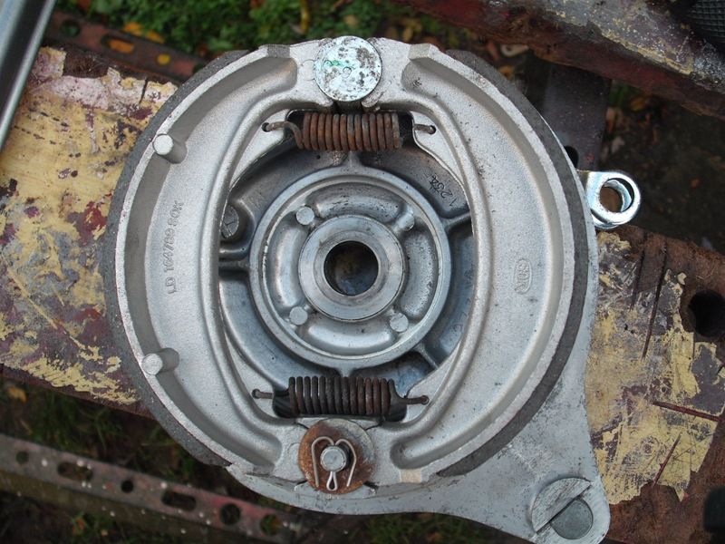

Shocks, chain guard, centre stand and rear brake pedal fitted, fixings swapped for stainless.
Next job, fit new brake shoes, head stock and forks, get the chassis rolling.

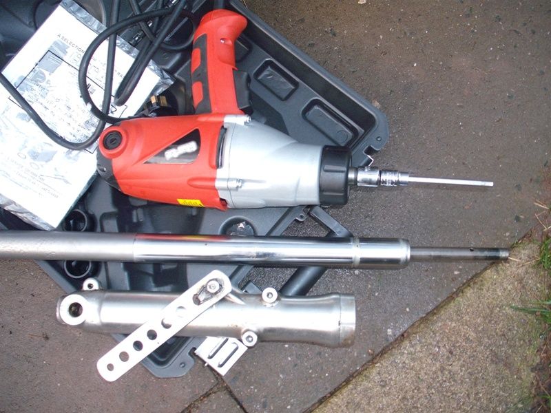

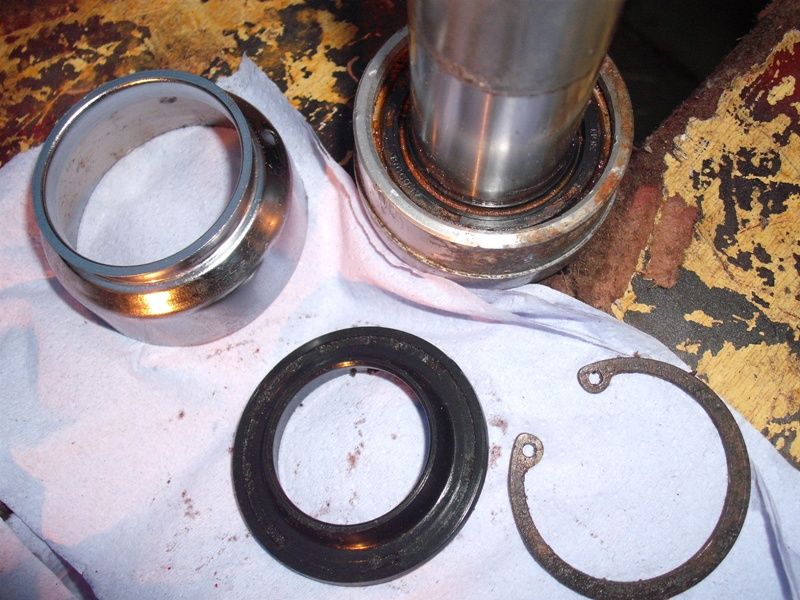

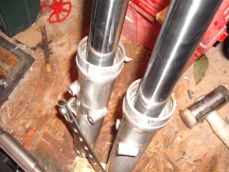

Currently having a battle with the fork seals. Got the top covers off, but need a longer Allen head socket to get at the bolt in the bottom of the fork. Just hoping my impact driver will do the trick, otherwise looking at electric rattle guns ..
 Post Posted: Fri Oct 31, 2014 8:35 pm
If you have not got an impact gun the trick is to crack the allen bolt off very quickly.
 Post Posted: Sun Nov 02, 2014 6:28 pm
Posts: 5330
This did the trick, 450nm of torque. I've never used one of these before, expect I'll find plenty of other uses for it, like sprocket nuts etc.
Forks taken to bits, cleaned in paraffin then reassembled, waiting for new seals to arrive. I'm planning to use the old seals and some plastic waste pipe to drive them home.

Joe, the oversize pistons, complete with rings, gudgeon pins and circlips, were £19.95 each, two of, obviously. Honda pistons not available, but these are Japanese made items, alleged to be high quality. Certainly look the same as the OEM ones.
Machining cost at Malvern rebores - they quoted me £50 plus vat for a twin, so presumably it'd be something less than a £100 for a four ?
Steve - yes, it was a distress purchase from Machine Mart, heavy old beast but it got the job done.
https://www.machinemart.co.uk/shop/product/details/clarke-cew1000-electric-impact-wrench
Got the fork seals fitted now, fork ready to go back on bike once I find my measuring cylinder to get the correct amount of fork oil in.

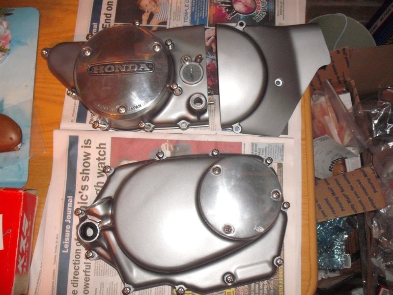

Engine cases rubbed down and painted with Halfords steel wheel paint, good match for original paint. Rest of the engine will be left bare aluminium, as standard. I saw a 400/4 at the recent Malvern show. Guy had sprayed the entire engine with silver paint, looked bloody awful, IMHO.

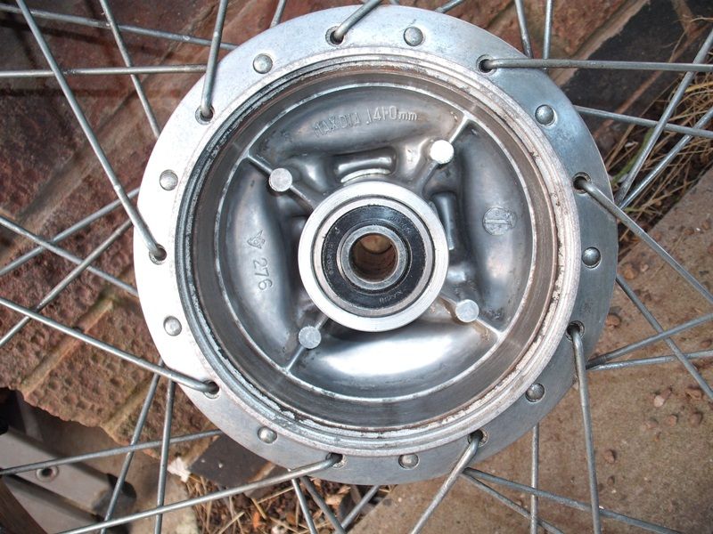

Rear brake and hub cleaned out, new shoes fitted. Wheel bearings seem fine.

Front brake stripped and rebuilt.
Forks in, chassis rolling. Now to sort the handle bars.
