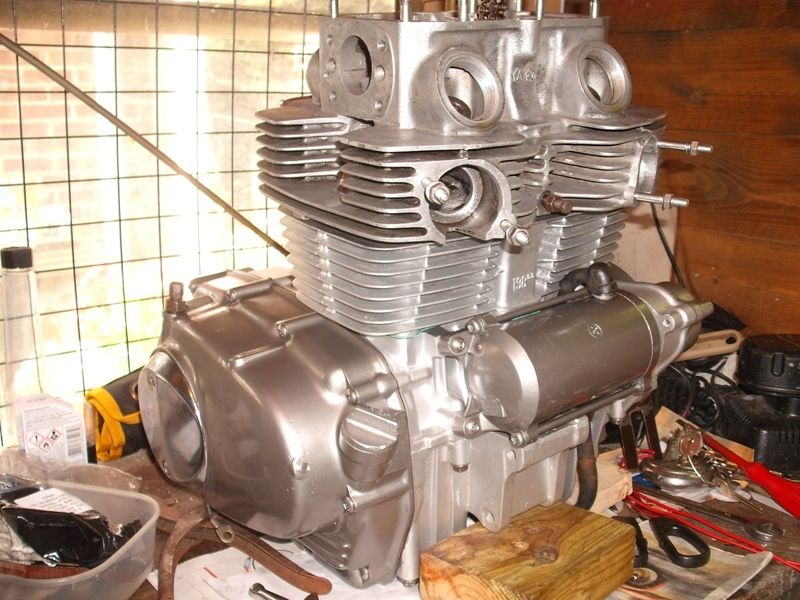

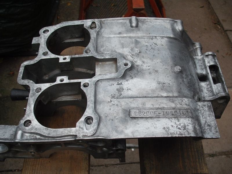

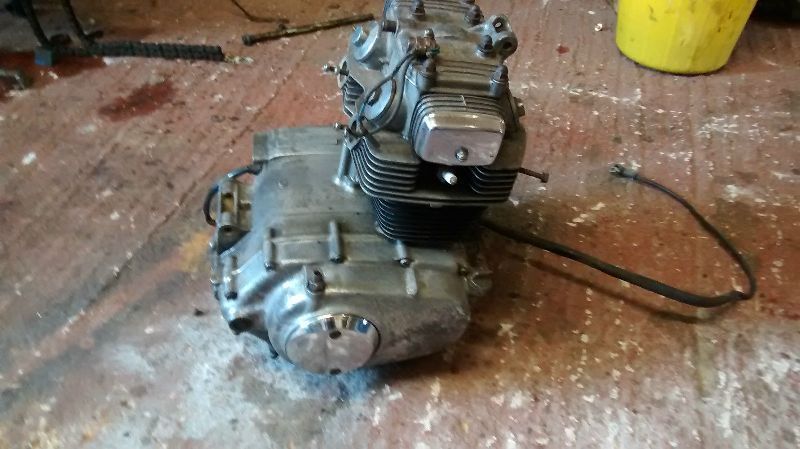

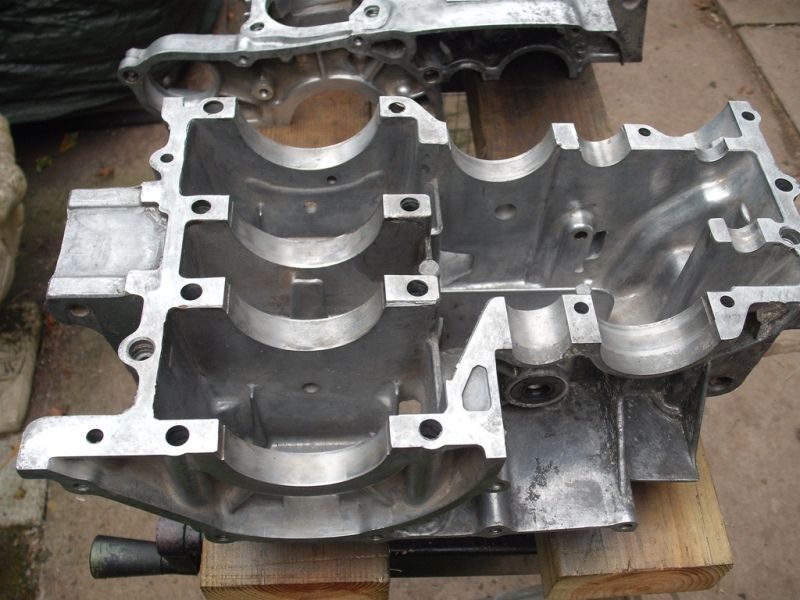

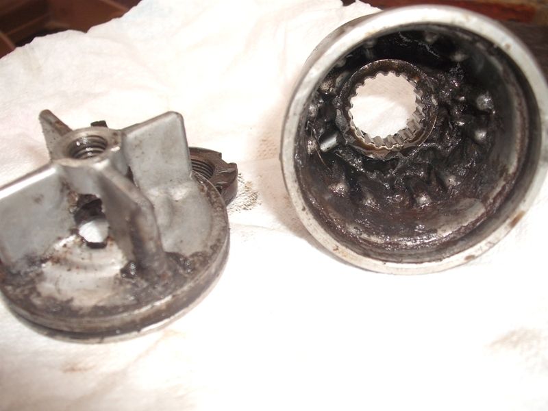

Here's the CB200 engine as delivered.
Cases very corroded.

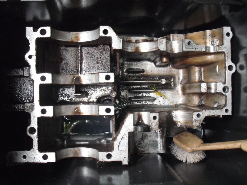

Unlike my 175 engine, which had obviously never been apart, this 200 engine had been attacked by a spanner muppet. All case screws and bolts variously mangled. Both pistons had one or more rings missing. :eek
Oil had been drained at some point in prehistory, then internals left to rust. Gudgeon pins were seized into the rods, used a long bolt and sockets to push these out. Advance mechanism rusted onto the end of the camshaft, took a gear puller to get that off. Otherwise, came apart OK using impact driver, proper JIS screwdrivers, and my new electric impact wrench. :D
Cases full of filth. One of the oil separators (windage plates in US speak) was lying loose in the bottom of the case, looks like muppet had pulled the retaining pin. Plate was bent where it had clearly got caught by the rotating crank. Both plates were very rusty.
Oil spinner (closest thing these engines have to a filter) was full of crap and aluminium filings.

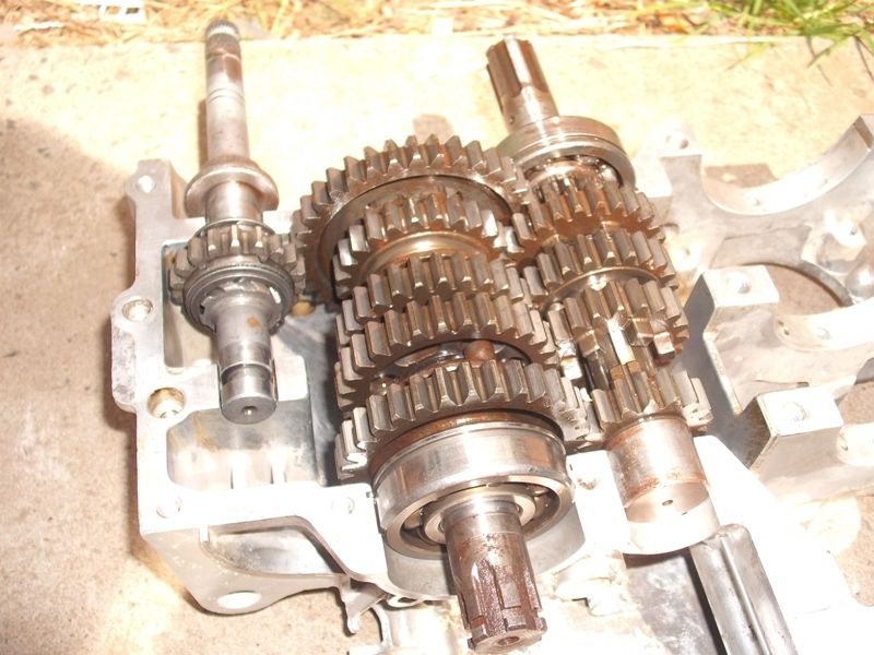

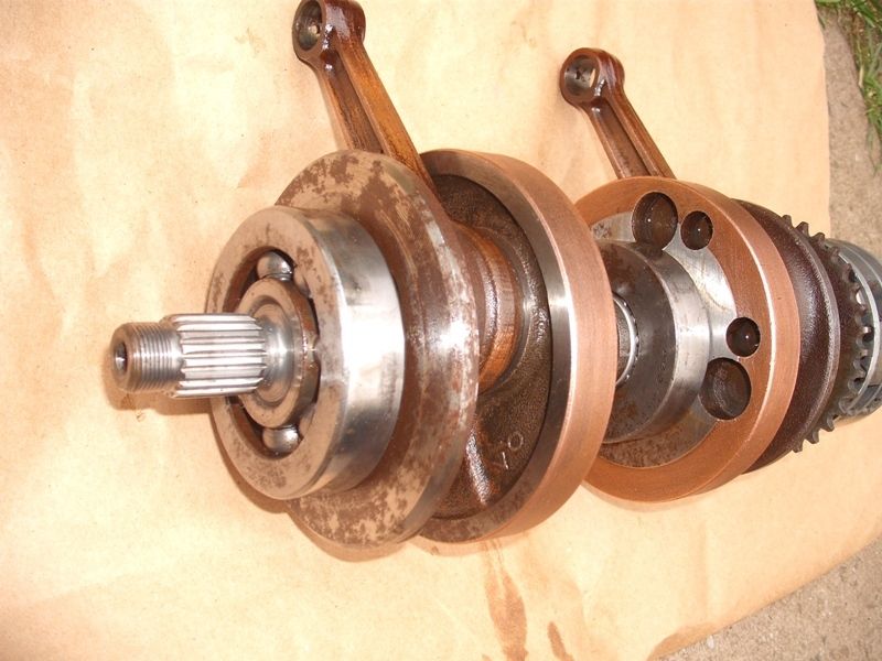

Gear selectors, crank shaft and gear cluster all covered in rust.
Rusty gears in cleaned top case, with my spare CB175 kick start shaft in place, CB200 one snapped off flush with case, more muppetry.

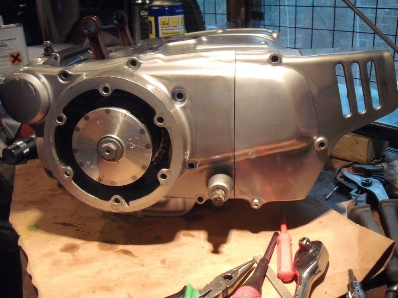

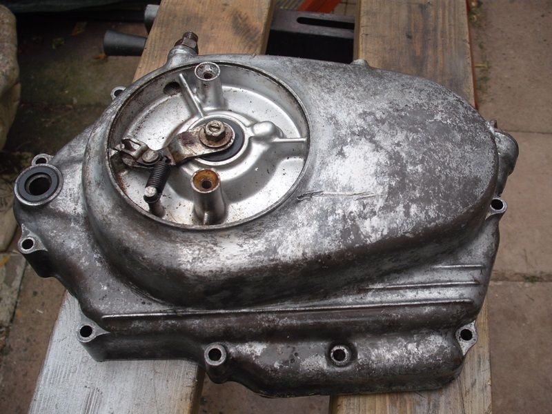

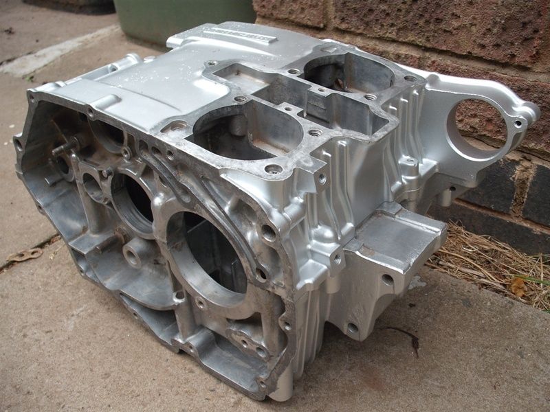

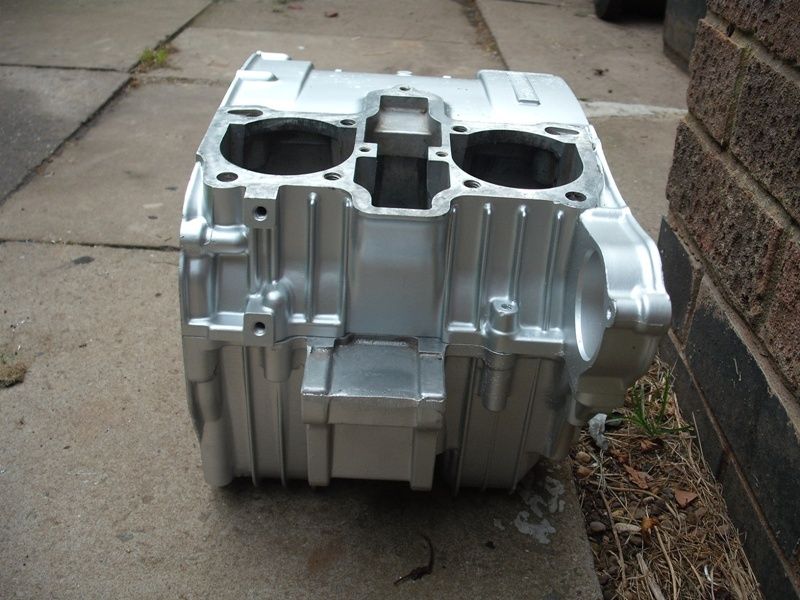

Wife is out this morning, so I have the oven set at 220c, baking the paint onto my freshly rebored cylinder block. Extraction on max, all doors open.
I've already cleaned, painted and baked the rest of the cases, also reassembled the bottom end of the motor.
Cleaned, before paint (Simoniz engine enamel, as recommended by Yambits website)
Painted and baked.
Partly assembled

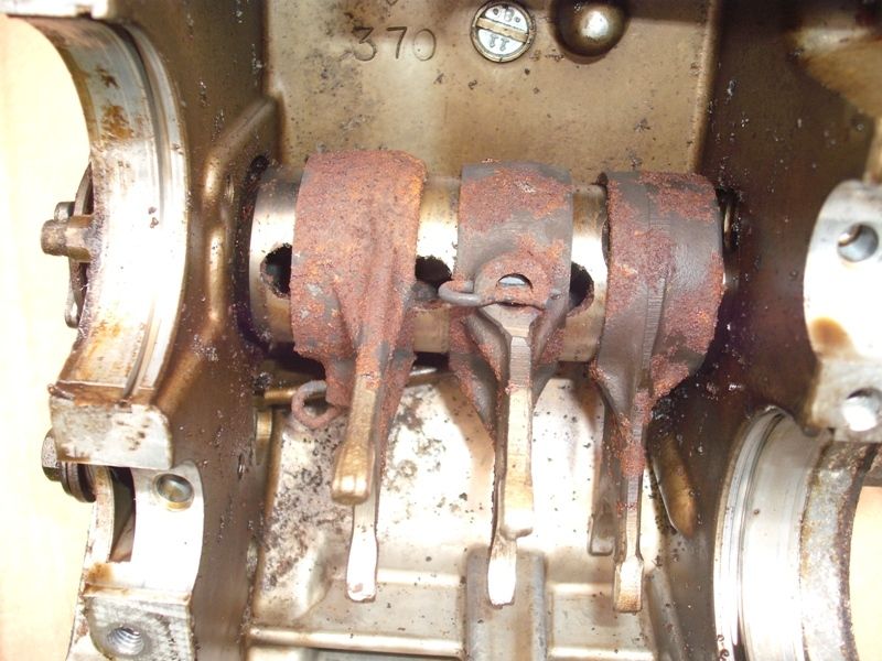

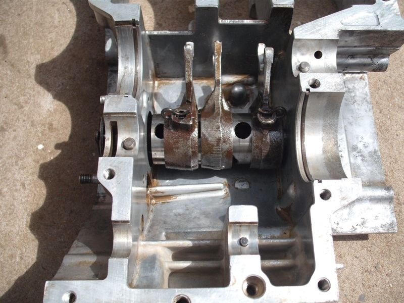

That rusty gear selector
Before
After

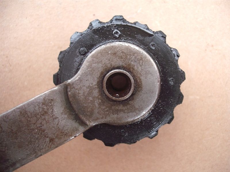

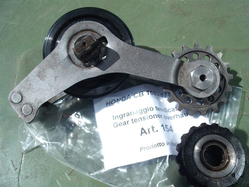

The cam chain and tensioners were obviously knackered, or had never been adjusted, as shown by these grooves worn in cylinder head, also oil spinner full of aluminium filings.
Larger tensioner wheel was also very hard and brittle, so that was replaced using a new pattern part from David Silvers. Smaller toothed wheel unobtainable, so replaced by fancy part from Capellini racing parts. Also fitted a new DID endless cam chain.

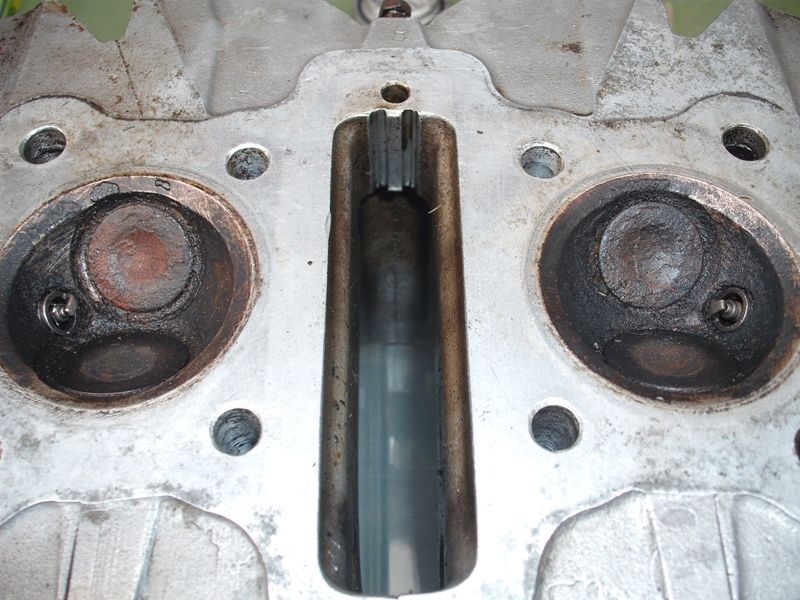

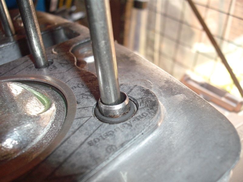

What I hadn't realised is that the cast iron liners would drop out of the finned alloy jacket when I picked the cylinder up, using the oven gloves. :eek
A bit of juggling with very hot metal later, and I got the liners back in and left it all to cool down. Seems to have gone back together OK. I guess that when (if) the engine runs I'll be able to retorque the head nuts and pull it all back into line, if required.

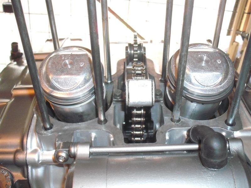

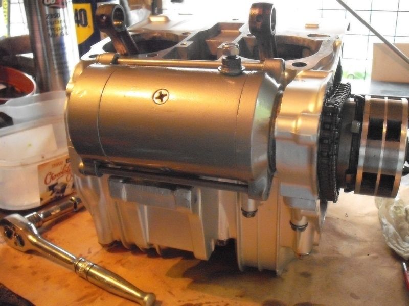

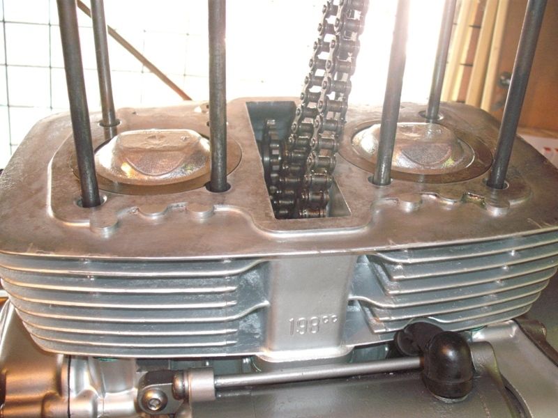

A bit more progress today. Got the rings onto the pistons, and the pistons onto the rods.
Gaskets and O rings in place, pistons supported on home made copies of tools shown in Honda FSM
Cylinder dropped into place quite easily with those piston supports in place, much easier than the last time I did this.
Head dropped into place to keep dirt from falling into the engine.
Had to stop work at this point. I'm waiting for a cam bearing to arrive from CMS in the Netherlands. It should have been here today, but looking at the UPS tracking it had obviously got held up in the nonsense at the Channel Tunnel

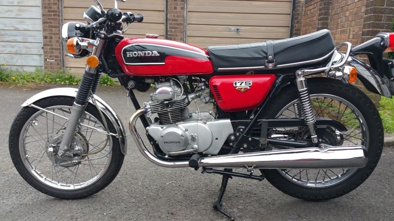

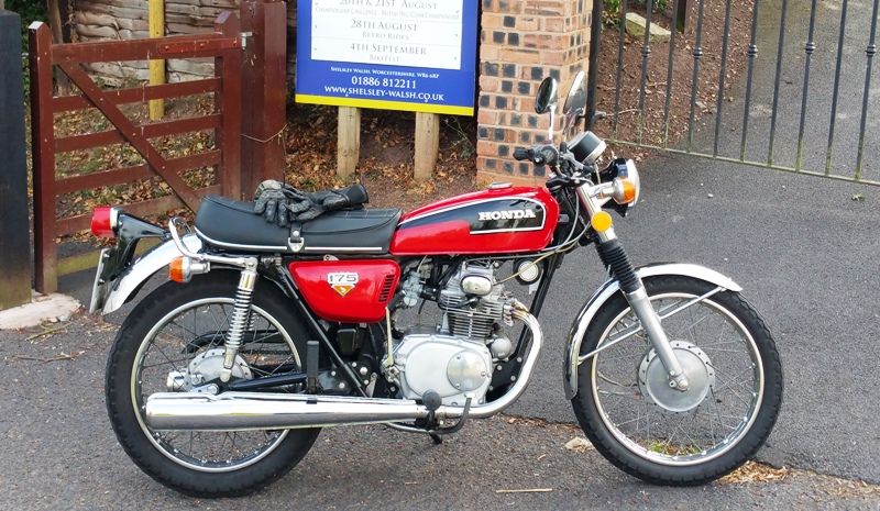

I haven't posted in this thread for a while, I've been over on the Honda Twins website.
http://www.hondatwins.net/forums/1-project-logs/42515-my-cl-cb-175-rebuild-thread.html
I never did get around to fitting that CB200 engine. Instead, I bought yet another 175 engine and rebuilt and fitted that, done well over a 1000 miles on that engine now.

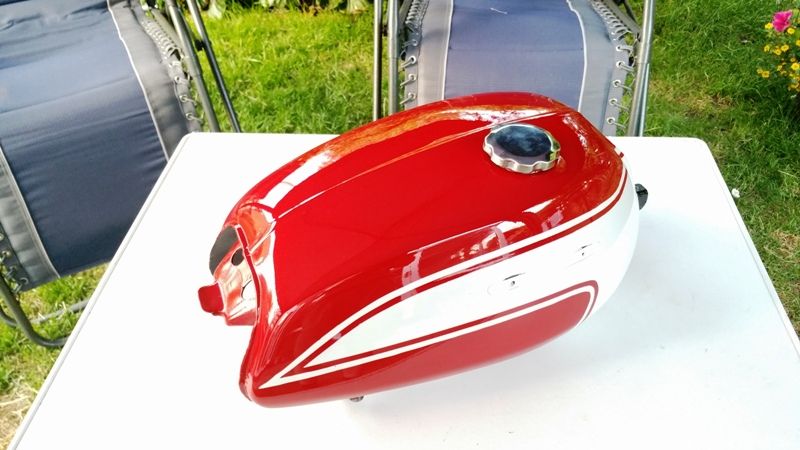

Recently fitted a rebuilt / resprayed ( by me) CB tank and seat, to replace the CL items, also a UK spec rear light, various shiny internal and external bits, list goes on for ever, see thread above.
And here it ( I don't assign a gender to my bikes 8o ) it is ..

It'd be a shame not to run it at some point. But the two engines do have a fair number of parts in common, so I suspect I'll probably hybridise the three motors.
First CL175 engine I rebuilt is currently sat on my bench, was running well when I pulled it, engine number matches the frame and V5. Fitted with a brand new CB200 oil pump, higher output than the 175 item.
Current 175 engine (both 175s are now bored out to 180 ) has the higher output Cb200 generator fitted, also CB200 rubber inlet manifolds.
CB200 engine has a better cylinder head design, and will fit onto a 175, better oil pump as mentioned above, and a higher 5th gear. All those bits could go into one of the 175 motors.
CB200 crank, pistons and barrels WILL fit the 175, with some case modifications, but requires different clutch basket and primary gears, which I have. Also has to run the CB200 cam, because the cam chain sprockets are different on the 175 and 200 cranks. So it would be possible to make my original 175 engine into a 200 (actually a few cc more than 200 with the 1mm overbore), keeping the original engine number.
Real world power is no different between 175 and 200, I've ridden both back to back in the day. Honda claim 17bhp for the 200 and 20bhp for the higher revving 175.

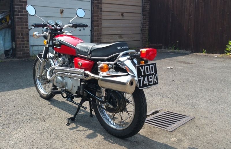

Remember this ?
Morphed into this, constantly adding new shiny bits to it.

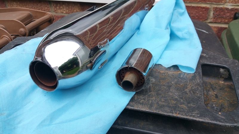

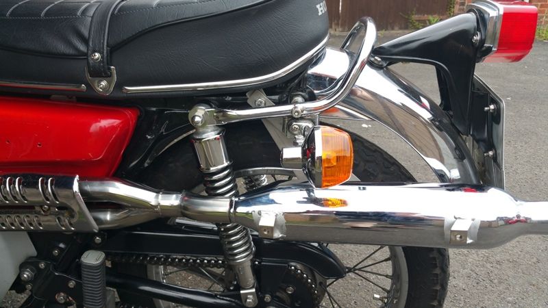

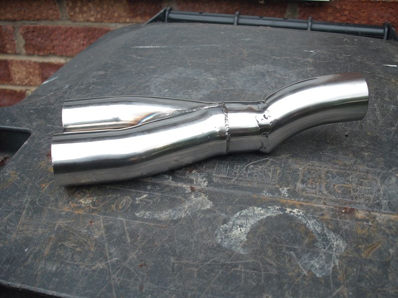

But it would be boring to leave it alone, so I'm playing with the original exhaust pipes. The silencer box has rotted out, and the pipes need to be re chromed.
Because of the way the original silencer fits around the rear shock, it's not simple to replace the can with something else. So I sourced a stainless steel Y piece off the bay, plus various stainless bends. After much hacking and filing I came up with this piece, which I got TIG welded locally.
Exhaust now doglegs around the rear shock, enabling a conventional silencer to be grafted on. Can in the photo is a Triumph Scrambler 900 oem pipe. I think many of these are taken off at the dealer and swapped for something fruitier. However, on my little engine it sounds quite nice.
It's a bit too long ! I have made up a hanger bracket out of stainless strip, not fitted this yet, or had a test ride. I did try fitting a stubby pit bike can, but it was much too loud.
A loud pipe on a slow bike is simply embarrassing ...

Got the grinder out yesterday, cut down the spare can, also trimmed off redundant heat shield brackets. Not fitted it yet, need to test ride the bike on the unmolested can, see how it runs.
I'm hoping that the circumcised can won't be radically loud, all the internal baffling is still in place, just a larger outlet.

Took it for a run today, went very well. Smooth, quieter than the pair of DS pattern pipes I'd fitted. Hasn't strangled it all, might actually go a little bit better, idles easily and revs to 10K through the gears.
Only downside is the heat. Burned my hand on the silencer can when I got back from my ride. I'd assumed that it would be double skinned and cool, like the OEM Hornet can, not hot enough to stick my skin to it. :eek
May be due the Triumph catalytic converter in the front section of the can. Job for the hole saw ....

A Speed Triple left hand can is on the way, that bike has the cat in the header pipes, rather than in the silencers.

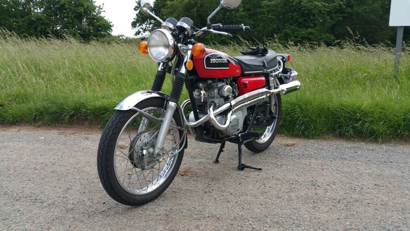

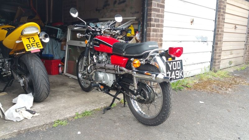

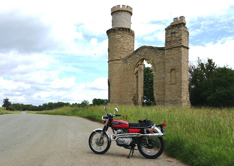

Here's a photo taken today:

I have a CB175 tank fitted in the photo above, original CL tank in the loft until recently.
With this nice weather we've been having, it seemed a good time to repaint the CL tank. Just done with paint and stuff from Halfords, apart from the ProXL two pack lacquer, which really is fantastic stuff.
https://www.youtube.com/watch?v=4U10Eb_j_5s
My first attempt at pin striping using masking tape, rather than cheating and using pinstripe tape, as I did on the CB tank.

I've said this before, but this ProXL lacquer is a real find, IMHO. Easy to get a brilliant finish, and it is very petrol resistant, despite a muppets review on Amazon. By comparison, Halfords 'fuel resistant' lacquer is useless, not fit for purpose.
Pinstriping. I just used a single strand of pin stripe masking tape. You can get fancier tapes, that come in multi parts, peel out the centre section to make masking a stripe easy. Wouldn't have worked for my paint scheme.
Or you could cheat, and use some stick on stripes, then maybe lacquer over the top. Plenty of blue Fords around with white racing stripes, look great IMHO, bet those are just stuck on.
For example, random image from the web:

175 is going well at the moment.
Out for a ride out on the A44 yesterday, came up behind a convoy of riders wearing orange tabards, on naked bikes, Bandits and the like. Riding at around 45-50 mph, holding cars up. What was that all about, some sort of DAS training ?
Anyway, I passed the lot of them around some twisties on my little 175, just like being 18 again !
And then I showed a bloke on a new Royal Enfield how to filter in town traffic, came home feeling very pleased with life. :lol

Here's my pair of twins. The one with the Colorado plate is just waiting for DVLA to return a new historic UK registration, it is insured on the frame number and passed its MOT last week. I plan to ride it around for the summer, then strip it in the autumn, to get the frame stripped and painted / powdercoated. I've already sorted the electrics and external mechanical bits like chain and control cables, repainted the red bits etc.
I ride the other CB175 regularly, but until I looked at this photo below I hadn't realised that the fork gaiters had split again. This is the third set, if you count the ones that were on the bike when I got it. Must try and source some better quality ones, or go naked, just fit dust seals same as CB200. ( This bike started life as a CL175 on / off roader )
