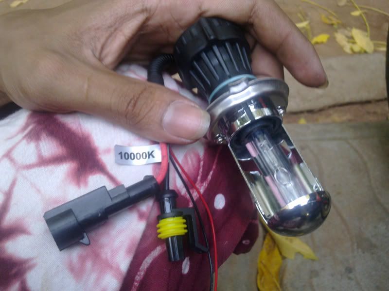

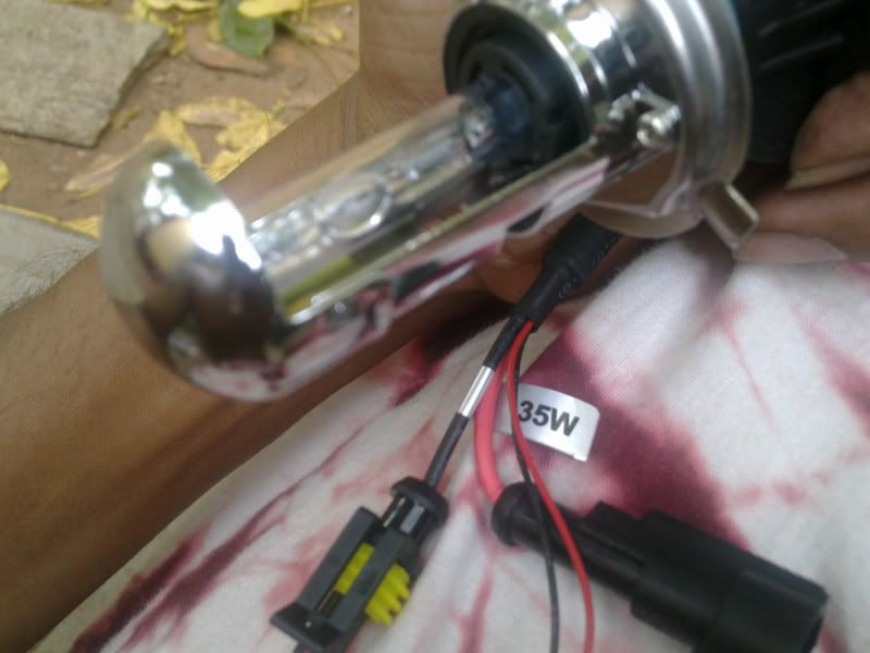

ok i bought a new bulb which has clear hi low beams, low beam doesn't blind other riders but hi does :evil . very happy with the new bulb because it's 10000K, Colour is little blue/purple than my old 8000k bulb even girls love it :o
Pics
35W
10,000K

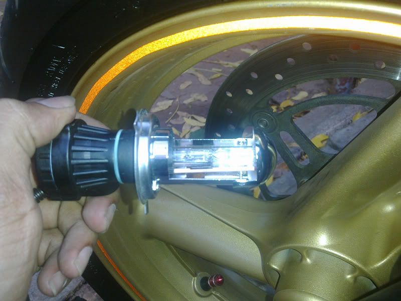

this is the bulb you need, with this cup, no spreading
Just like i have
