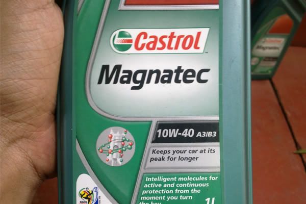

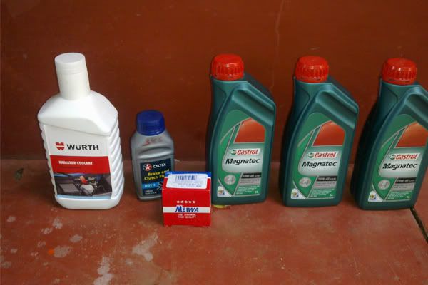

Here some of my pics i have taken during my Hornet oil change
Castrol Magetec, Wurth Coolant, Oil Filter and Break Fluids

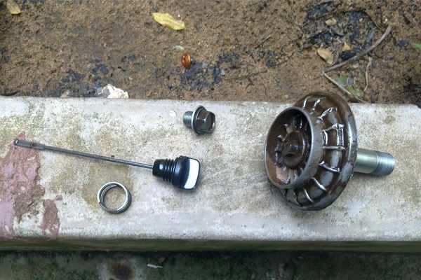

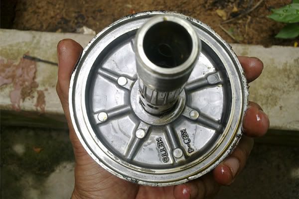

Dipstick, Oil Drain Bolt and Oil Filter Cover/Case?!

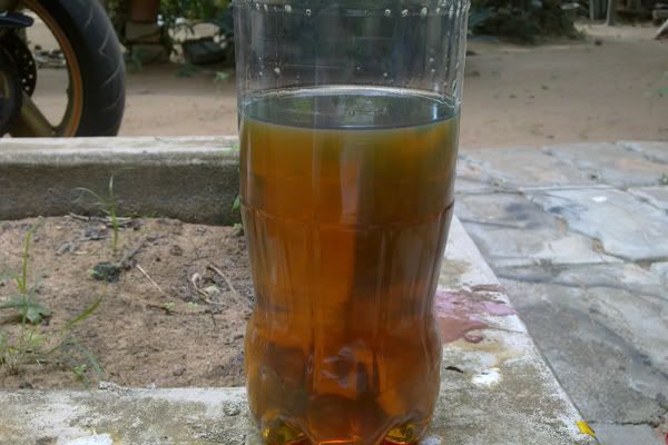

3000Kms Old Magnetec Oil

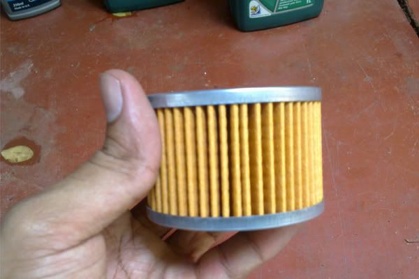

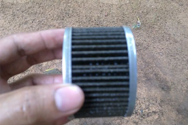

Oil Filter

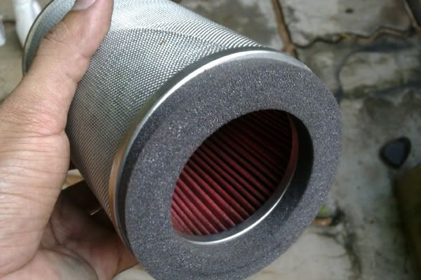

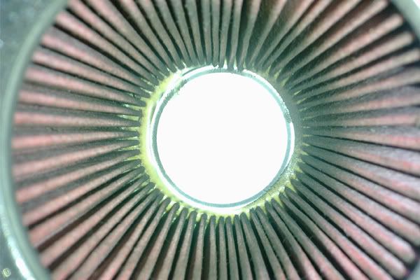

6000Kms Old Air Filter, Looks New so far(i cleaned it before putting it back)

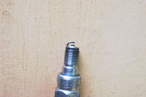

CR9EH-9 plugs, 3000Kms Old and Just Cleaned them myself

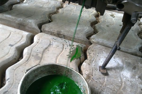

Draining Coolant
New Oil Filter

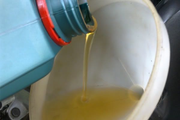

New Magnetec

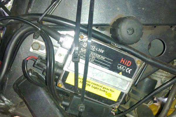

H.I.D Kit

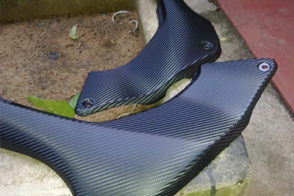

Side Panels

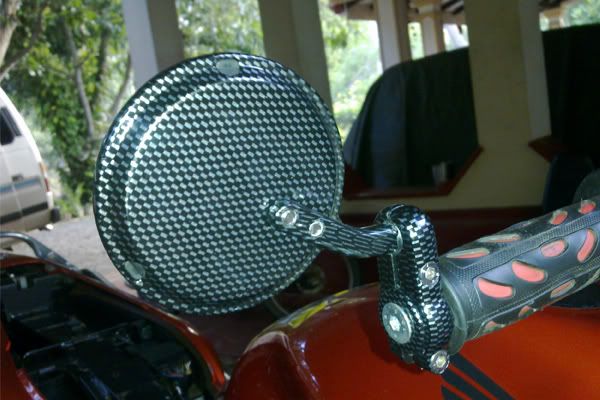

Bar End Mirrors
After my service, Bike runs really smooth and i think Cleaned-Plugs and Air Filter have given her a new Life :k

 Post Posted: Wed Jul 20, 2011 4:54 am
Hey dude... :halt
you got one interested visitor lol!

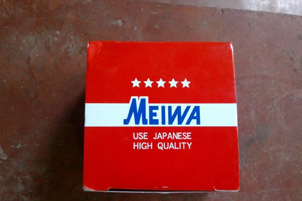

What brand is that oil filter and where did you buy it from?
AMW has got the Castrol Semi Syn Oil... if you want it lemme know... The semi synthetic oil can be changed every 5000Kms.... its much better i would say.
 Post Posted: Wed Jul 20, 2011 5:25 am

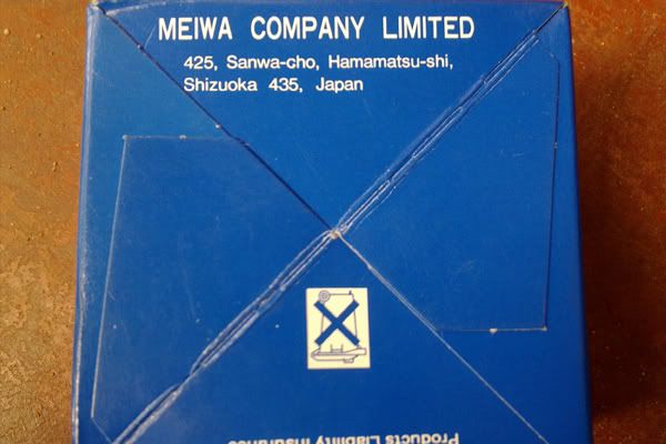

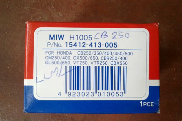

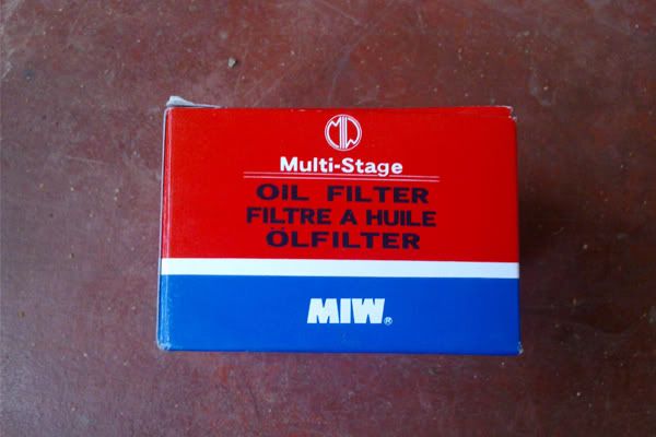

i can get you a close look
it says made in Japan. however i change oil filter in every Oil change
Cost: Rs. 680 :D

holy crap this thing is Semi-Synthetic :love :love
but it's NOT on the bottle?! i found that A3/B3 and A3/B4 both are Semi Synthetic B4 thing is the new Product of Magnatec :k

You do realise that aftermarket HID kits are actually illegal and quite possibly an MOT failure?

HID kits are illegal? only thing illegal "in our country" is Motorbikes' Engine Capacity should be 250cc or "less"
you cannot ride Bikes with more that 250cc Power(i know it sounds stupid) but that the law here :rollin

Ahaaaa... :D i sorta knew dat but wsnt too sure coz u said u paid 800LKR for a Litre i had a feeling u were using a part syn or Fully Syn.
SO the good news now is that you get to change oil every 5000 KMs :clap
Dude also read this...
http://magnatec.castrol.com/en/faqs/
read point 15 at the Bottom. Magantec is not recommended for bikes... Use the special Motorcycle oil.. has to be the Castrol Power i guess!
 Post Posted: Sat Jul 23, 2011 8:08 pm
According to what ive just read the only oils from Castrol that will work well are:
Castrol Power1 GPS - Semi Syn oil change every 5000 Kms
Or
Castrol Activ 4T - Mineral change every 2000 Kms.
Guys Use only Motorcycle Oil.
@ Kane - The pic uve uploaded above says Car engine on it and you shouldnt be using it dude!
cheers!! :angel

i honestly cant believe that you guys have been using CAR oil for your bikes,
im using castrol gps it costs around $60 nz for 4 litres, you should not use car oil in bikes

frankly i didn't read their FAQ :lol yeah it looks car oil but so far i didn't get any problem, no clutch slipping, no heating problems....
good thing is when i used a BEST motorbike recommended(which was NOT a car oil) oil for my hornet that sh** almost killed my bike
thanks for the tip, i'll check on Castrol Power1 :)
should i plush my engine oil with new/motobike recommended oil? i know i need a new Filter :Bang

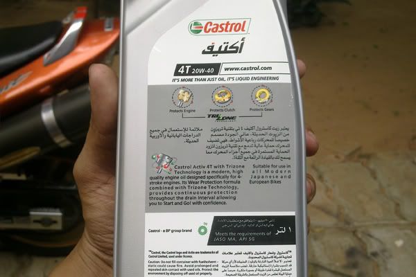

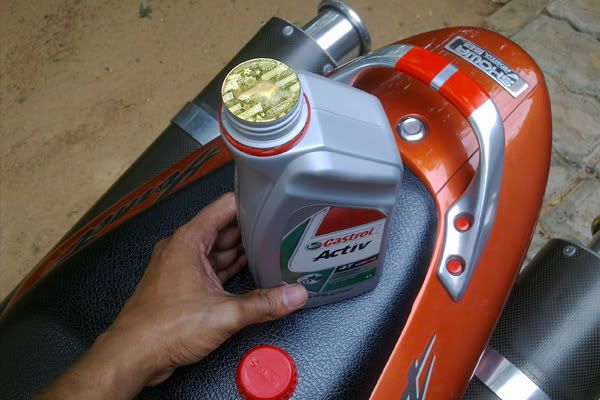

Going to Flush Old Magnatec with Castrol Activ 4T 20w40 :)

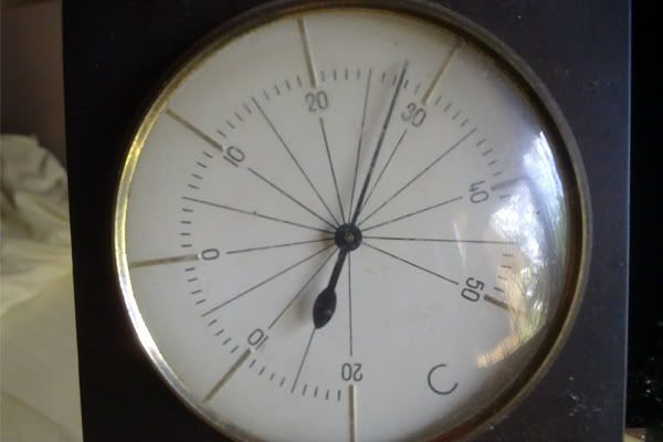

Temperature here
Activ 4T
Colour/Look of New Castrol Activ 4T 20w40 in a Clear Bottle

Dude lemme know how it rides with the Castrol Activ 4t thanks...

After 3000+ Kms with Magnatec 10w40
i felt gear shifting was smooth, speed and was no vibration
but.. this 20w40 gives me.. very hard gear shifting (couldn't check my speed and how it feels around 100+ kmph) but this oil gives Vibration.. and Noisy Engine
it is thick!!!
10w40 was Really Good and Smooth! :)
Misunderstanding u need to do some research on Oil Grades, types and Viscosity.... Mineral Oil is Thinner !

Today I went for the first longer tour after that latest oil change. I have no oil temperature gauge, but I can see the coolant temperature on my Koso dash. It was hovering around 82 degrees Celsius when riding (ambient temperature was about 33 today). When idling for a while it went up to max. 86 or so... I think that's rather normal.
Believe it or not, until 2003 the max. legal displacement for motorbikes in Taiwan was 150cc!
That limit was removed when Taiwan became member of the WTO.
Here HID-kits are illegal too. But noone really cares, at least on smaller bikes and scooters. Only big bikes (550cc and up) need to have something like an annual MOT check.

 Post Posted: Thu Aug 04, 2011 3:06 pm
10w50 Fully Synthetic? why not 10w40?
what is the brand of your Oil filter?
10W40 and 10W50 should be of similar viscosity, but 10W50 is more high-temperature resistant. It is labeled as "racing" oil.
I ordered the oil filter on Yahoo auction Taiwan from a company called REF Motorbike Experts. It's a very basic paper thingy. Here's the link... hope you can access it.
 Post Posted: Tue Aug 09, 2011 2:55 am
your filter is more like mine/Meiwa, does it mean only K&N filters come with Red form?! 8o

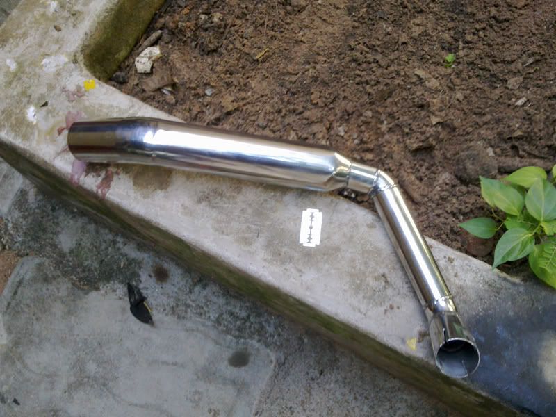

i have bought 2 Levers for my Hornet it's Black/Chrome and got my single side Exhaust Bend done. there'll be Single Asahina Soon :Lick
shall post Pics Soon

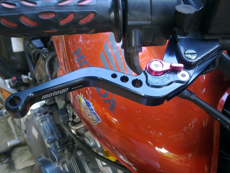

 Post Posted: Fri Aug 12, 2011 3:37 am

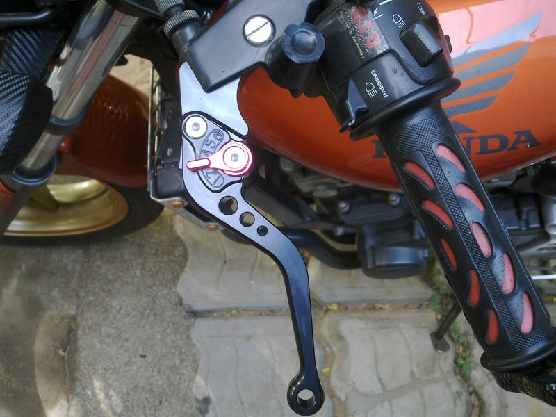

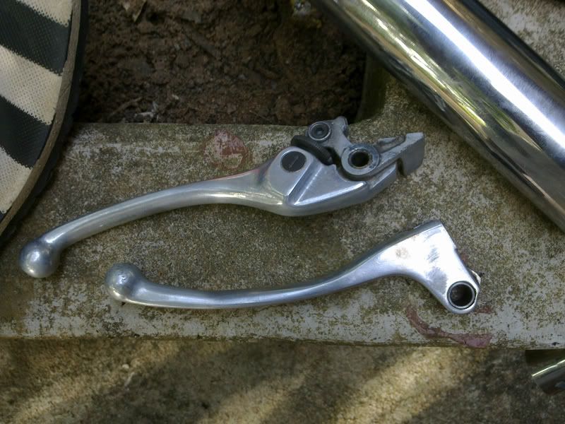

Stock Levers

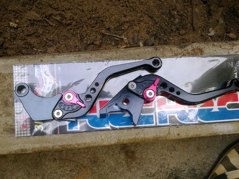

New Black Chrome Levers + 3M HRC Stickers
After installing Break Lever
and Clutch Lever

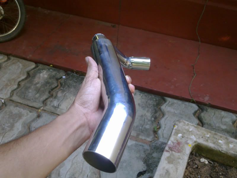

Single Exhaust(Right-hand Side) Bend
Update: Getting Power1 Oil and a Filter Today. i'll post pics :)

Update:
Castrol Power1 now inside my babe
Gear change is smooth now just like i had magnatec in it :)

@ Thenura i told you last night aswell.
Flush with Activ.... Im sure your bike will accept Castrol,i can bet you on that one.
Wen your done with the flushing lemme know if you need help ill hook you up with the Power1 600lkr Each!
