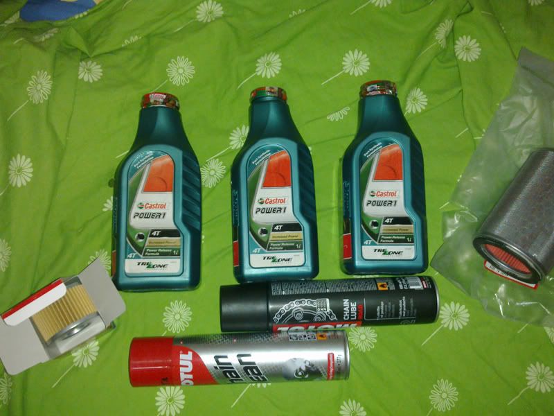

 Post Posted: Sun Dec 25, 2011 3:04 am
Service Done
Kilometers on the Meter - 20,751Kms
Oil Changed - Castrol Power1 4T 10w/40
Oil Filter Changed - MEIWA Japan
Air Filter Changed - Honda genuine HMKL8-LF
Chain Cleaned and Lubed
Other
Bought Motul Chain Clean and Motul Chain Lube/Road
Pic

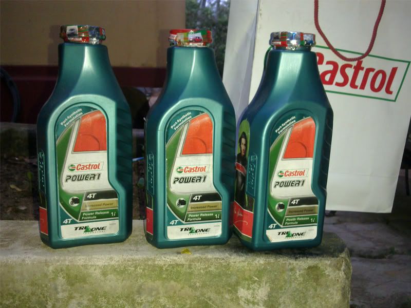

 Post Posted: Sun Dec 25, 2011 11:28 am
Nope last one also same as this Power1 4T = GPS, Part Synthetic :Lick
right here
Update:
Castrol Power1 now inside my babe
Gear change is smooth now just like i had magnatec in it :)
