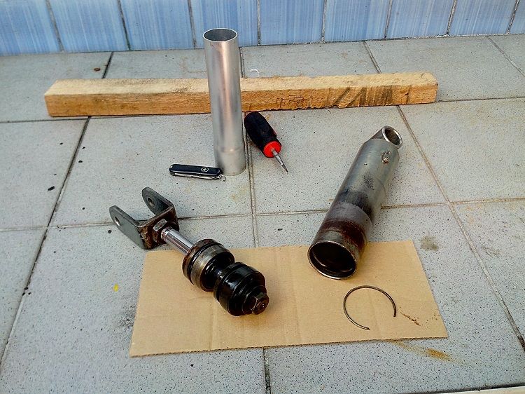

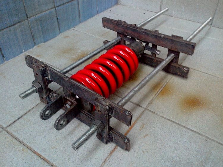

finally... I opened up the rear mono shock... oil seals still in good shape filled er up with motorex fork oil 10w.. assembled it back... so far no leaks...
but the spring is not yet installed back on the damper... I still need to diy a spring compressor... hopefully by next week or before december ends...
for you to remove the rear mono shock of our hornet, you need an ABBA stand, diy is possible, and then you also need a spring compressor or hire a machine mech to do that for you...
I still can't believe that the shock ran out of oil... there's no sign of leaks... maybe once you installed back the shock and ride like 1000miles then leaks will start to come out... not sure... I'll check that out in the future...
here is the video after adding motorex fork oil

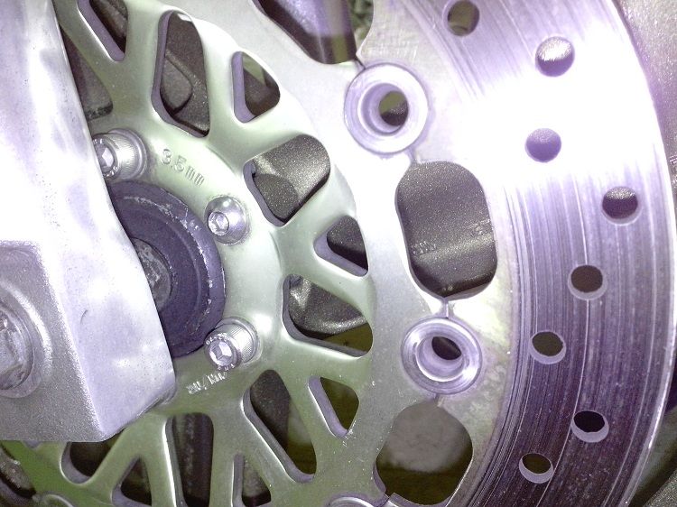

deep scratch
now removed, used 80, 100, 200, 400, 600, 800, 1200, 1500 and 2000 grit, then autosol metal polisher, i dont have a buffing machine yet... just buff em up using my hands :Bang

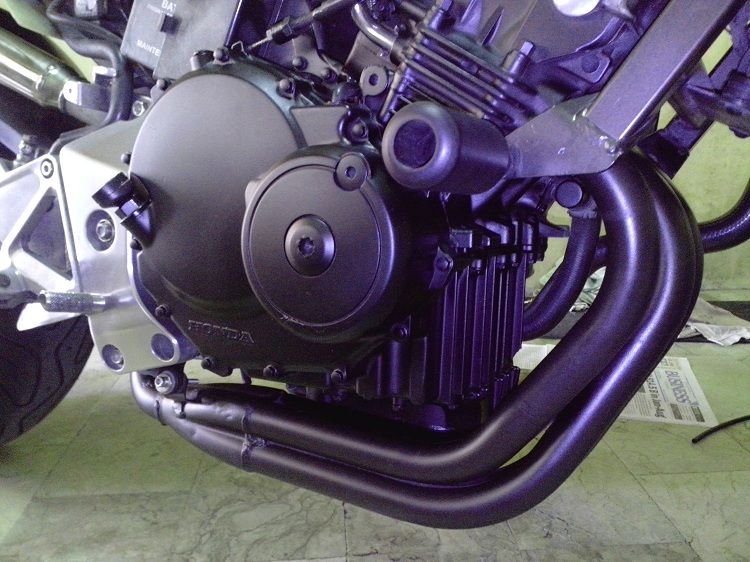

engine and headers repaint once again... lots of pebbles ruined my paint..
which one is much better the flat head or the head type allen stainless bolts?

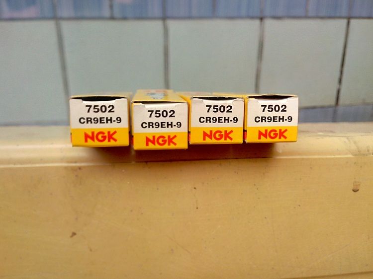

bought new plugs NGK CR9EH-9, this one is designed for countries with high weather temp... :ahhdiddums

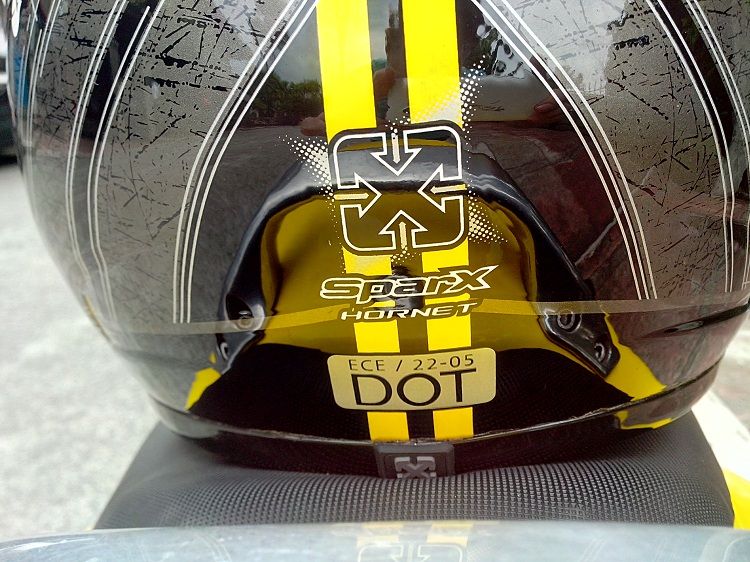

forgot to post my hornet helmet by sparx
bought it like 2 years ago
I don't really use this helmet like all the time, I only use it for night ride... it is not a dual visor
the hornet 2 helmet is still on sale ...

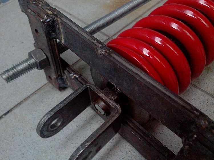

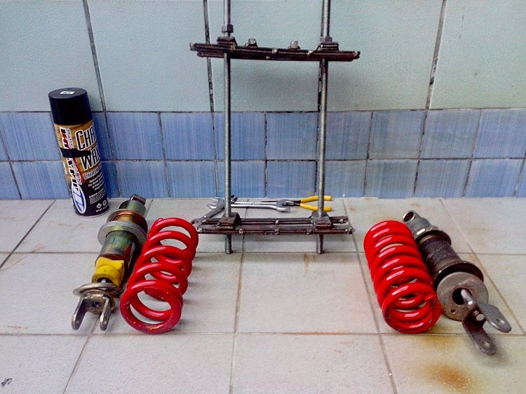

finally i found some time...
hired a welder to custom a spring compressor for me
left side is the z200 shock at the right is the OEM honda hornet mono shock
d.i.y spring compressor gave me plenty of space to tighten the bolt

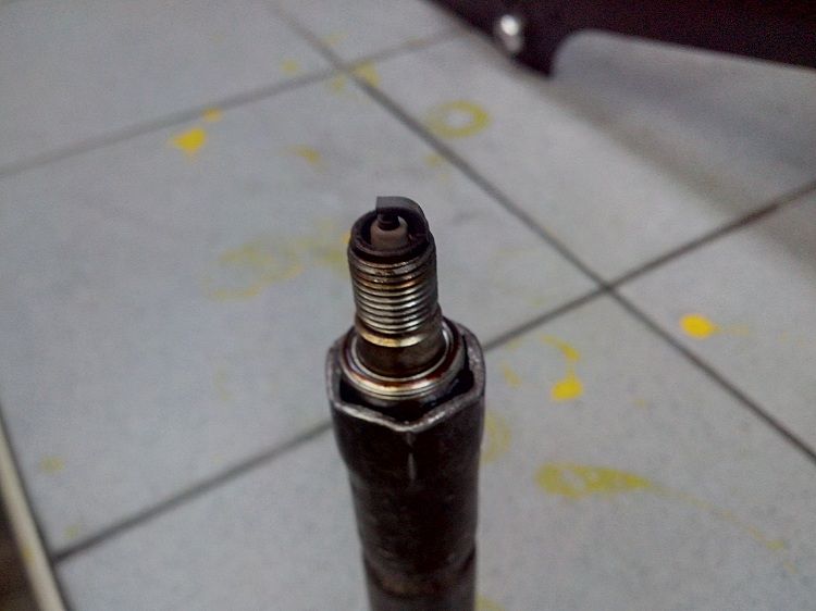

spark plug now has much better color - brownish

was able to remove the metal plate holding the O-rings, O-rings seemed to be in good shape, but the weird looking shape of O-ring around the main petcock may need to be replaced with epoxy gasket maker fuel resistant..
