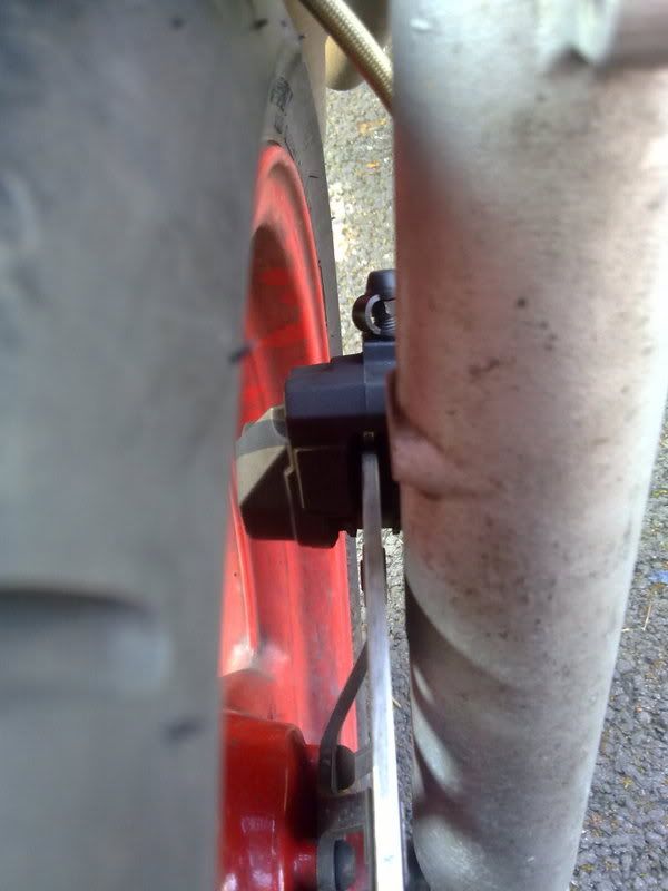

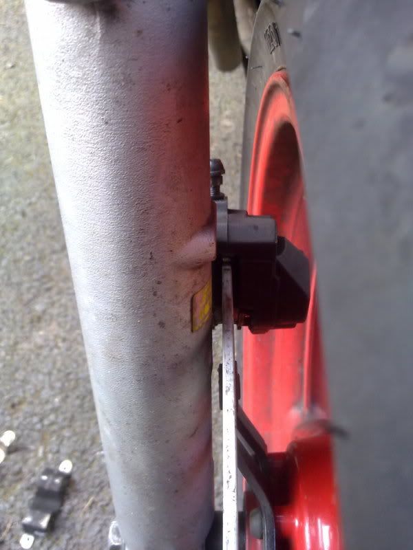

So anyway, on with the pictures, just to show you what they look like:

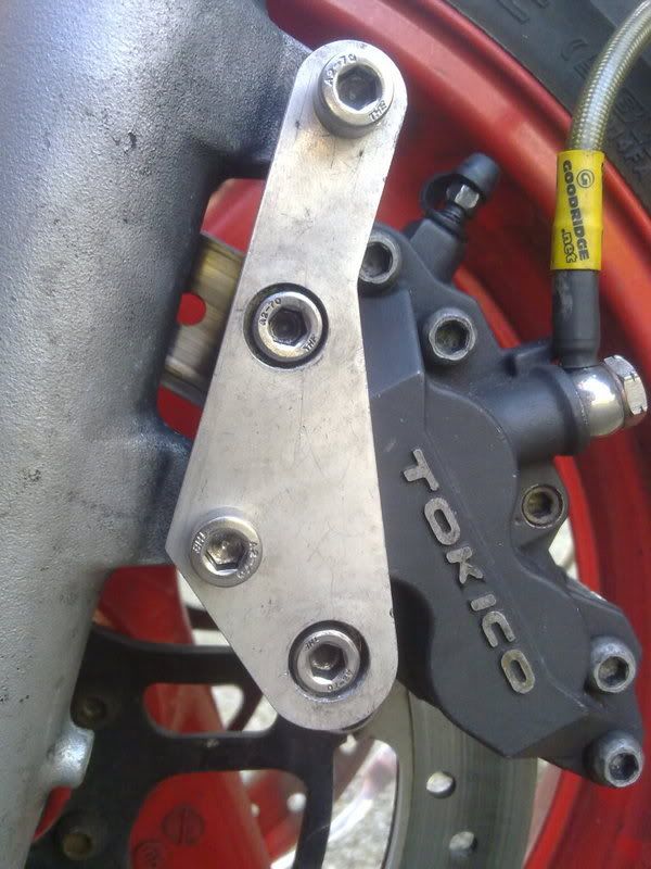

Right hand bracket on bike:

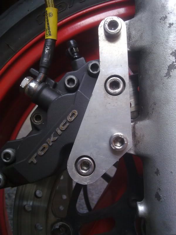

Left hand bracket on bike:

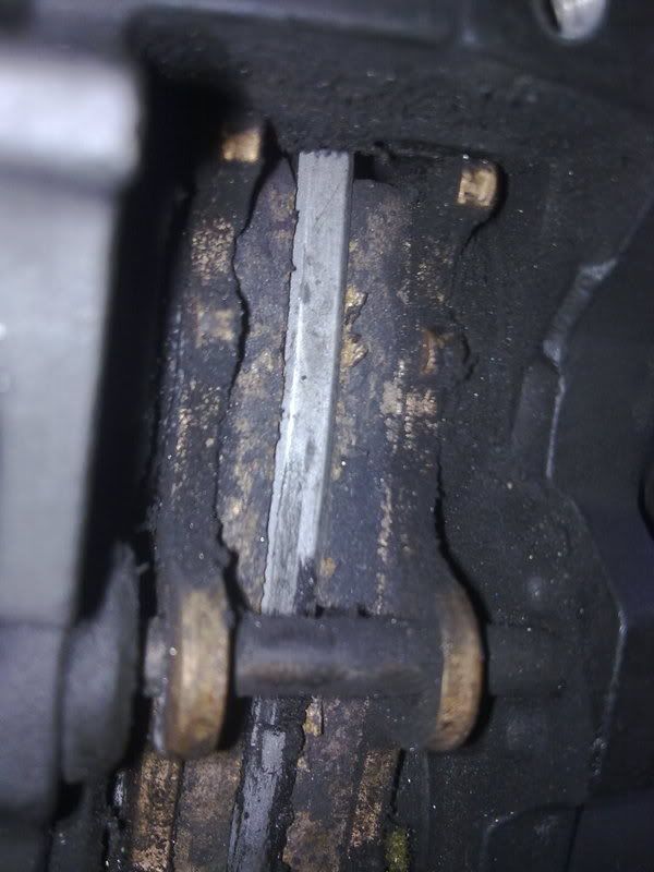

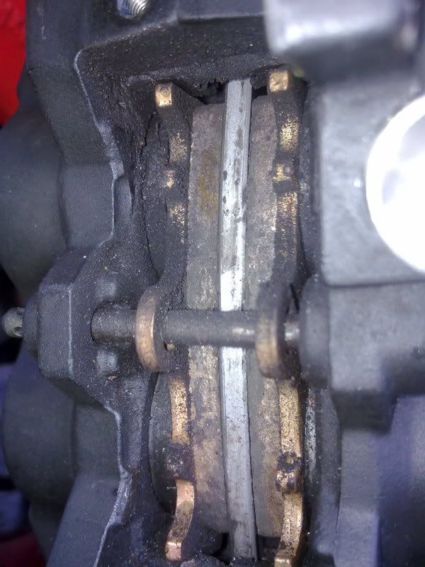

The next two photos were taken of the calipers on the bike, with the pad cover things removed, to show that the brackets line the calipers up exactly where they need to be with the discs:
No comments on the dirt please :angel
These two show that the calipers are spaced out to exactly where they need to be in relation to the disc:
There is minimal drag with them on, and the bike can be pushed around just as easily as with the standard hornet calipers

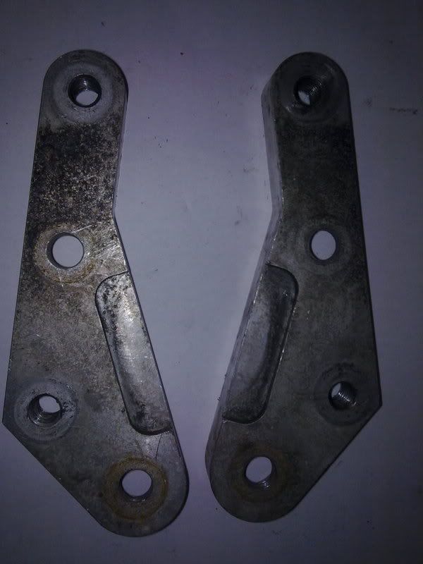

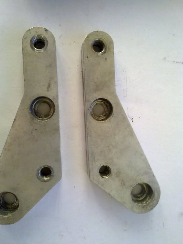

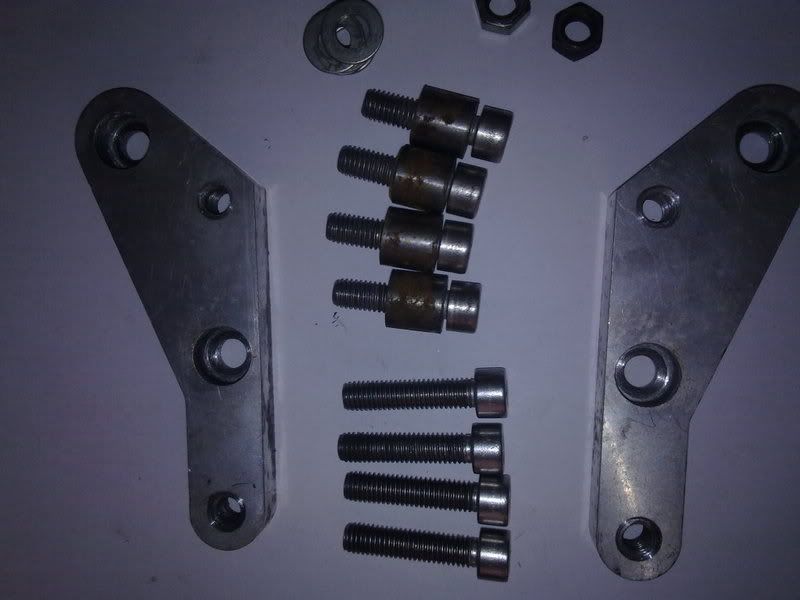

What the brackets look like off the bike:
And this final picture is of what you would recieve were you to buy a set of these brackets, posted to your door: (except your spacers would be made out of CNC, so wouldn't go rusty, and the bolts and nuts would all be new, rather ones I had in a big bag)
-Brackets
-Stainless bolts needed to mout the brackets to the forks, as well as the nyloc bolts needed
-Stainless bolts needed to mount the calipers to the brackets, and the custom length spacers required
-And all the washers needed
