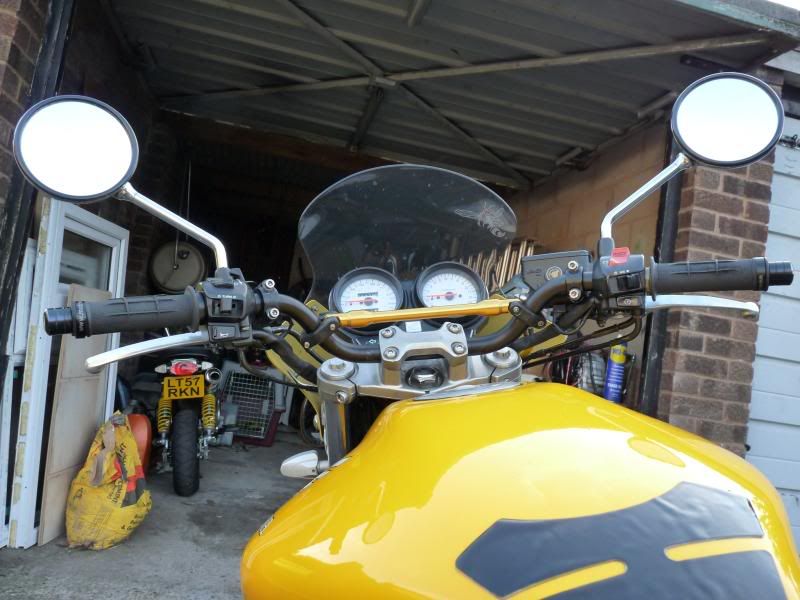

Hi all,
Just wondering if these are stock bars. I thought stock were shiny silver. Any insight as to what these are If not stock?

Look like low Renthals - 14mm bore as opposed to 17mm bore. OEM are chrome and are a higher/narrower profile and are steel, whereas the Rental are aluminum.

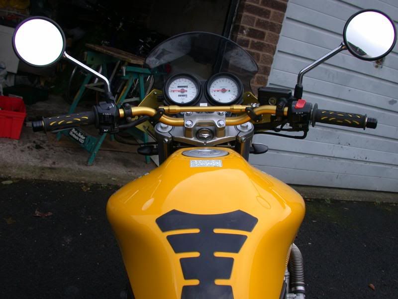

Renthal Lows
Renthal Ultralows

Excellent comparison. I will definitely pick up some ultra lows. Also quite temped with that yellow paint... 8o
