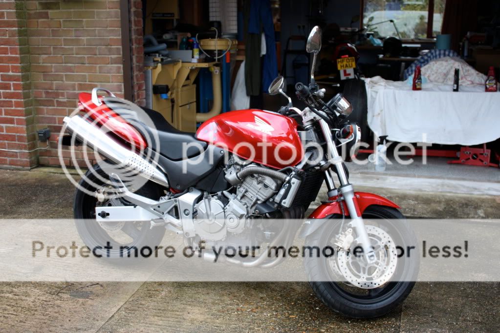

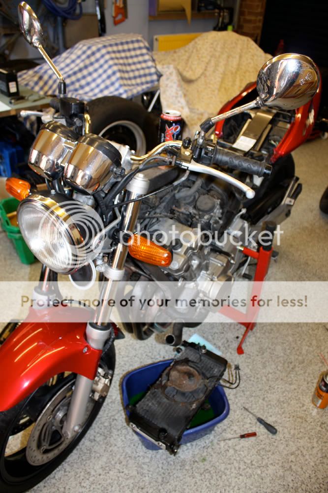

If you've seen the 'Bought myself a Hornet' thread, you'll know i've got a 1999 Hornet 600 in Candy Red (Not Italian Red for some reason? Whatever i like the colour :P) and people said it looked pretty good. And yeah i guess it was pretty good, but not good enough for me. Seeing how i have 4 months until i can ride it, i've decided to completely strip the bike down and restore and improve it.
How i bought the bike
Tank off

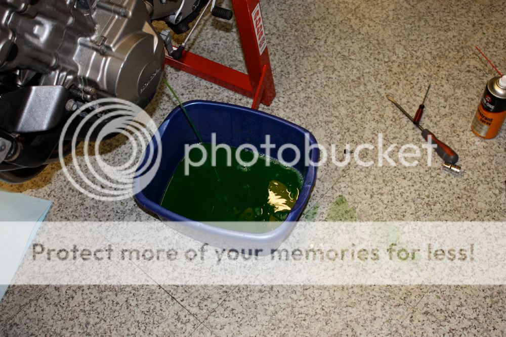

Draining Coolant
Radiator Off
Rear Fairing and Exhaust Off

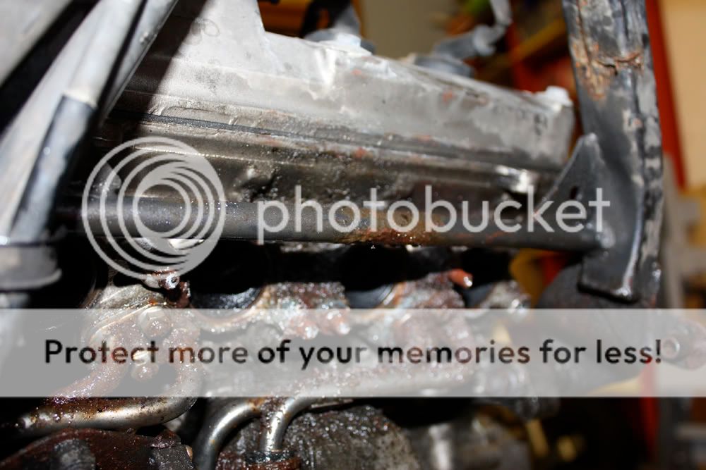

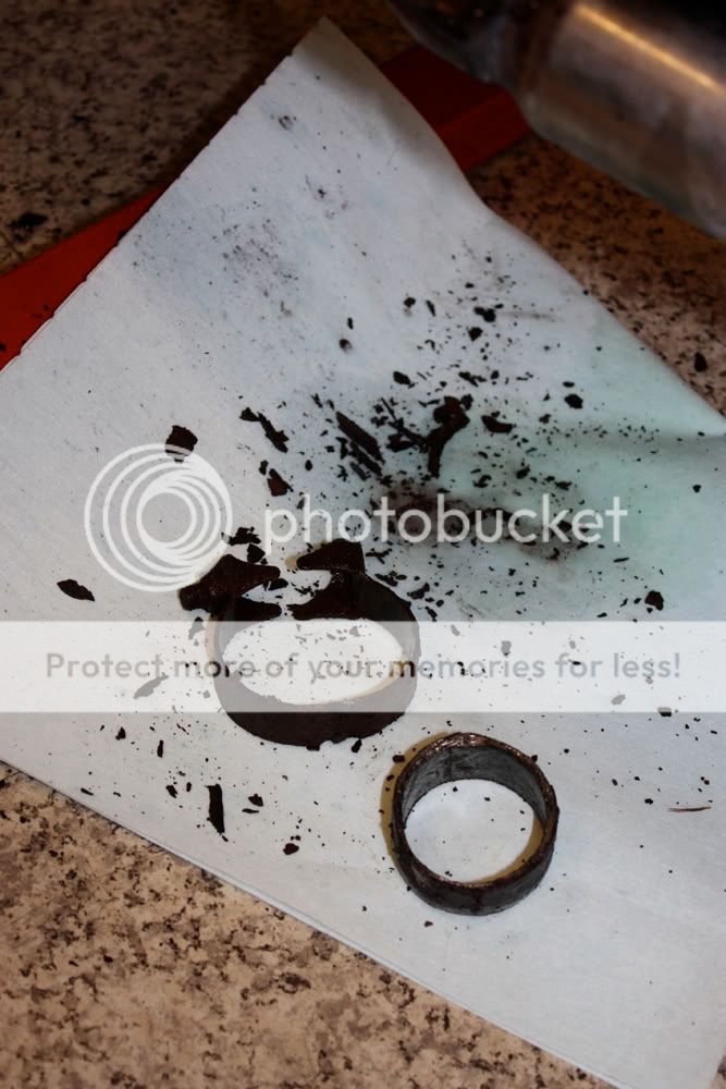

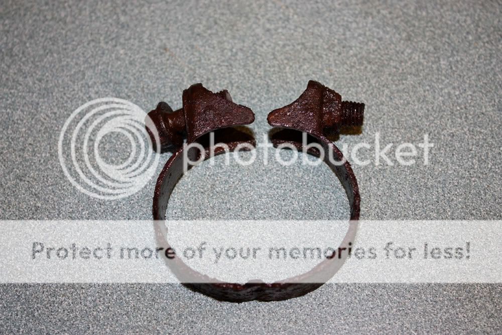

Destroyed Link Clip
Poor thing had corroded to death
A challenge

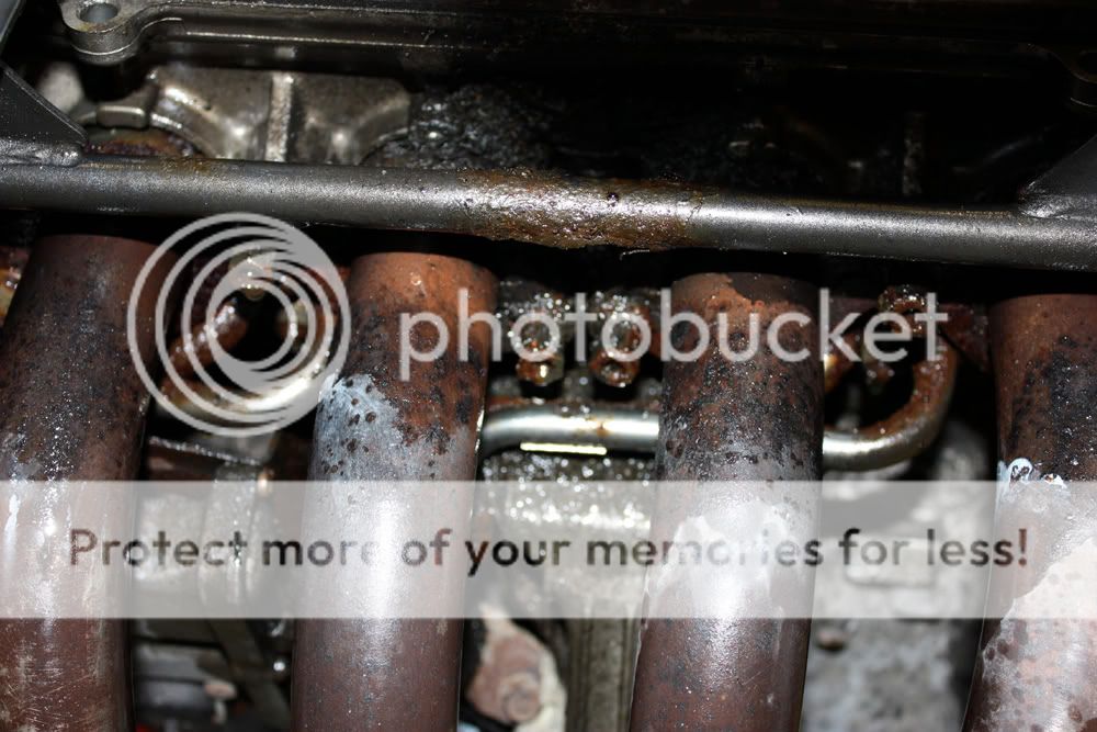

Covered in penetrating fluid

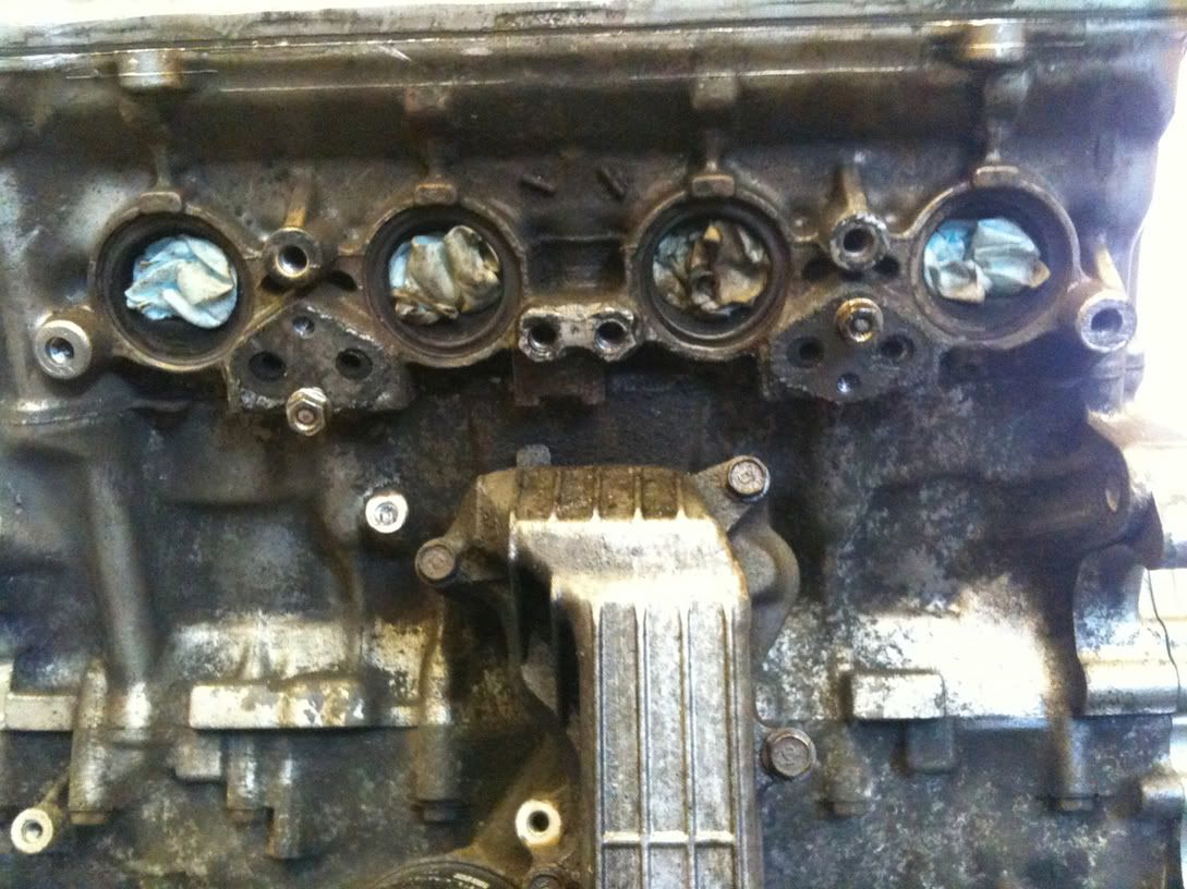

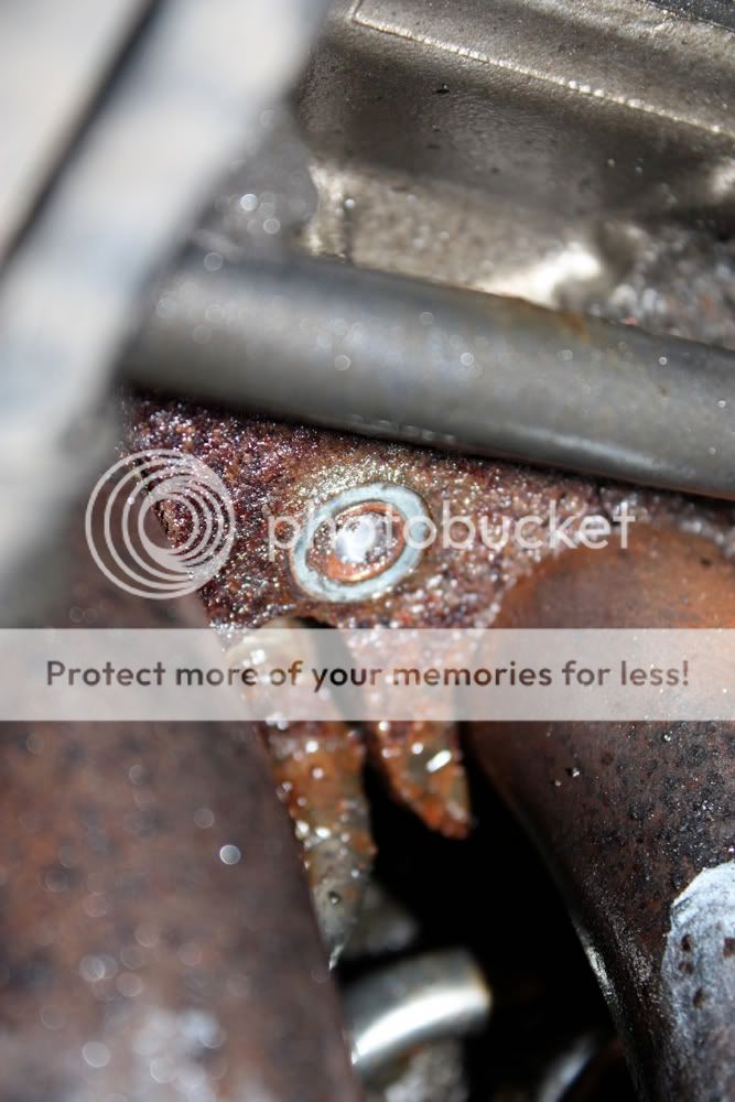

Failure! All but 2 snapped in the end

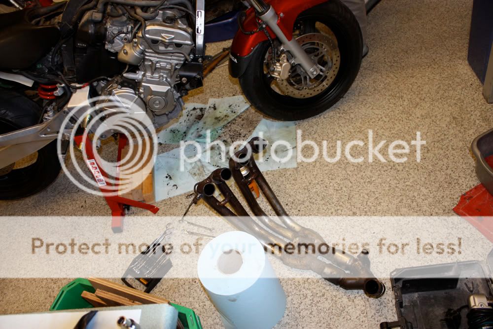

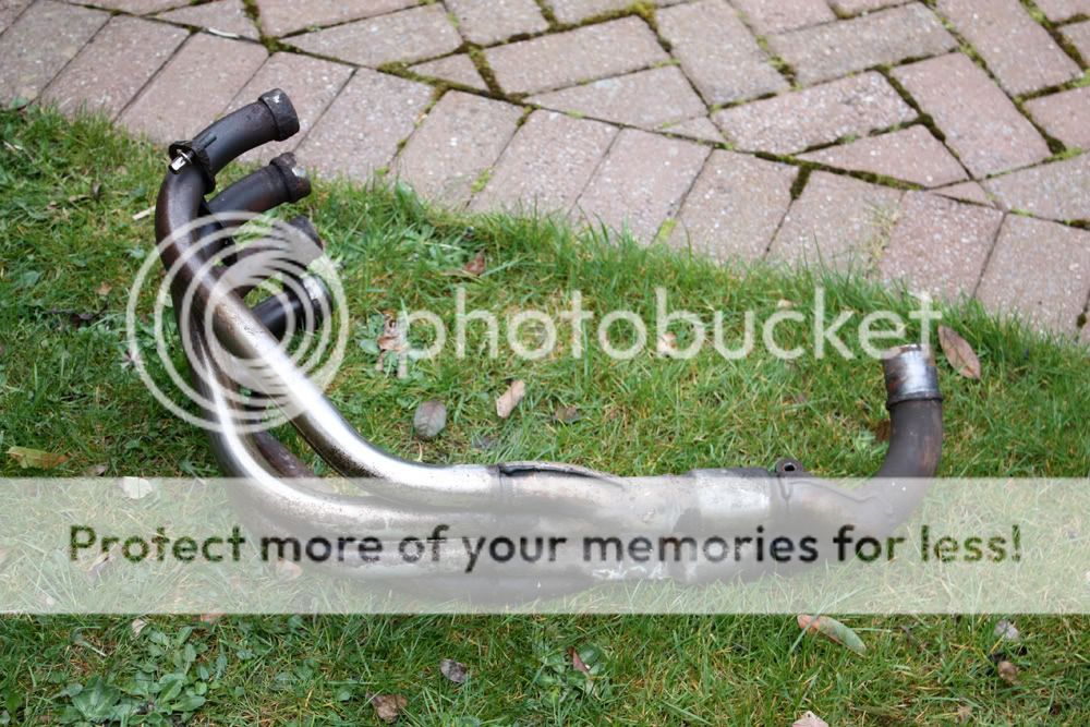

After about 40 minutes of knocking and whacking the Downpipes finally came free, they were just surrounded by muck and corrosion
The aftermath - Must get those studs out...

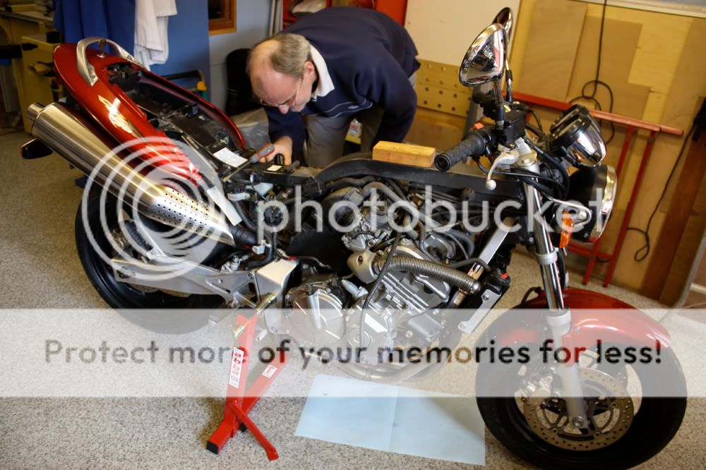

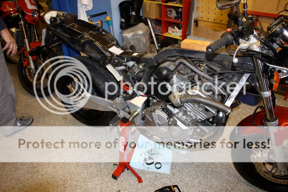

How the bike is basically now

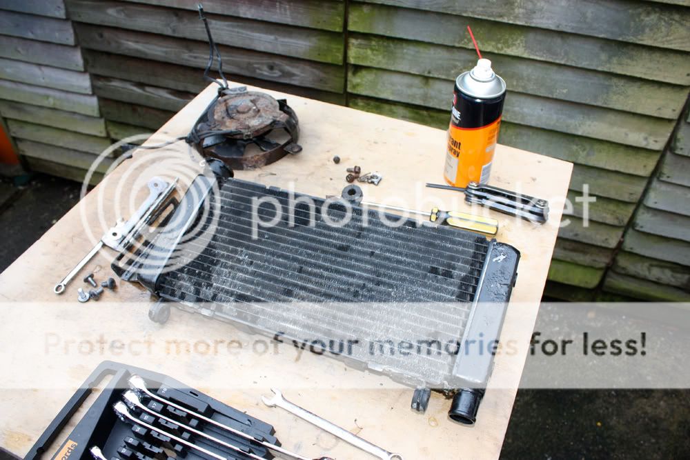

Radiators fairly good

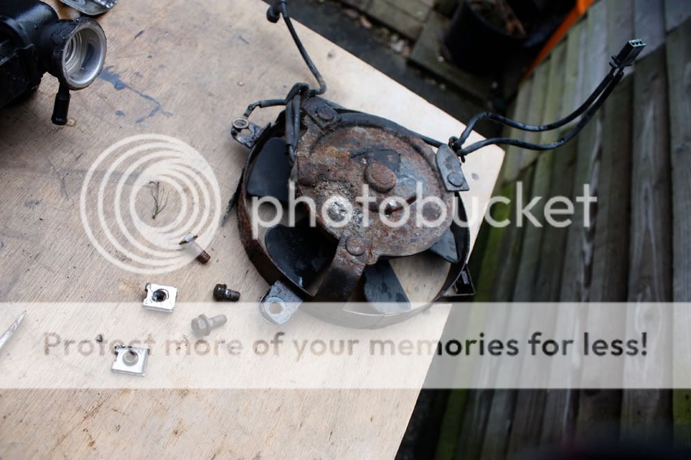

The fan isn't

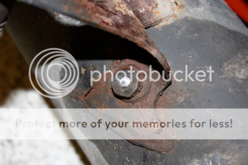

Snapped the bolt taking the heatguard off the can :/
Really mucky downpipes, they shall be polished!

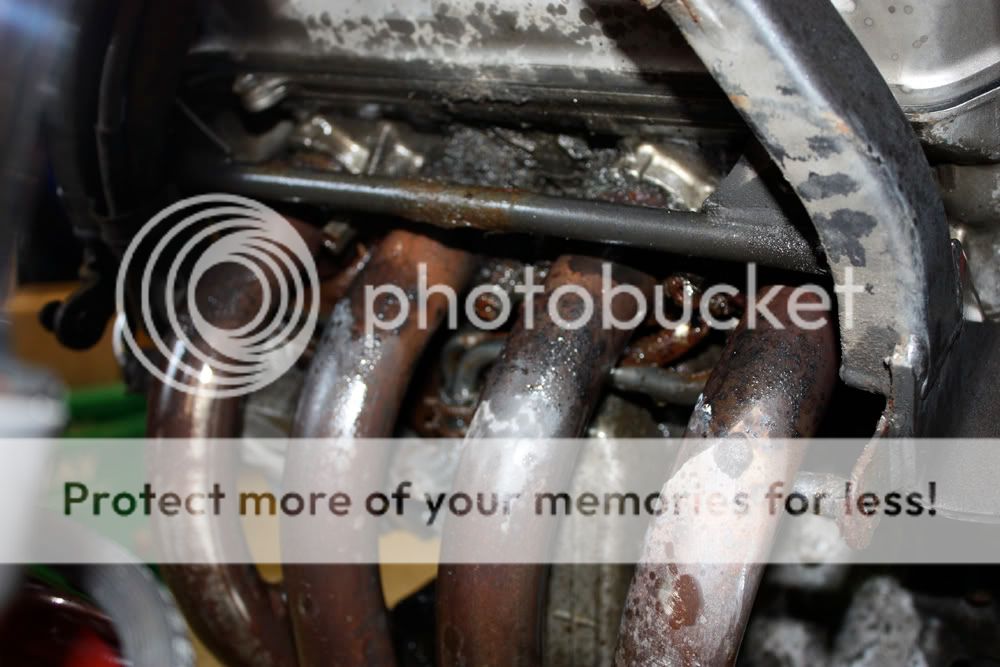

Fairly good nick other than the Manifold plates, they're completely corroded and bent from removing them
That took us about 4 hours to do, washed out the Radiator, cleaned a lot of muck off the engine.
I would make a to do list, but it would list basically everything imaginable to the bike, so you can imagine it in your head :P
Cost so far - £1650 - Bike, Abba Stand (God send, easily recommend one)

Drained the engine oil (Pic basically unrelated)

I had a stud break while removing my downpipes (to remove the PAIR valve) - I ended up heating the stud and then borrowing a stud extractor to s-l-o-w-l-y remove it.
A week of penetrating oil applied daily did nothing to the broken stud. 4 studs came out fairly easily (with care), 1 would not let go of the nut, so it came off with the pipes and was introduced to the angle grinder.
New studs and gaskets ordered from Dobles.

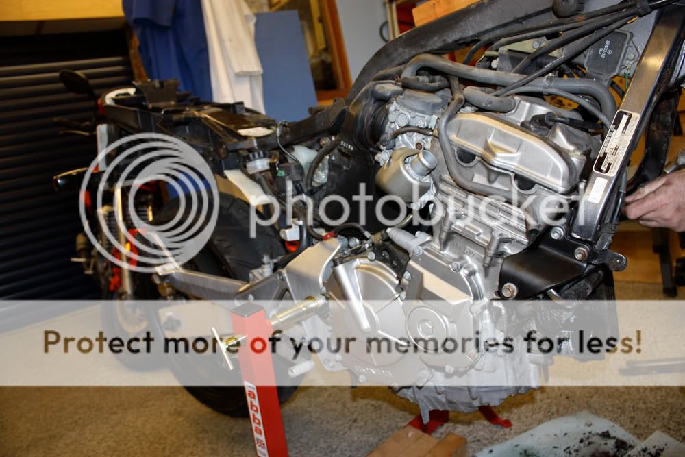

This happened... after a lot of shouting...
There she is

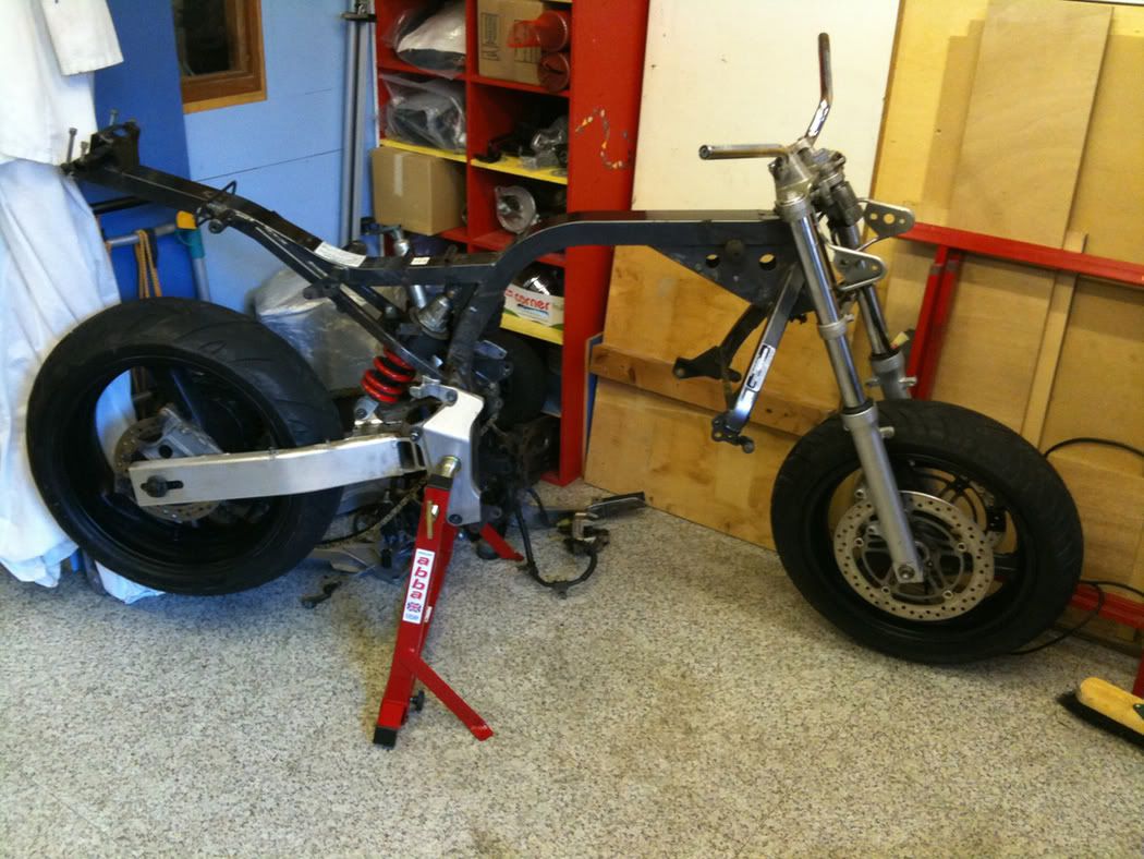

Got out a bit again, stripped it down to just the rolling frame now, only 1 quick iPhone pic for ya

Picked the engine back up from my guy, he got them all out, £30 in his pocket for beers, job done. Also knows a guy who will do blasting and powdercoating on the side, he paid him £150 for wheels, frame and a few bits, which seems pretty good, just waiting to see if he can get us in contact.
Another quick iPhone pic, loving the photobucket app!
