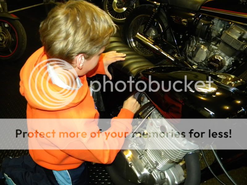

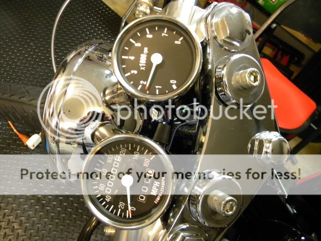

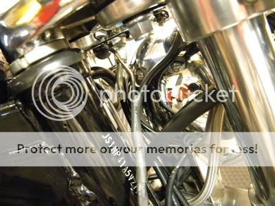

OK, RYCA fans, I got back into the shop this weekend. Spent some time yesterday afternoon wiring up the tach and speedo--it involved cutting, splicing, soldering, and heat-shrink wrapping the wires--finally, the wires were connected to a power source and the coil:
The tach works!! :) :) :)

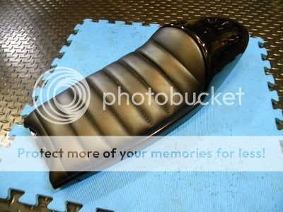

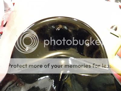

Today, I spent some time preparing the seat to be mounted to the bike--first order of business was to grind the seat tubes down (again!) in small increments so that the metal seat pan sat level (tedious stuff!)
Here is the end result:

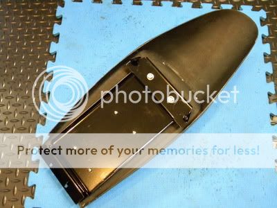

Here is the fiberglass seat being prepared to have the upholstery pan mounted to it:
Here is a shot of the fiberglass seat and upholstery pan prior to mounting to the metal seat pan:
Finally, here is a shot of my baby with the seat installed: :love :love :love :love :love

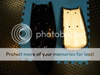

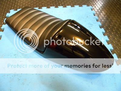

Here are some pics I meant to post up yesterday--these show the upholstery pan, fiberglass seat, and metal seat pan connected as one unit prior to install:

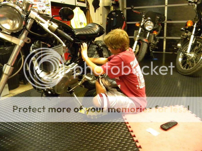

Here is a pic from today of the chief assistant, who is enjoying the honor of being the first one to plant a backside on the new seat:

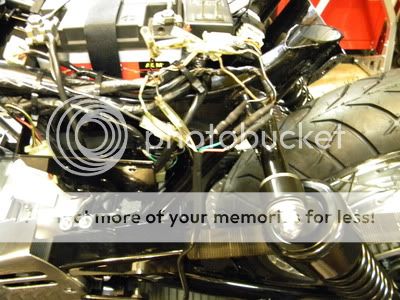

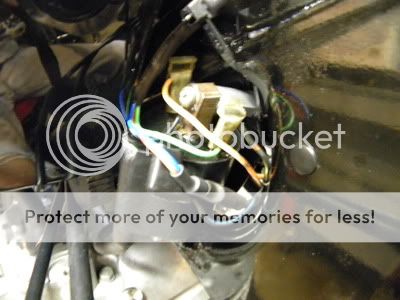

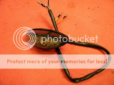

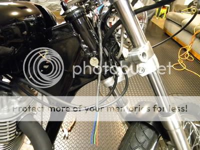

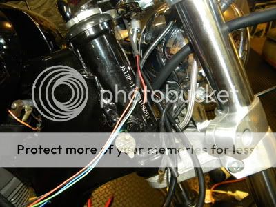

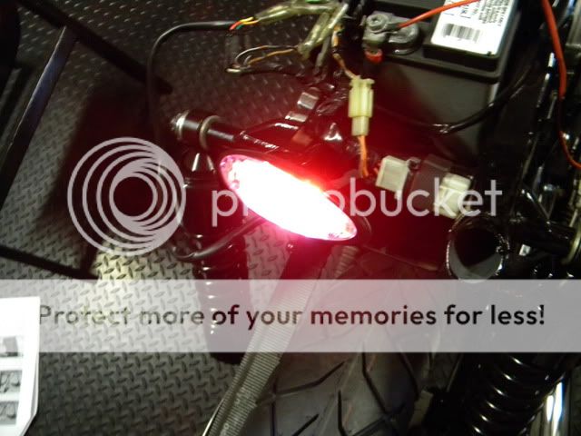

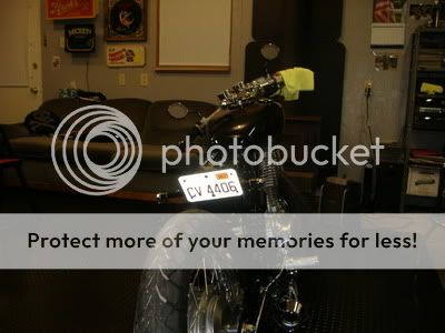

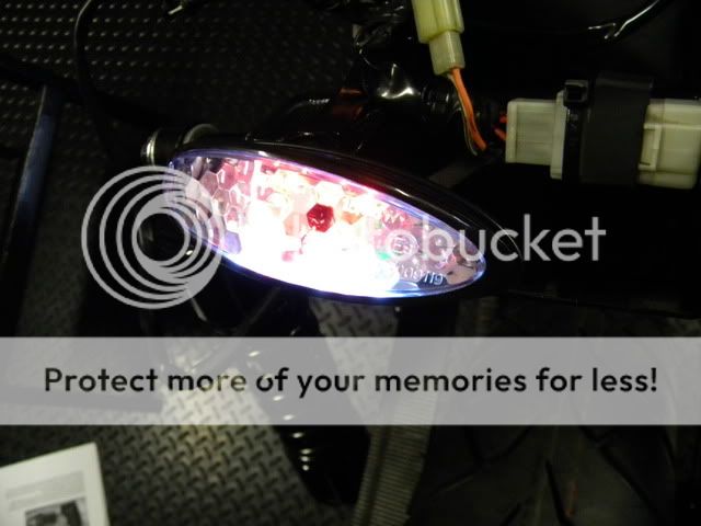

We also spent a little time today wiring up the tail light/brake light. Here is the combination LED tail light/brake light/integrated turn signals prior to wiring up:
The wiring process:
Tail light works!
Brake light works also!
I will try to take some video and figure out how to post that up--she sounds awesome!

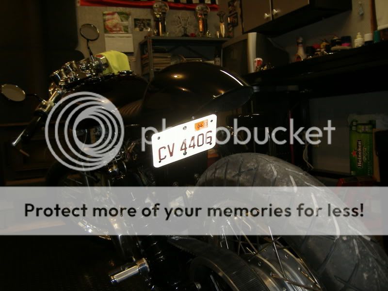

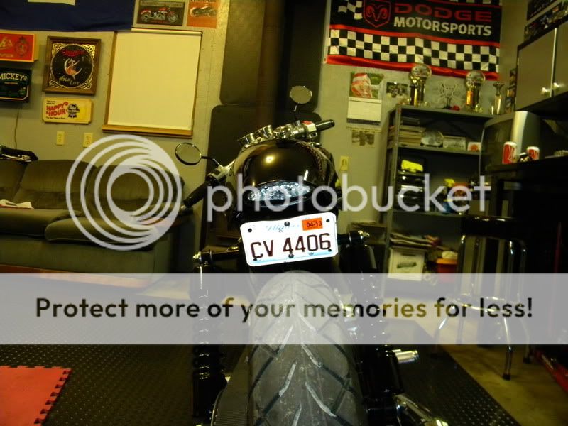

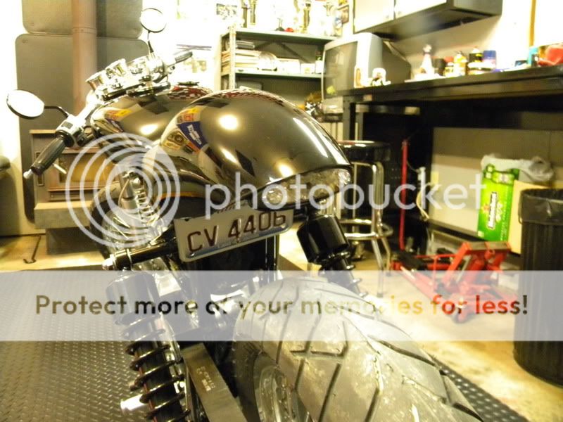

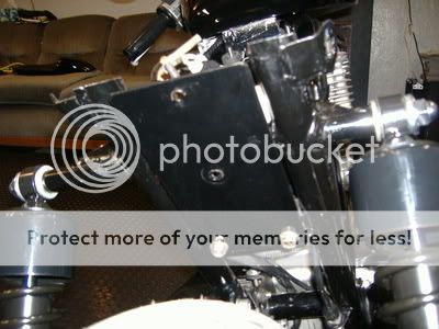

Lots of family/work commitments keeping us out of the shop, but we did manage to get the license plate attached over the weekend. The bracket for the plate that came with the kit didn't leave a lot of clearance over the rear tire. I researched other options and finally settled on tucking the plate up under the seat a little bit. I actually liked orienting the plate vertically in the tucked position better than horizontally, but since that position is illegal in Illinois, I opted for tucking it horizontally so as not to draw too much attention from John Law.
Back of battery box drilled and ready to mount plate:
Plate mounted:
View from rear with seat pan re-mounted:

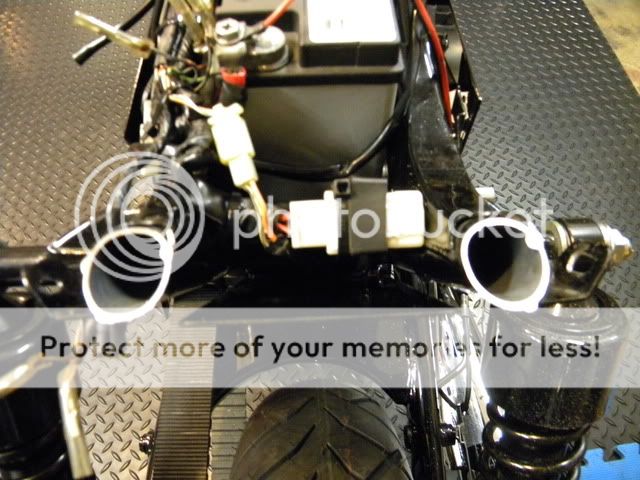

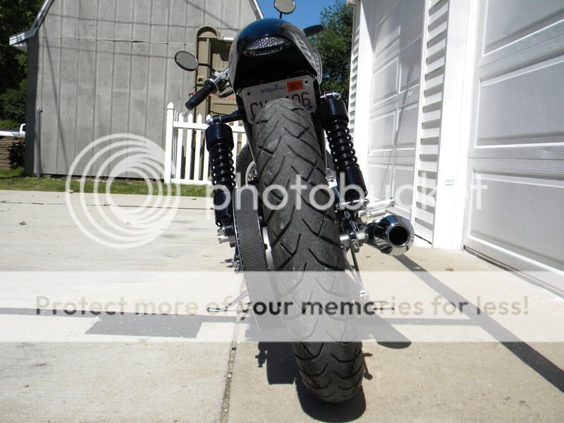

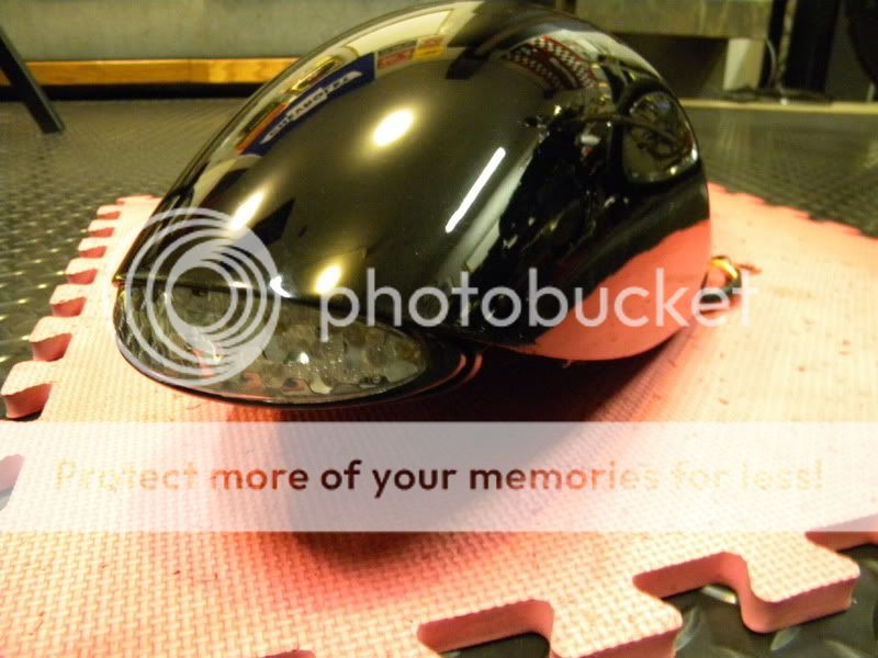

Tail light mounting pics!
The assembly epoxied in place:
Close-up of tail light mounted to seat:
Two views from rear with seat on bike:
Not much left to do to finish this project up. Stay tuned!

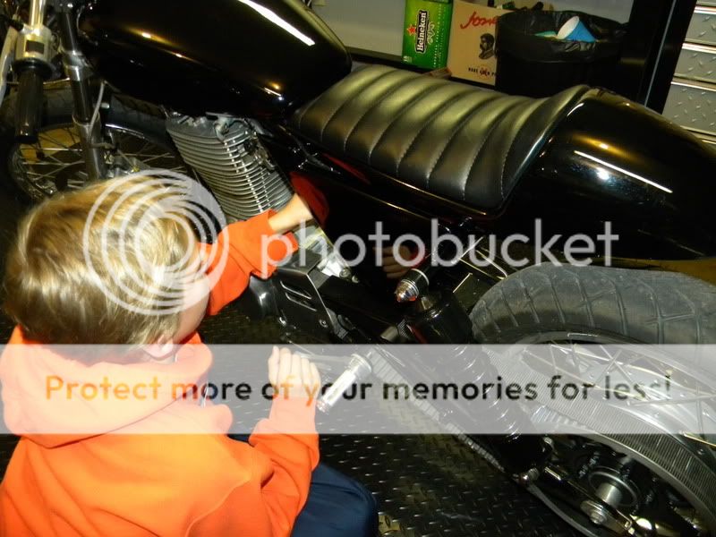

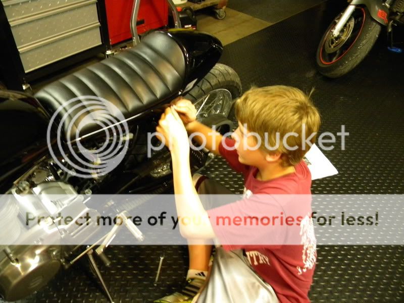

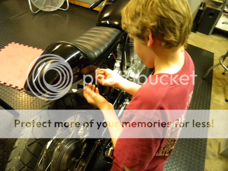

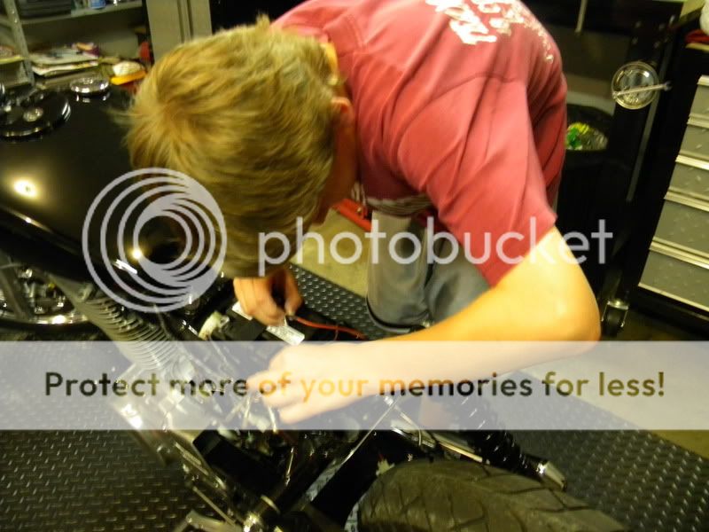

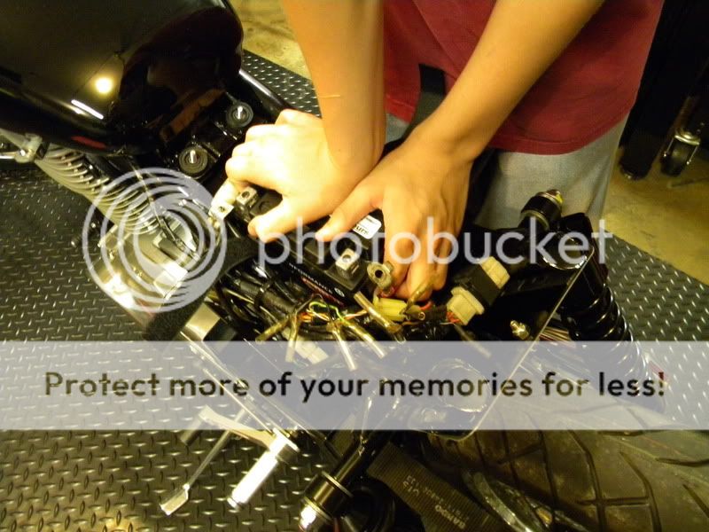

The battery that came with the bike finally gave up, so the Chief Assistant and I installed a new one last night:
After hooking up the tail light and turn signals, the seat gets installed:
The Chief Assistant mounts the bases that the side covers will mount up to--smaller fingers are an advantage here:
We just need to mount the side covers and front turn signals and this bad-boy will be done! Our goal is to get this puppy finished up on the Monday holiday--stay tuned!

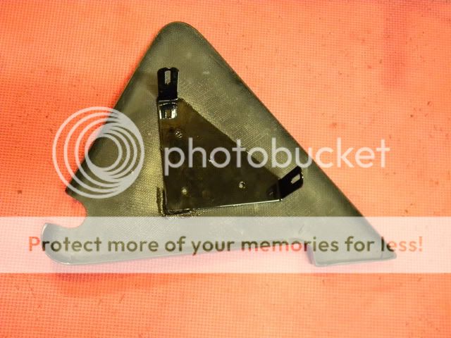

Here we go ryca fans--the big finish--the chief assistant and I spent some time in the shop the last couple of days getting our project bike ready for the local bike show today:
Base of the side cover epoxied to the inside of the cover:

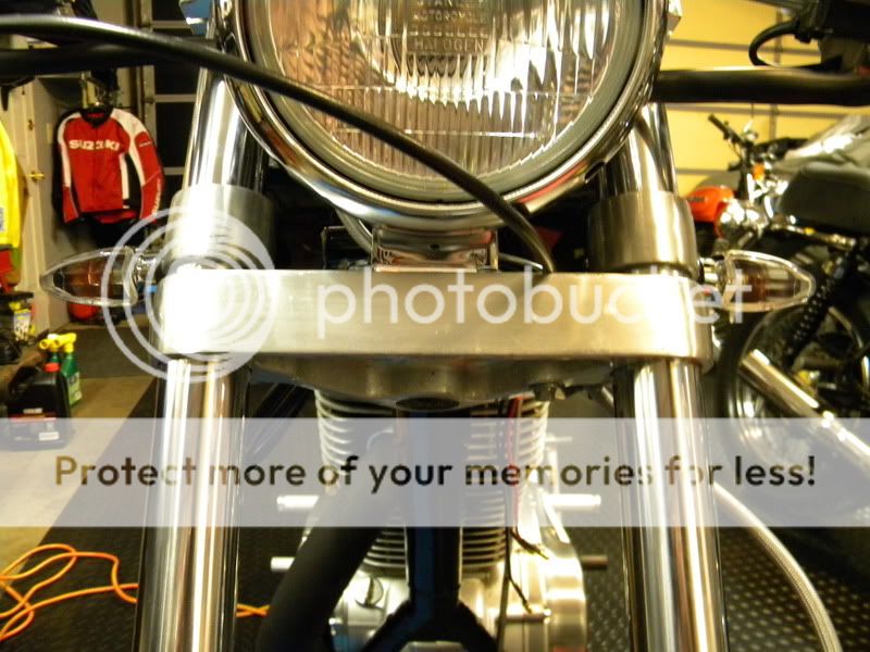

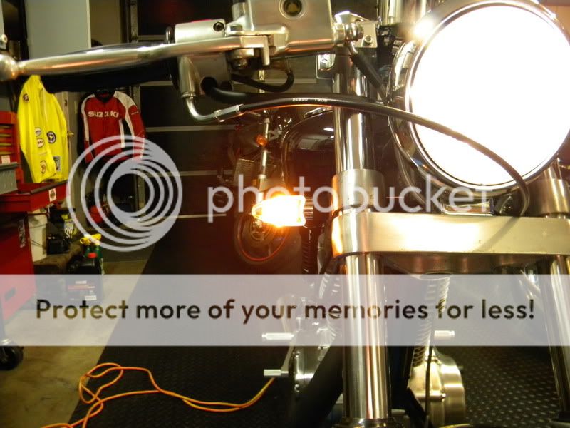

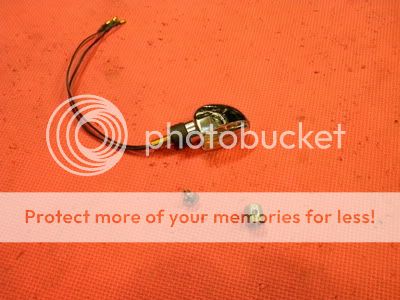

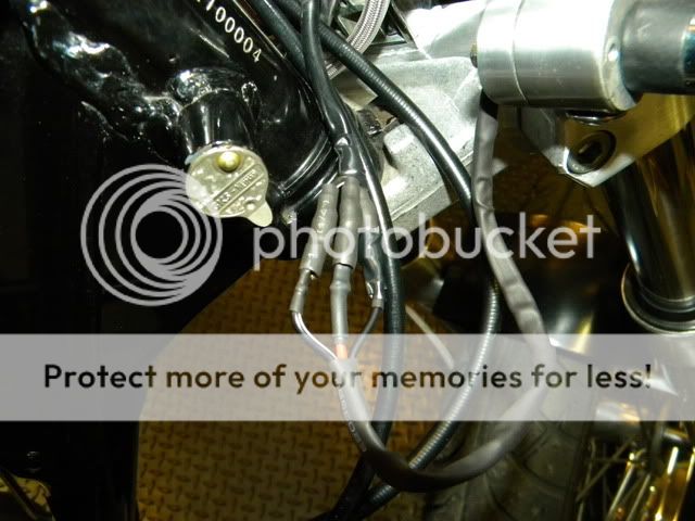

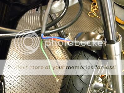

Front turn signal:
Turn signals mounted:

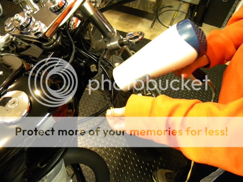

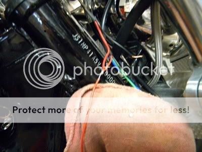

Heat shrinking the wiring:
Right signal wired up:
Right signal works!

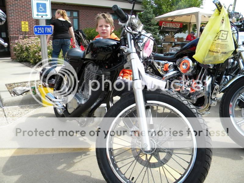

Setting up at the bike show:
The chief assistant collects our award--top ten overall!
Enjoying the fruits of his labor:
It was a great day and the perfect conclusion to a fun project--stay tuned for a link to a video in the near future!

Tidied up some wiring from the tail light today--epoxied a couple of nuts into place under the fender cowling to route the wiring--we'll see how this works--hopefully more permanent than the duct tape I used to get the bike ready for the bike show. :angel
I need to re-postion my rear-sets tomorrow for a more comfortable foot position. I also need to do something with the mirrors--I like the look, but I can't see much of anything behind me. I suppose a guy is never truly "finished" with a bike build. :angel

You may notice that the right front turn signal is missing its lens--I was trying to change the bulb and buggered up the lens. :Bang :Bang :Bang They were cheap ebay items--I may look for something of a little higher quality.

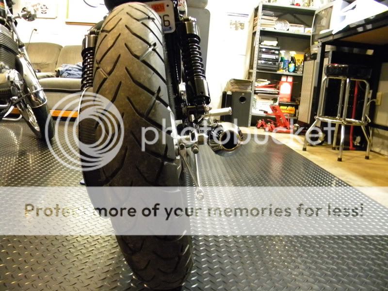

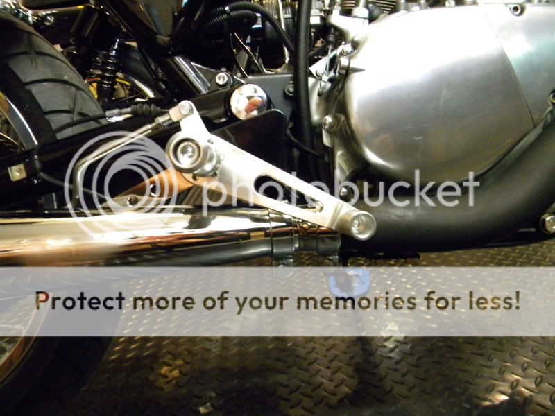

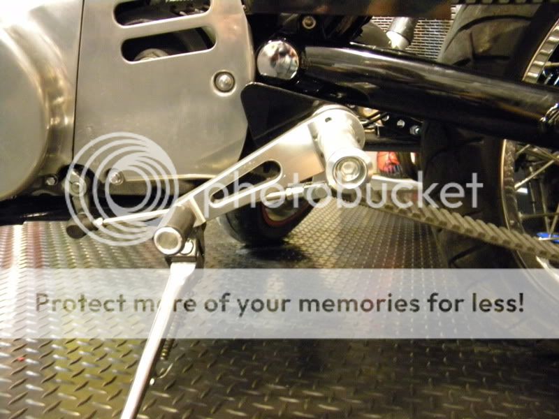

I adjusted the rearsets over the last 2 days to a lower position--much easier to shift and use the rear brake.
Here is a pic of the right rearset after initial installation:
Here is the right rearset after adjustment:
Left rearset after adjustment:

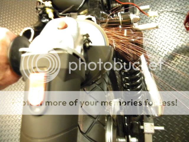

I also added a spacer to the bracket that holds the muffler in place--I was able to tuck the muffler a little closer to the bike as a result.
Before adding the spacer:
After adding the spacer:

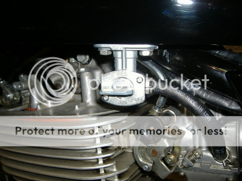

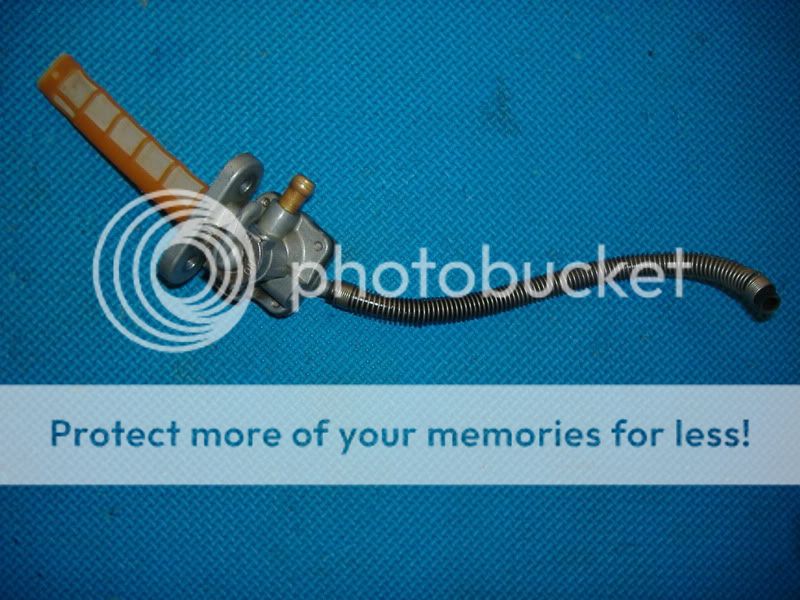

I swapped out the stock petcock for what the savage message board calls the "raptor mod." It is actually a Yamaha part that fits this bike and replaces the stock vaccuum petcock with a petcock that has a true on/off. I was tired of vaccuum leaks that caused the bike to bog whilst traveling down the highway at 70 indicated with large vehicles behind me. :eek
Here is the new petcock:
Here is the original petcock with vaccuum line:
Here is the new petcock installed--no vacccuum line, so I had to cap off the vaccuum port on the carb with a small rubber cap:

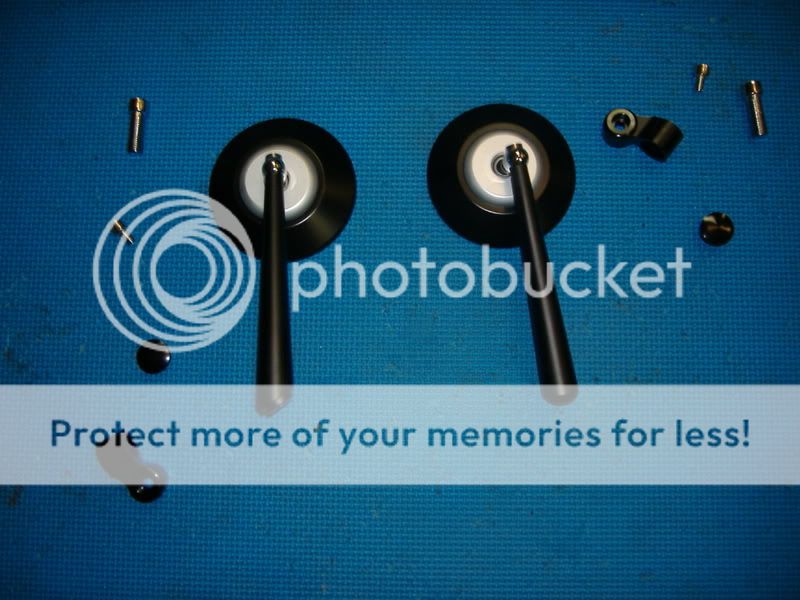

I also purchased new mirrors, but need to also install some extenders to that I can see past my shoulders:
I will get the mirrors installed soon, then will install new front signals. Then start looking for the next project? :angel :angel

Hey Steve. I got the mirrors mounted, but have not swapped out the front signals yet. I will try to take a couple of pics and get them posted up. I put about 1000 miles on the project bike over the summer/fall--the new petcock works great. It is a BLAST to ride and I always get comments/questions when I'm on it. I rode it to the Moto GP in Indy (about 100 miles from my home) and enjoyed the attention it received that weekend.

for future reference with the petcock, you can remove the cover from the vacuum diaphragm
and remove the spring (that causes it to close when vacuum stops) remove the diaphragm,
insert the spring in front of it, then replace the diaphragm.
this way the fuel circuit is never blocked by the diaphragm again as it is held open by the spring instead
of being closed.
did it to my track bike, so it was one less thing to go wrong 8o :D
