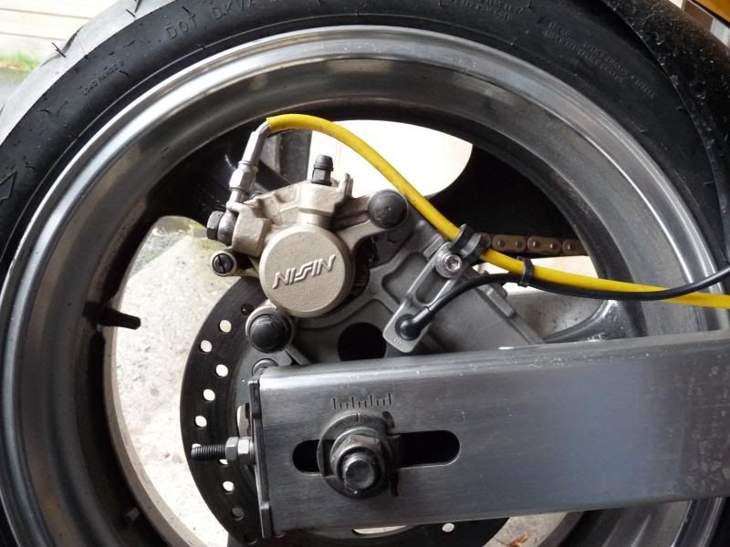

Going to have the RX2N digi clocks, using a VFR800 Speedo pickup. Some have said that i will need a speedo healer, but the VFR800 is the same part as used on a fireblade.
The VFR, Blade and Hornet all use a 14t front sprocket, so why would i need a speedohealer? I thought they only converted KPH in MPH?

If you are using RX2 clocks, why use the VFR speedo pickup ?
Use the magnetic pickup they come with, then setup the clocks (rolling circumference of wheel) to give an accurate speedo reading, no need for speedo healer.
Those bikes you mention may well be fitted with a 14 tooth gearbox sprocket, however I doubt that they will have same final drive ratios, so speedo would read differently on each one.
Now, if you fitted VFR clocks to go with the VFR pickup, and you used the same size front AND rear sprockets on your Hornet as the VFR, that'd work.

The magnet they come with i havent seen as yet, but i just dont like the idea of a magnet attached to my front wheel. Sounds like something off of a raleigh.
But ill have a look at the it when it arrives.
I understand what your saying about the VFR Speedo pickup, but surely the sprocket still spins at the same speed at 30 as a fireblade or VFR, there for the pulse would be the same?
Surely its the clocks (if anything) that interpret this signal as something else?
It will only spin at the same speed if the rear sprocket on the 'blade or viffer is the same size as the one on your Hornet.
A bigger rear sprocket would make the front sprocket turn faster at 30 mph, and vice versa.
Regarding the magnets, I agree that a front wheel mounting does look crap. However, it can be mounted quite neatly on the rear wheel.
Magnets in the disk mounting bolts, pickup fitted into a hole drilled in the caliper bracket.

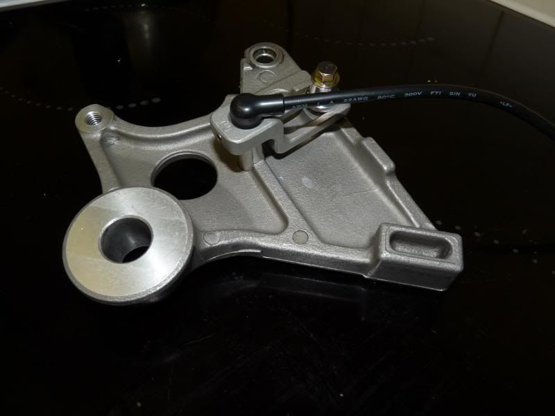

Yeah to be fair that dont look to bad Rich, but will have to have a gander, as the swing arm is getting an over haul as well :D

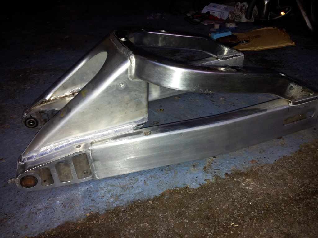

Anyways, parts are starting to arrive, R1 swing arm has just arrived, going to cut the bracing off and weld it onto the standard swing arm. Dont know if this has already been done, but i suspect it has.
Looks to be a good size anyways...
Swing arm should be done by Friday next week hopefully, if i can find the time.

Going to cut a nice little arc out the brace for the suspension to move in, noticed it looked a little close like.

Swing arm done:-

I know no ones probably all that interested, lol, but im going to update this as more of a diary for myself ;)
Remainder of the Subframe:-
Swing arm done:-
Engine out friday night.
Ordered a few little things like engine paint etc etc.
Oh and stainless bolt kit.
do me a swinging arm dude, love it

nice swinger chris. look forward to seeing it tomorrow.
about these brackets, im gonna make a mock version tomorrow for you just to be sure it fits the way you want it before i make it outa proper stuff.

I'm impressed with that swing arm.
Did you weld it yourself ?

I wish I had mate, but I don't have the kit for Ali welding.
Dropped i down to the guys at GIA Engineering in Stapleford Nottingham.
Did a brilliant job, cost just shy of a ton. Just needs powder coating now.

Just to keep updated.
Manifold Off
Stainless steel bolt kit on, thanks to munketeer
Swing arm back from powder coating.
Manifold Polished
Bits ready to go bad on.
Swing arm in back in place.
More things coming soon hopefully, will show you as and when.
Chris
 Post Posted: Sun Aug 14, 2011 4:55 pm
Victor Meldrew
Joined: Thu Feb 27, 2003 10:51 pm
Posts: 5406
Location: Worcester
I DO like that swingarm, looks much better than Metmachex.
Does it clear the shock on full bump ? Chain run OK ?
Mounting points for OEM R1 hugger, I guess ?
Prefer polished alloy though.

 Post Posted: Mon Aug 15, 2011 9:24 am
Hornet Warrior
Joined: Sun Feb 06, 2011 8:50 pm
Posts: 167
Location: Nottingham
Yeah clears the shock mate, and the chain run perfectly fine. I decided to take the chain back off, as I'm getting a gold chain and sprocket set.
The mounting points are for a OEM R1 hugger.
Would have gone polished myself, but with the engine going black, i thought it would fit in better.

 Post Posted: Wed Aug 17, 2011 4:57 pm
Needs to get out more!
Joined: Sun Nov 02, 2008 5:45 pm
Posts: 1368
Location: Worcestershire
Looks fantastic mate - well done :clap
What year/spec R1 swing arm is that? I may keep an eye out for one and get mind done - like Richard says - it looks better than the Metmachex one!

 Post Posted: Mon Aug 22, 2011 10:40 pm
Hornet Warrior
Posts: 167
Sorry guys just got back from Holiday.
The R1 Swing arm was a 2002 5LL Model.
Took it to the guys at GIA and got it sorted for £80 odd quid.
Then the powder coating was done at John Whitman Powder Coaters and cost £15.
Chris
 Post Posted: Mon Aug 22, 2011 10:43 pm
True Horneteer
Joined: Sat Apr 03, 2010 1:46 pm
Posts: 1808
Location: South wales
the bracing actualy added any strenght or just for looks ? ...
 Post Posted: Wed Aug 24, 2011 8:40 pm
Hornet Warrior
Posts: 167
It will have added some strength, but as the bikes still in bits haven't ridden it yet.
Was mostly added for looks.
Those interested in doing the same, be aware the standard caliper will not fit.
Upgrade to a blade rear caliper and holder, and jobs a good un.
Chris
Chris
blade has the same caliper!!
370Steve
 Post Posted: Thu Aug 25, 2011 8:02 am
Hornet Warrior
Posts: 167
Scratch that,
You'll need a blade caliper carrier then ;)
 Post Posted: Fri Sep 02, 2011 7:14 pm
Hornet Warrior
Posts: 167
A few more bits done.
Fireblade Hanger and Caliper (even though I'm now informed the calliper on a hornet is the same.)
Then Painted.
