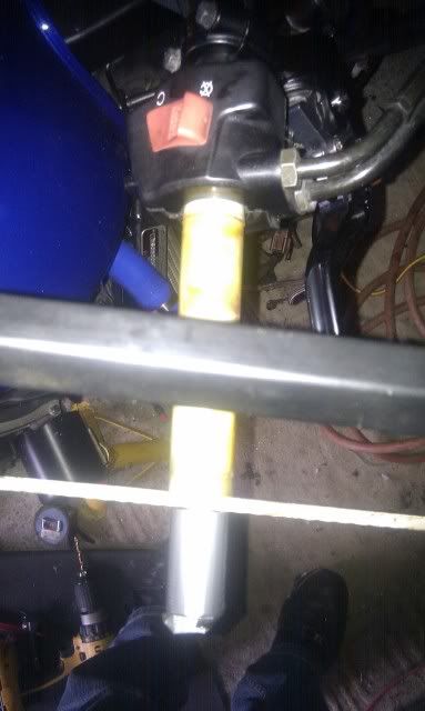

whats the old shock like??
better than my 105,000 km one?
 Post Posted: Sat Nov 17, 2012 9:21 pm
Posts: 1881
Its a little rusty at the bottom but it works fine........ive not seen your shock?
 Post Posted: Sun Nov 18, 2012 5:12 am
Joined: Mon Sep 06, 2010 9:54 am
Posts: 711
Location: Nez Zealand
pitted on the chrome part
 Post Posted: Sun Nov 18, 2012 6:20 pm
Posts: 1881
hayd3n wrote:
The chrome on my old shock is fine its just the spring that is rusty.....its only done 11k miles :mic

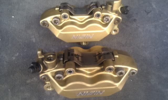

Cleaned up the new calipers, i think i may buy some stainless steel caliper bolts as these are just starting to look a little weathered 8o

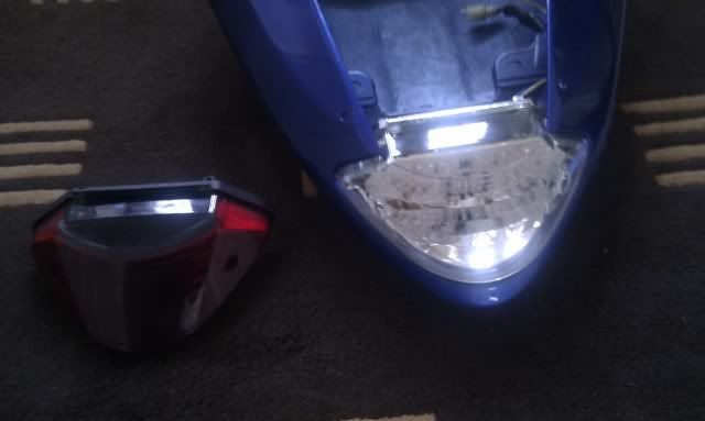

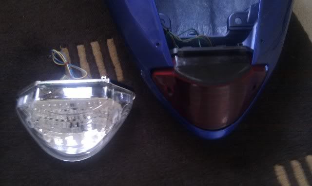

I ordered this intergrated led light from Jester.........................
A quick swap over and...............................
I think it gives it that clean new look.

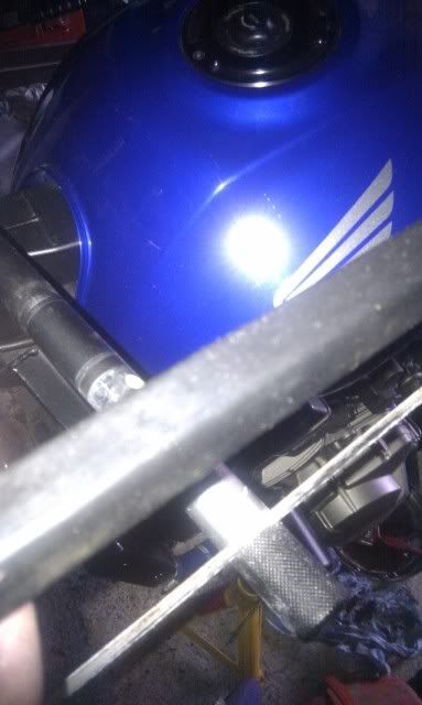

I also started to shorten the bars as they are hideously wide.
Ive taken 40mm off each end 8o

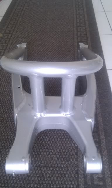

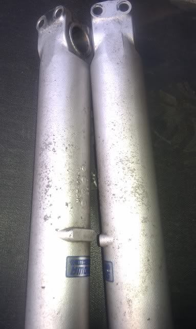

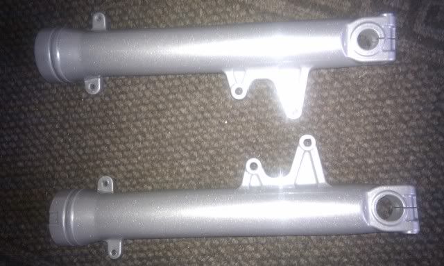

I was going to get the swingarm and forks polished but after waiting nearly 3 weeks for a polisher to do it, ive decided to get them powder coated :mic
fork legs before..............................
Fork legs after coating with sparkling silver........

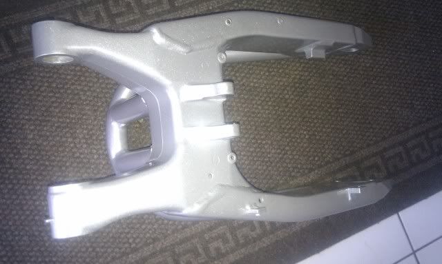

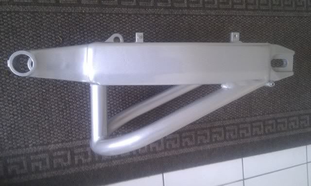

I posted a picture of the Swingarm before with hole in the underbrace earlier, so, here is the arm with the hole filled in and freshly coated.

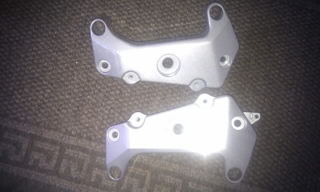

I also got the swingarm side plates powdercoated although they didnt really need doing, but at least they will match.
Next on the agenda for the powdercoaters was some items to be done in black!
The bar brace, a second hand clutch perch and some paddock stand bobbins.
The clutch and front brake lever will now be matching Titax items.

Done some more on the bike, but not as much as i wanted to :halt Ive just started another contract and may be working through the festive season :Bang
Ive managed to get the bearings back in the swingarm, so, i fitted that and the new Hagon shock from Jester.
Its made quite a differance.
Before :eek :eek :eek ............................
After powdercoating and new shock fitted :love

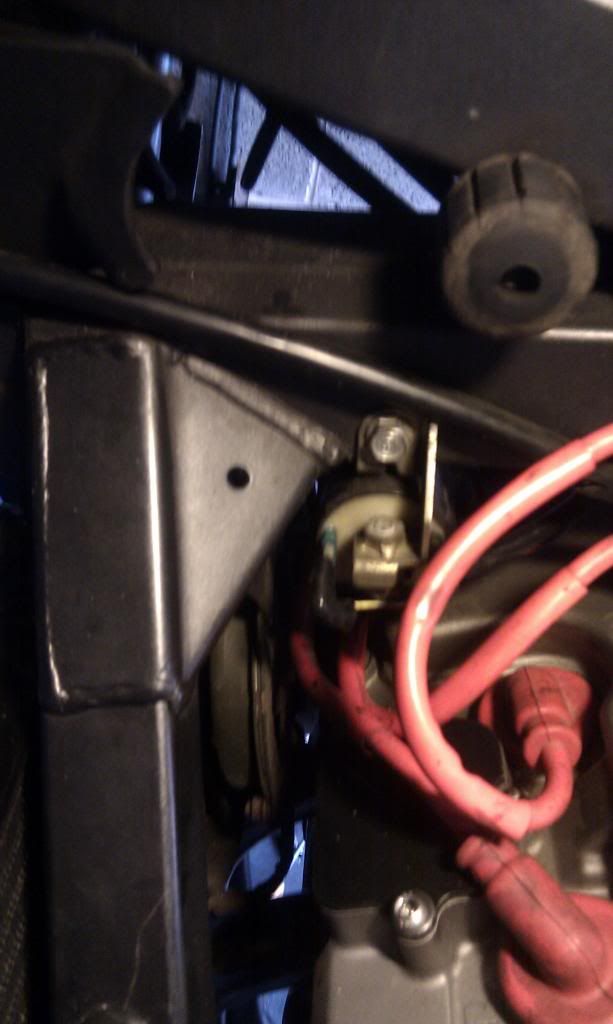

I was hoping some eagle eyed fellow would point out i had put the swingarm and shock back in, but, had not put the y pipe back on before bolting up the rear shock......Doh! good job it was only a 2 minute job once the downpipes were fitted :Pray
It would seem its a lot slower refitting all the parts as most of them have to be cleaned first or modified.
The number plate bracket and undertray needed some attention......why you would want all this wiring for two poxy indicators is beyond me :eek The problem with this big clump of wires is because 4 resistors have been fitted for the led indicators :help
The indicators and wiring have now been removed as i now have the indicators intergrated into the led rear light :D
I will order a proper flasher unit that replaces the stock flasher unit to correct the flash rate 8o

After a little fiddling around.....
Ive actually kept the reed valves in place but had to drill out the tops of the screws that hold them in, so the alloy plates fit flush and reseal 8o
This is whats left over to go in the bin :eek
After removing this little lot it will make access to the spark plugs much easier in future :blahblah
And not forgetting to block up the hole into the airbox 8o
I found this cap end on a plastic tube from a burr that fits a treat :D
