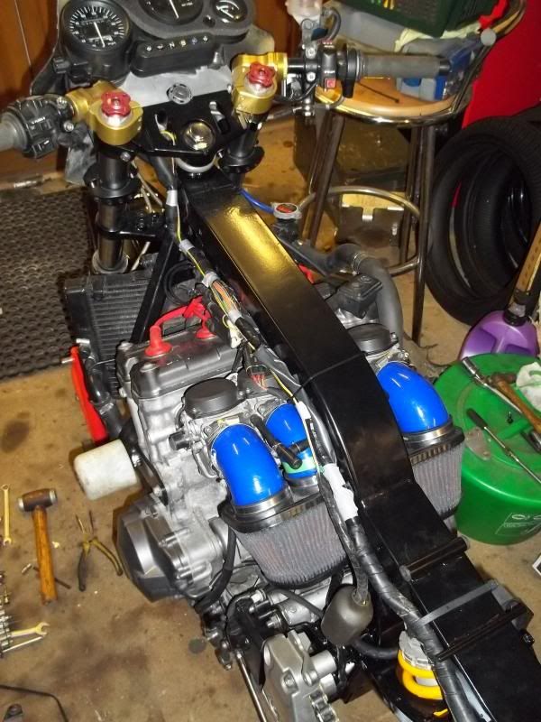

got on with getting things back together this weekend, getting there, shouldn't be long
before shes all ready for a quick run on the dyno and an MOT :)

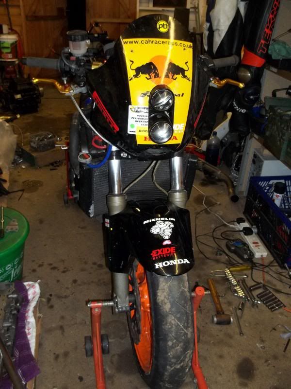

went too work on the lamps and nose cone, i am thinking they are going to be just what i was after :D
also did some work on the exhaust can, cleaned it up and got it ready for the MOT
funny thing was as i was cleaning it some bits fell off!!!!! dont know where they came from, so
wont be looking to replace them :rollin
that pic of the bits that fell off made me chortle steve :evil
sorry you lost them in the cleansing process

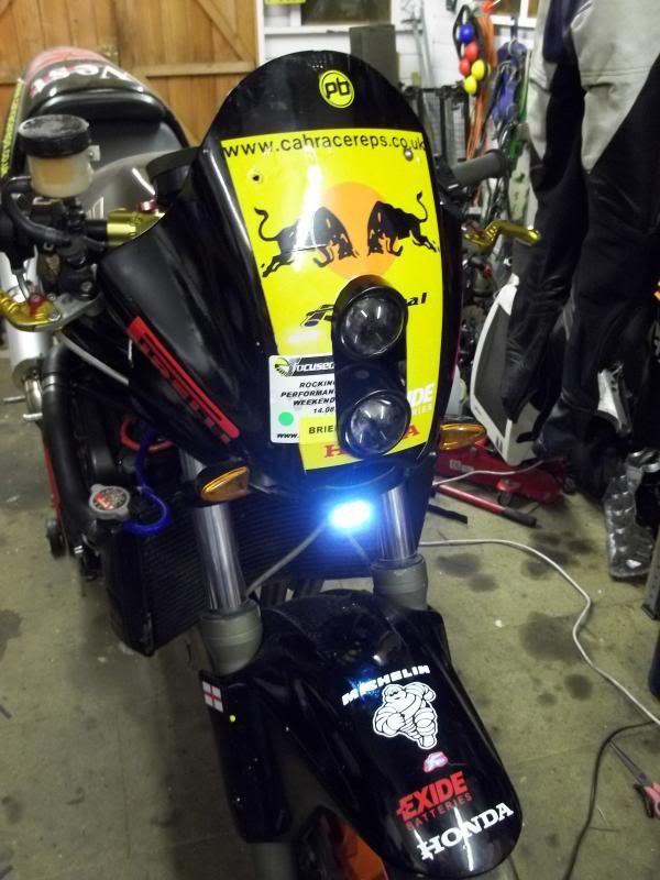

now finished playing around with how the nose cone sits, will stay as it is in the pic when finally
bolted in place.
fitted the air filters and hoses, side stand, under tray and cleaned up some of the harness
that i didnt do last time.

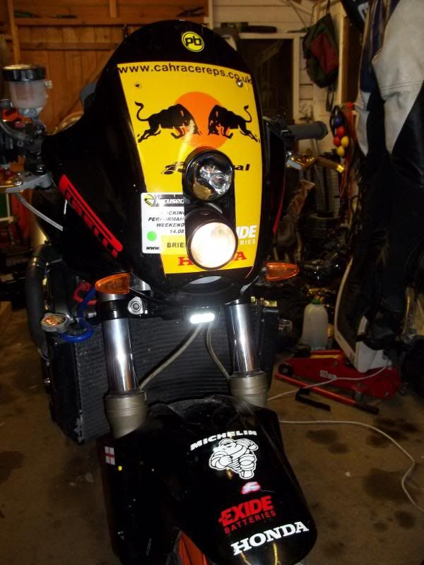

finished off fitting the battery box, then put it all together and wired it up
then fitted the exhaust, re filled the coolant after re attaching the header bottle, tested the lights with the battery fitted.

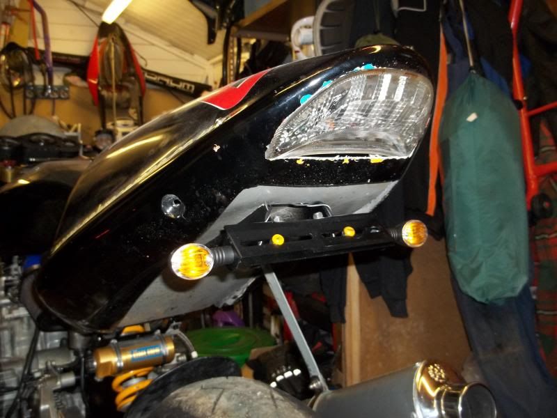

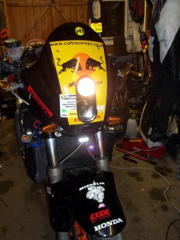

almost done enough to get her in for an MOT and Dyno setup :D
just need to make a number plate hanger, fit a side light and the indicaters 8o

put the indicators on, fitted a side light and sorted a number plate mounting bracket.
all working and ready for MOT :)
side light
lights
rear end ready for numberplate
