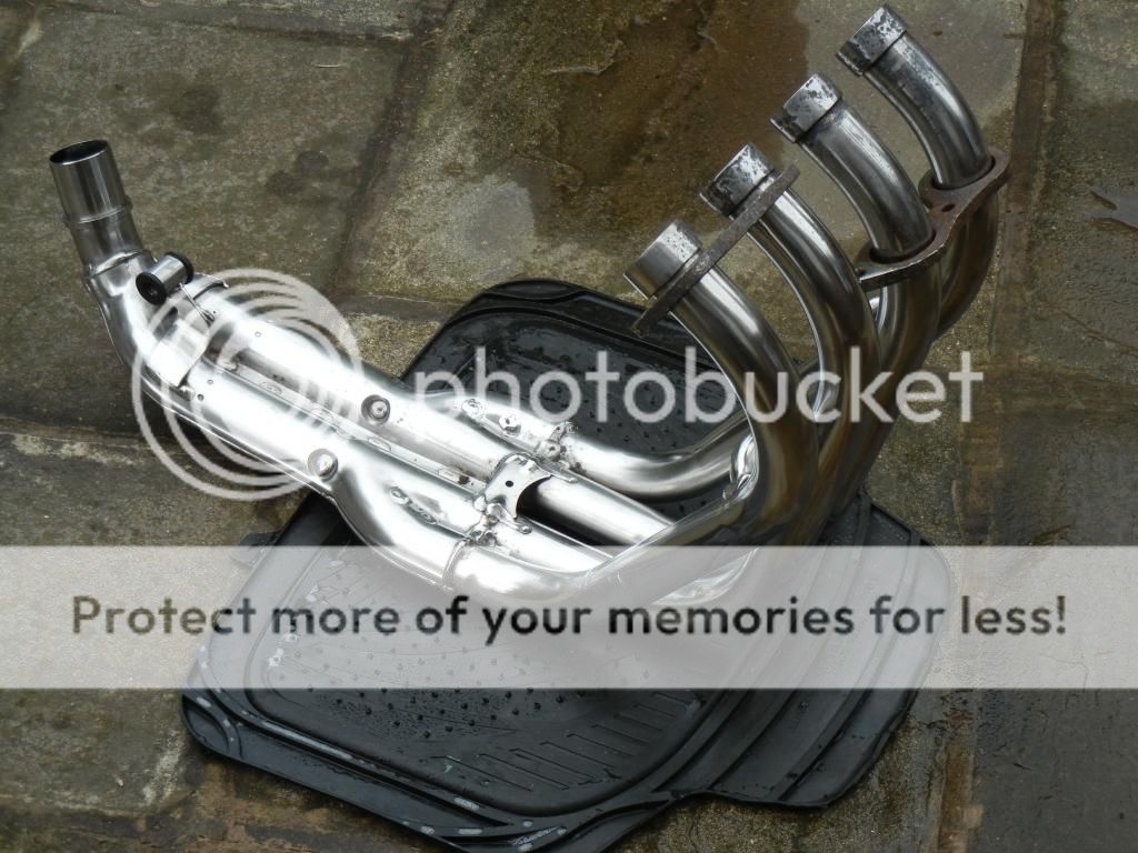

Sent some bits to the painters and cleaned up my downpipes
Before
After

Nice photograph of the later type exhaust headers, worth saving for future reference. :thumbup

Can I send you my pipes for a clean? 8o
What did you use to clean them?

Ha ha. They look better in the picture. There are still a few blemishes that I can't get rid of.
I looked round on here n found that most are just using metal polishes. I used Peek, Autosol, Brasso and some scotch pad. I found a link somewhere that someone had used a stainless cleaner- Opitglanz or sumat. Used that first, that stuff you actually see working. Seems like the stains litterly wash off. German stuff I think. eBay.

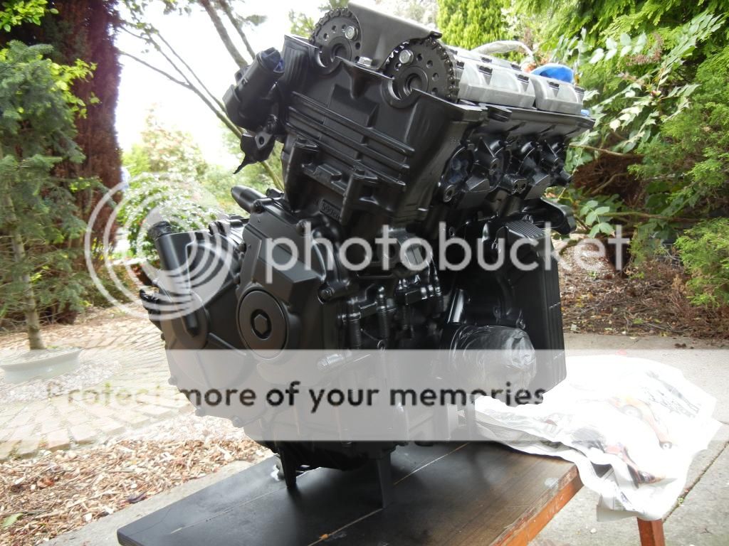

I finished cleaning the engine, took a while but need to make sure its as clean and grease free as possible.
Taped and plugged holes up and took out the rattle cans...
Got some stainless bolts to swap over too when I get some time. Should add a bit of detail to the black lump.

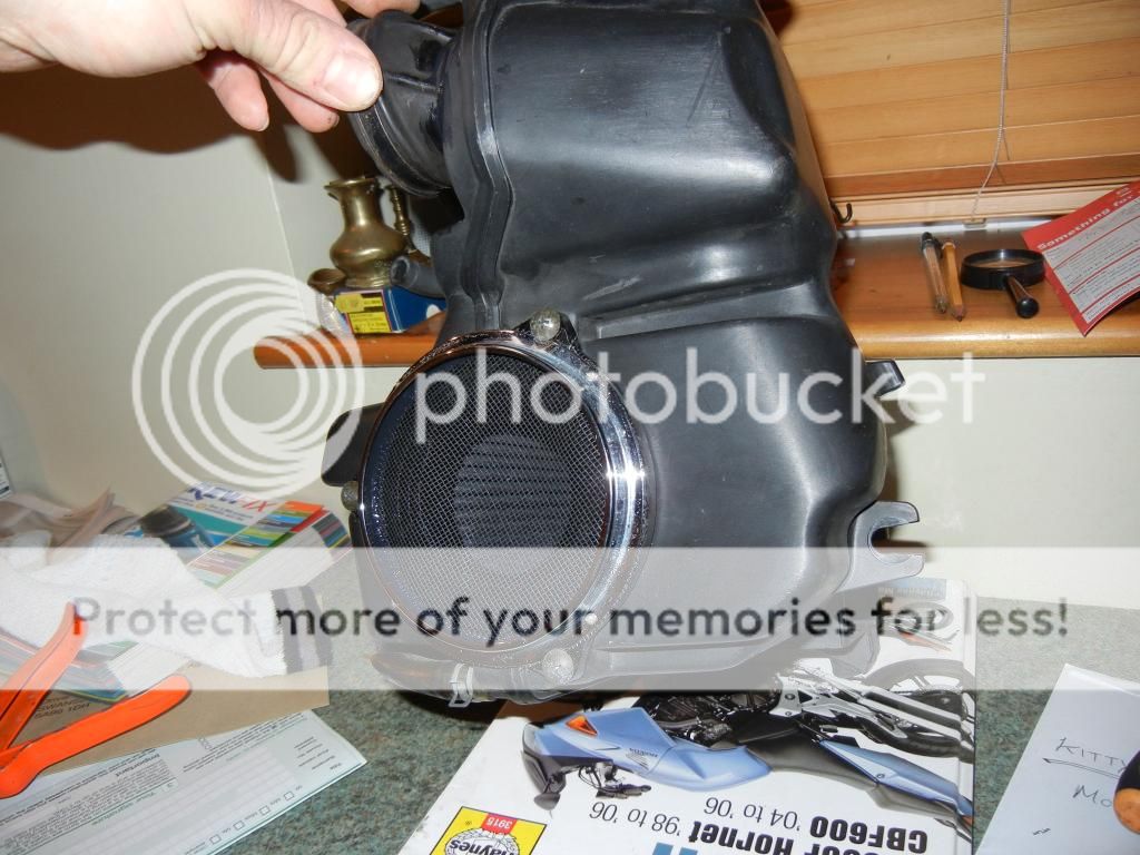

Chopped into the air box and removed the snorkle and drilled my Renthal Lows ready for putting the levers etc back on.

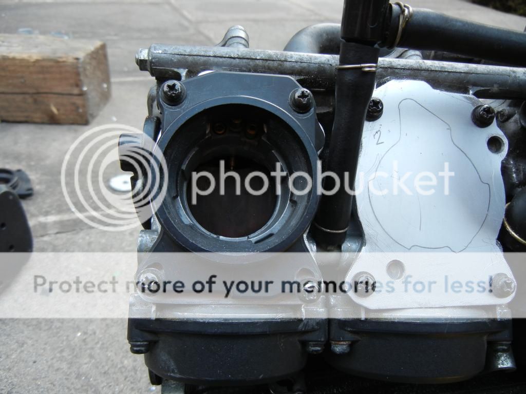

While trying to find out more info on the Carb swap, I've started modding the inlets and making some gaskets...

The Exhaust CBR Cams are hitting the valves in to the pistons.
Now need to check all the valves to see it any are bent. There doesn't seem to be any damage to the pistons other than just some light impact marks.
Has anyone doing the CAM Mod come across this? Why does the Intake side work fine but the Exhaust foul, or have I missed something out? The valve clearences where spot on.
i was hoping to go get it MOT'd today but this has put me back until next week now. Hopefully the nice weather will hold out for me.... :Pray :Pray :Pray :Pray

Yeah the Inlet works fine just the Exhaust side having bother with. Other people done this mod because I read somewhere that you need to cut the end off the cam and re-plug it. Which I've done, or I can re-fit the Hornet Inlet but wondering why bother to do all that to the CBR cam when it won't work. I must be missing something or doing something wrong, I just don't know what lol...
