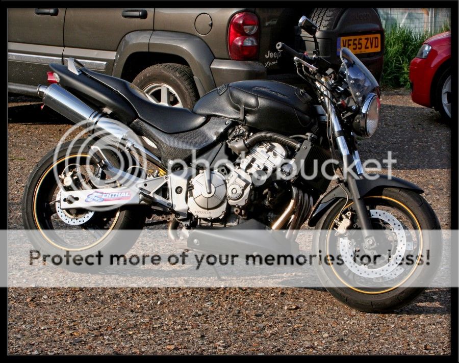

This is the bike in question..............
On first appearances it looks ok but you have to look close up to see its had a hard life or some owners that are not quite as handy with the tools :notme

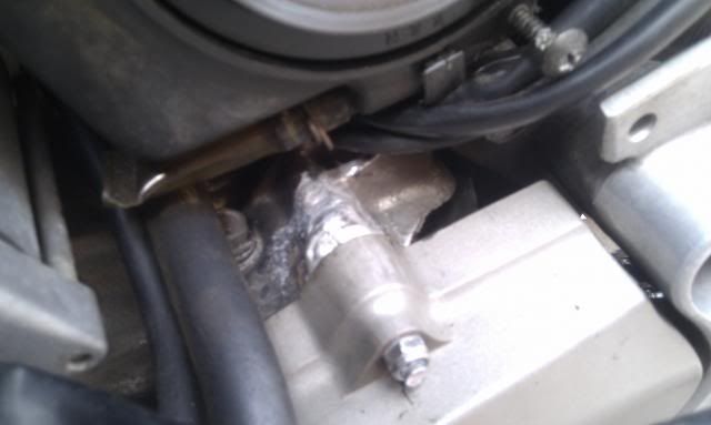

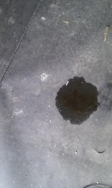

After having the bike delivered I put it away in my garage for a couple of days, its apparent its related to the Exon valdez!

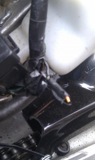

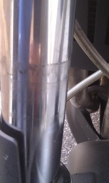

I looked for the leak and spotted this repair :eek
This repair probably due to chain trouble was easy to spot 8o
It looks like its not the only thing that's leaking...................

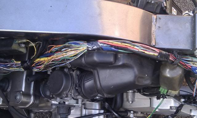

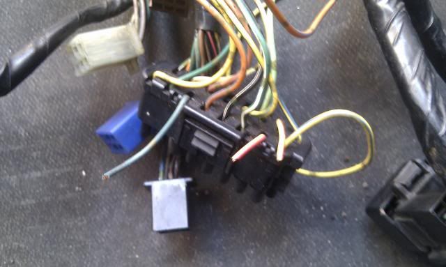

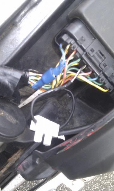

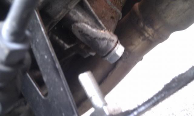

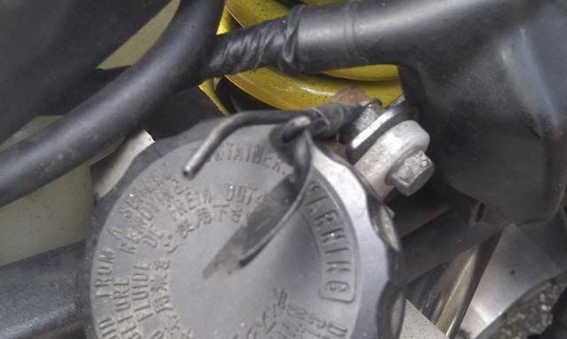

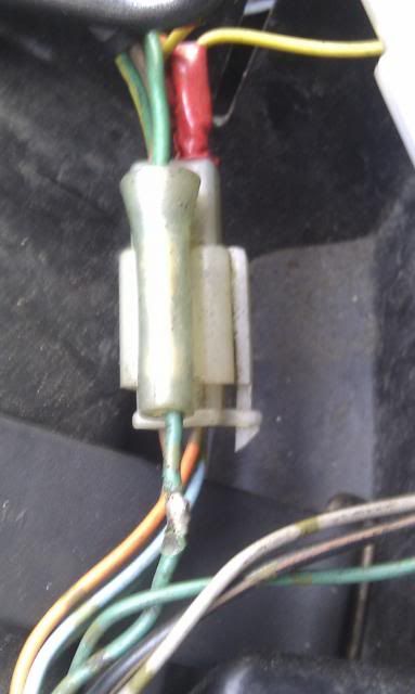

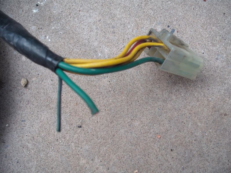

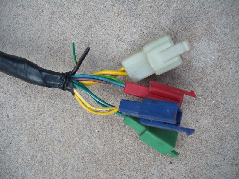

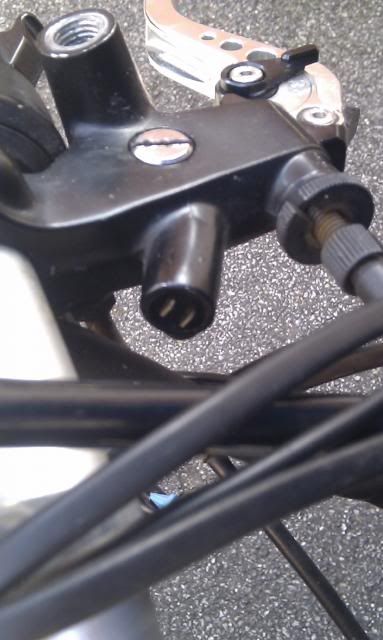

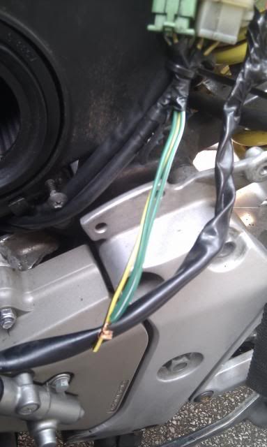

And then there's the wiring, This looks like the bank angle sensor has been removed............
Cut and bodged wiring.............
Cut and joined wires into the ecu................
more joins...............
Something used to be here...................

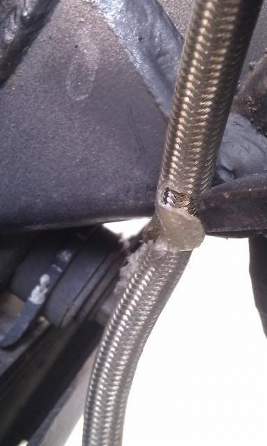

I also noticed this brake line has been trapped on the steering lock......
Clutch cut-out removed...............
Sleeve removed by previous owner for fault finding............

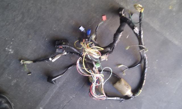

A spare wiring loom came with the bike, happy days :)
Until closer inspection and 3 wires have been cut at the ecu plug
And last but not least and this really made me laugh..........
Why didn't the previous owners take note of that :rollin

Ouch. I was sure this would be straight forward once you'd applied a bit of thinking - seems somwhat more involved now.
Got to be a bad (aren't they all) alarm removal but some really do butcher the loom.
Poor show on the leaks and welds - I wouldn't have expected that.

is it time to learn the beautiful art of soldering? seriously though get a haynes crack open the wiring diagram and you should be re-wired within a day

bank angle sensor
Side stand switch, surely ?
 Post Posted: Mon Jul 29, 2013 10:47 pm
Scratcher2
Joined: Sat Jul 28, 2012 2:55 pm
Posts: 648
Location: Cheshire
bank angle sensor
10 points to you for that it is indeed the side stand switch but only the two outer wires need connecting as the middle wire is for a light on the cbr dash which the hornet does not have the hornet also does not have a bank angle sensor iirc? correct me pitman?
get that soldered up as it will never run if those wires come apart

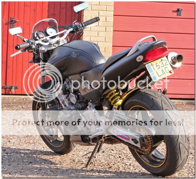

I have a picture on my phone of a few Hornets lined up at the Ace meet last year (October) and this bike is in there behind a 900. The guy riding it was a nice bloke (sorry crap with names) - he was thinking of moving on to a CB1000R. I think he rode the bike down from Manchester for the day.
Will post the pic in a few days - (creating a new Photobucket account and waiting for them to clear the old one first).
Definitely remember that sticker. :clap

bank angle sensor
It was only a guess as its in the same place as my 900, I didn't realise the 600 doesn't have one :pissed
I'm on the lookout for a new loom, but I might have to join a couple of wires if needs be :eek

North_London_600 wrote:
I have a picture on my phone of a few Hornets lined up at the Ace meet last year (October) and this bike is in there behind a 900. I will post the The guy riding it was a nice bloke (sorry crap with names) - he was thinking of moving on to a CB1000R. I think he rode the bike down from Manchester for the day.
We do know one of the owners who used to have it and have met a few times.

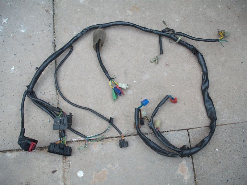

Is this any use to you ? You are welcome to it if it is.
A couple of connectors snipped of by me for use elsewhere, otherwise all present and correct.

Posts: 1881
Thanks for the offer Richard but it now appears I shall not be needing a new loom as I have now got it sparking and running :D :D :D
I shall however tidy this old loom up properly now I have found the cause :Pray

Any chance u could tell us the cause of no spark and what u dude to fix the problem as mine has the same issue please help

could be the ignition diode...

Woodyee's problem was a bodged alarm removal job.
As well as that 'secret' diode. there is another diode in the fuse box, in the side stand / neutral / clutch interlock circuit. I'd guess if that failed it would lead to these symptoms (Not woodyee, I'm referring to the thread hijacker. :blahblah )

 Post Posted: Sun Aug 18, 2013 9:23 pm
Posts: 1881
The problem was the black wire that had been cut and joined was only held together with heat shrink tubing.
 Post Posted: Tue Aug 20, 2013 11:18 am
Joined: Thu Feb 28, 2013 9:31 pm
Posts: 12
thank for the reply my lom hasnt been cut so gonna replace the ignition barrel sorry for hijacking thread and thank for all theinfo hopefully my hornet will be on the road by end of week
