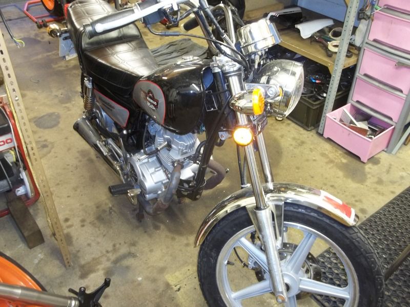

My partners bike, needs a bit of work!
fork bushes and stanchion, carb, brakes :ill
so wish me luck

first thing i really need to do is find a source of parts for it, either Chinese or whatever OEM Jap motorcycle it is a copy of.

also been looking around the web for spares outlets, seems that E-bay is going to be the best bet at
the moment.
looking at it the bike is a copy of the Honda CM125, but not sure if it is at all compatible for bits interchange, but
i will have to look deeper into it, as i can only find replacement assemblies at the moment, i am in need of new fork seals and bushes, not really wanting to buy a fill set of forks for it, even if they are rather cheap at £99 for both forks.

ordered some bits for my girlfreinds bike, ready for the winter make over.
new carb and new switch gear.
the new throttle cable came yesterday.
now only need to order a new side stand and bracket for the side stand along with the new forks to get it sorted.
looking to get it re sprayed if we have enough cash later in the re furb.

have now got the switch gear, throttle cable and new carb, just needing the bracket for the side stand and the forks, and it is "job on"

slowly getting things together, have now ordered the side stand bracket, will probably need to drop the motor
to get access to the damaged mounting point, might need to re tap the thread, or fit a coil insert to get it sorted.
I will start some work on it soon, but have work to do on both my bikes, so this make over is definatly getting done "slow time"
once most of this work is done i will order the new forks, and fit as part of the completion process.

Right, I have put things off for long enough now, cant keep ignoring the poor little thing, sat waiting for some loving of the spanner variety in the shadows of my beasts.
so i am going to make a start on the "beastett" tonight...........................................watch this space
 Post subject: Re: 370 goes to the east
 Post Posted: Wed Mar 23, 2016 11:09 am
Posts: 9973
set about it last night (gnarf gnarf) got the engine almost out, only snapped one of the four exhaust studs! but it shouldnt be a problem as it is sticking out from the head and will be easy to get a grip of.
main job to the engine is the replacement of the foot peg hanger bracket, it bolts to the bottom crankcase of the engine, it also should have the side stand bracket welded to it.
somewhere along the way in its history it has hit something with the side stand and removed it along with the bracket!!! i had thought that the bracket had taken one of the mounting bolts with it when it went, and must have pulled the threads out too, but on closer inspection the threads are un damaged, so i can just bolt the new bracket in place without the need to do a thread repair. bolt must have fallen out before the impact, result.
I will remove the engine tonight, make an attempt on the stud and see where i can go from there.

have done a bit of work over the last two days, took bike apart, removed engine, went to work on removing the snapped exhaust
stud, had left it soaking in penetrating oil for the last week, took my blow gun to it tonight and a few sharp smacks from my trusty hammer
had it moving.
re fitted the engine.
didnt like the state of the cheap bolts fitted to the engine and its mounts so in my usual manner i changed them out with nice Stainless steel socket head bolts and nylock nuts that i had sat around!

now have just about all the bits i need to get things sorted,
new forks arrived yesterday, fitted the new carb and cable when i fitted the new throttle side switch gear, have to connect to the harness yet but need to remove the H/light to get at the connector first. couldnt be arsed at the time, so called it a night.
have had the battery on charge for the last few days, hoefully it will have enough charge to get it started, when i get round to attempting it.

This re build has now officially come to an end :(
it will be removed from my shed bit by bit, and sold of on E-blagg.
but rising from the ashes of this never finished project and following hot on its heals will be GS600, little sister to GS1157 :)
see new build thread for details 8o
