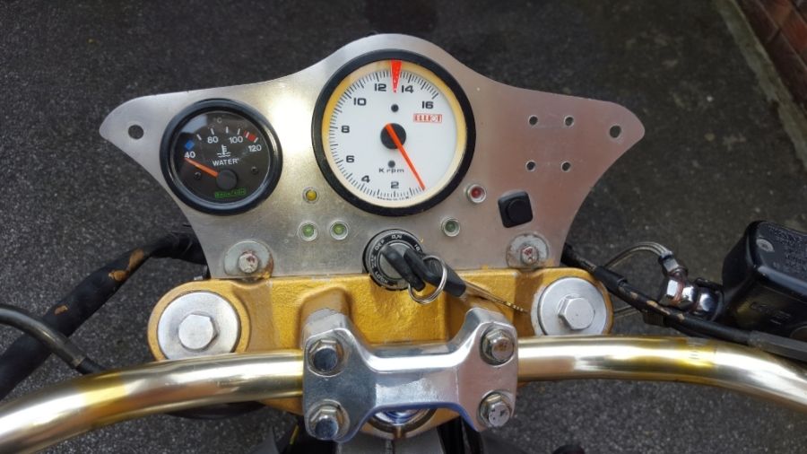

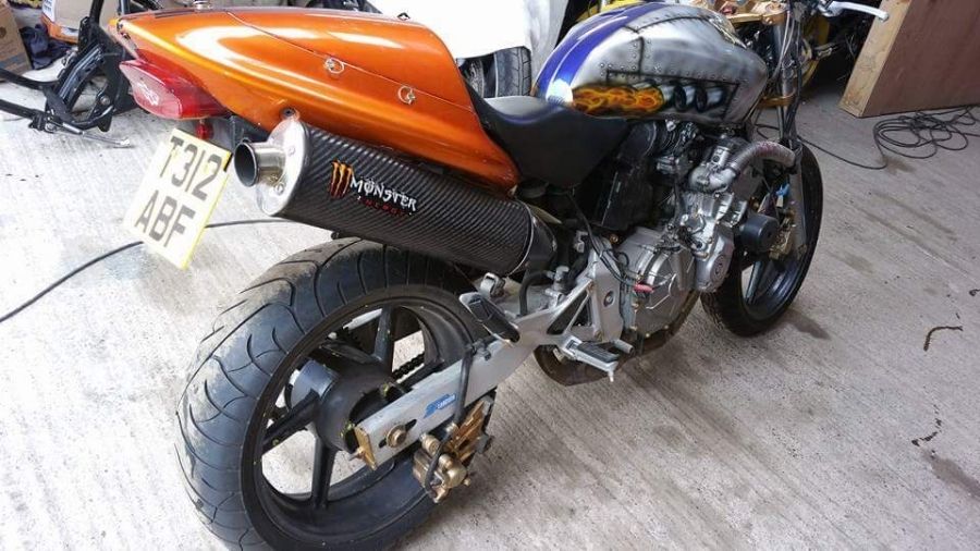

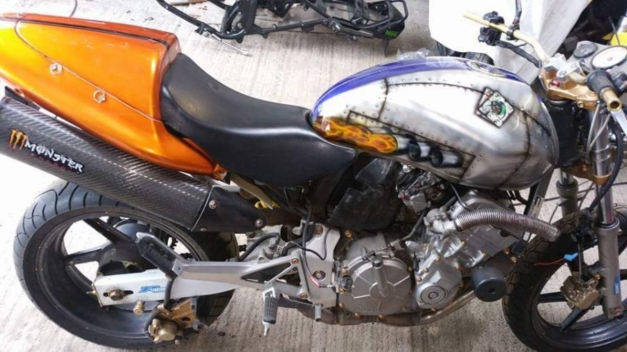

Bought this little beauty on a whim a few weeks ago.
These are the only two pictures I saw before I bought it, so a deal was struck :eek
I couldn't decide whether to break it or rebuild it as it obviously looks worse in the flesh so to speak.

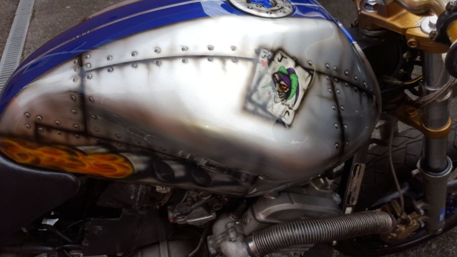

The best bit on the bike although not to my taste is the paint job on the tank.........
It looks like it may have been a track bike at some point ..................
Also looks like someone had a fetish for hand painting gold paint everywhere. just about every bolt head had been painted so I soon attacked that with a wire brush on a drill :mic

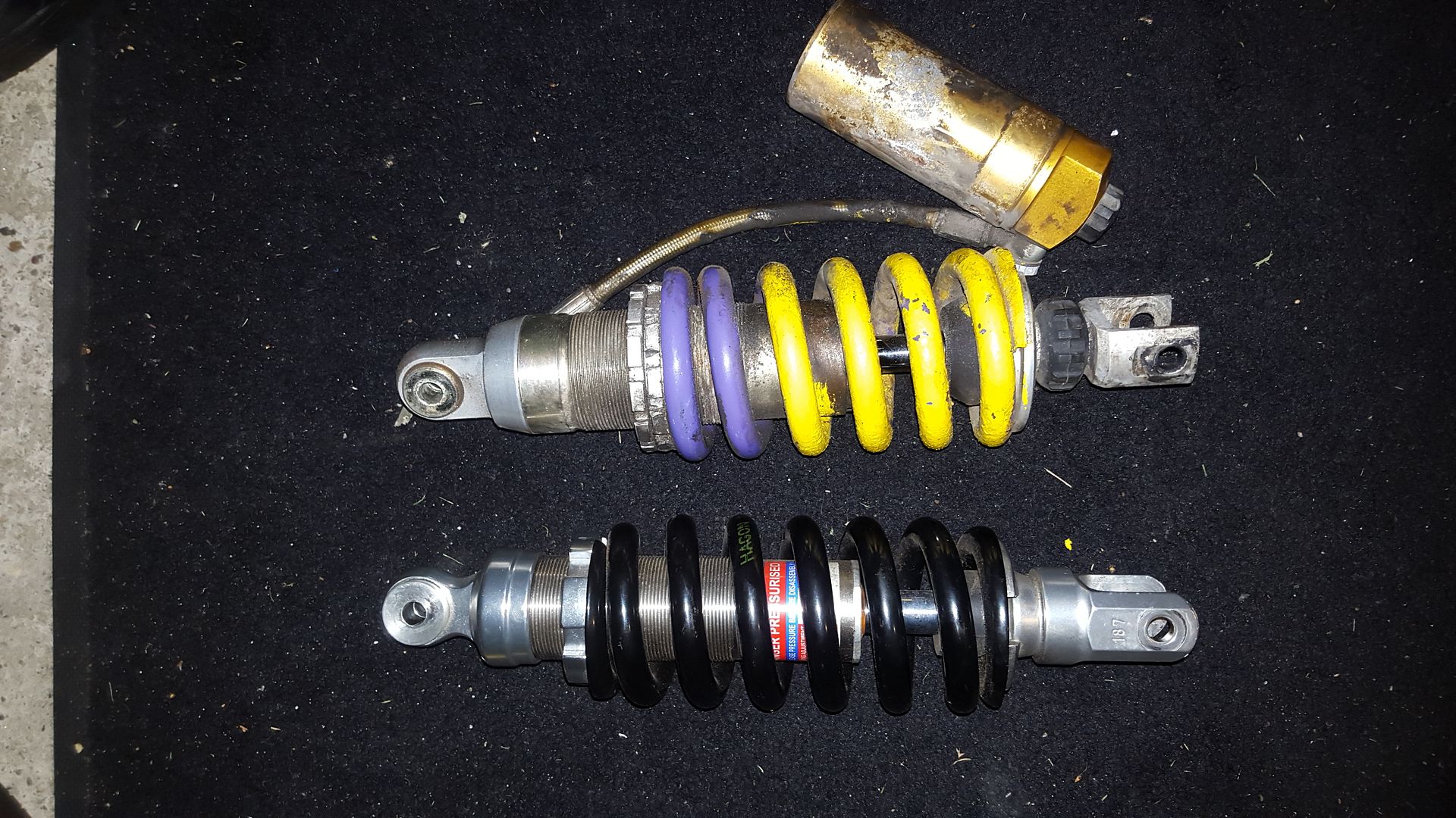

Ohlins shock that was fitted is leaking so needs a rebuild. I have already found a Hagon replacement unit for £120 delivered. Image
Ohlins shock removed........wtf! Previous owner must have been Picasso :lol
I will clean the Ohlins up a little and sell it on so by my reckoning it will pay for the Hagon unit.

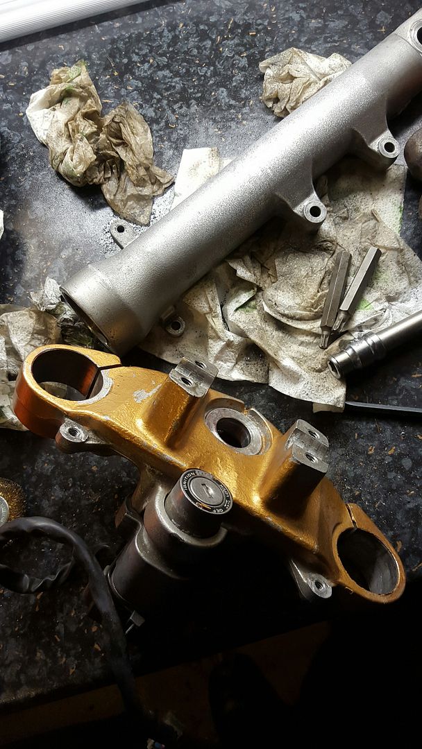

Decided to start pulling the front end off and strip down the forks.
The forks came apart nice and easy for a change!

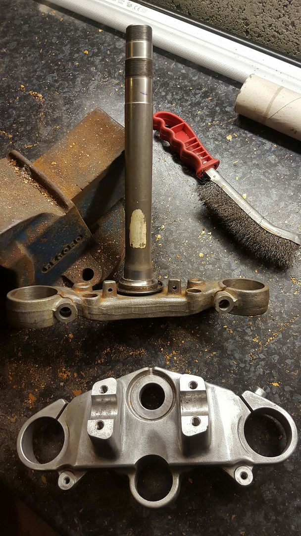

 Post Posted: Tue Oct 06, 2015 1:07 am
Gave the fork legs and yokes a clean up ready for a lick of paint.

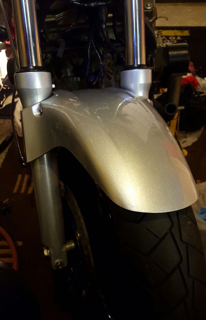

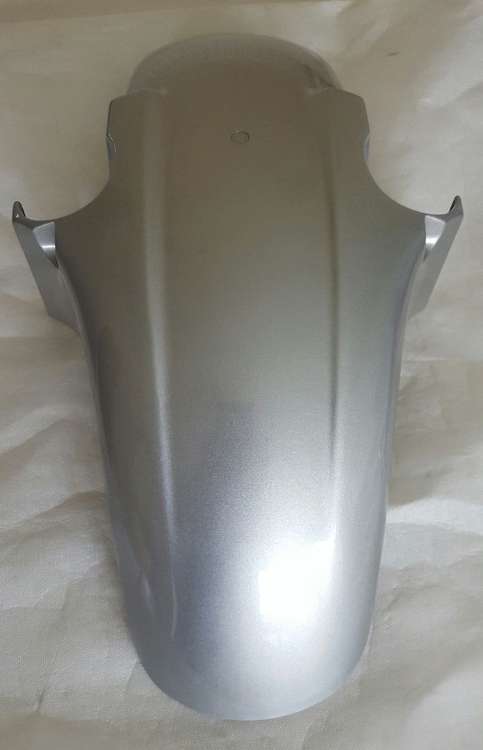

New Genuine mudguard £38 delivered from Holland. I have been looking for a reasonably priced/condition used one but some people want extortionate money for basically shite!! I found this new for less than what someone wanted for a damaged one :eek
First impressions are it's a good colour match to the silver on the tank, but I'm undecided on the final colour /paint scheme.

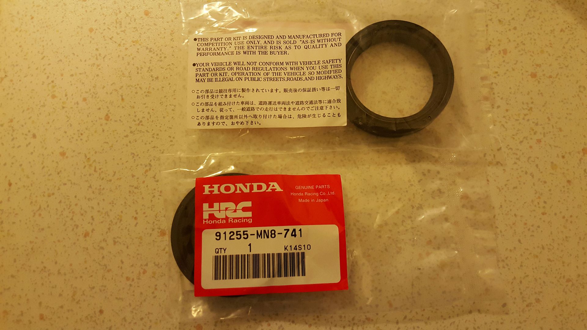

A set of go faster Hrc fork seals arrived from Dobles, £11.50 delivered.

Had to make a spacer for the new Hagon shock as for some reason the Ohlins shock spacer is to big for it. I just so happened to have a spare gudgeon pin that was off my 900 that is exactly the same diameter. A little bit of magic with the grinder and...............
I could of ground the original down but that will stay with the Ohlins.

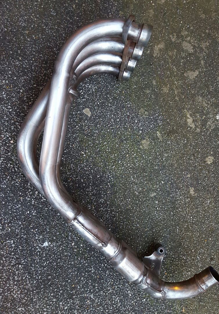

 Post Posted: Mon Oct 12, 2015 1:53 am

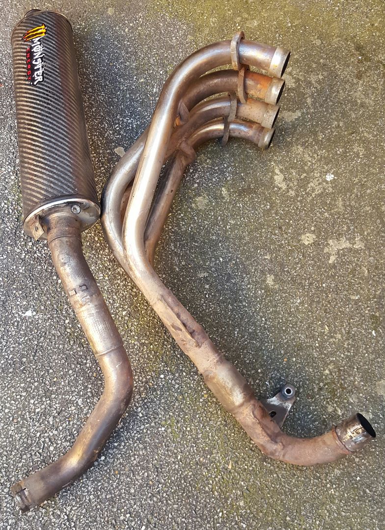

Removed the exhaust, I was very surprised that none of the nuts/studs were seized..............
Gave it a little bit of a clean up..............
Good enough for this project me thinks.

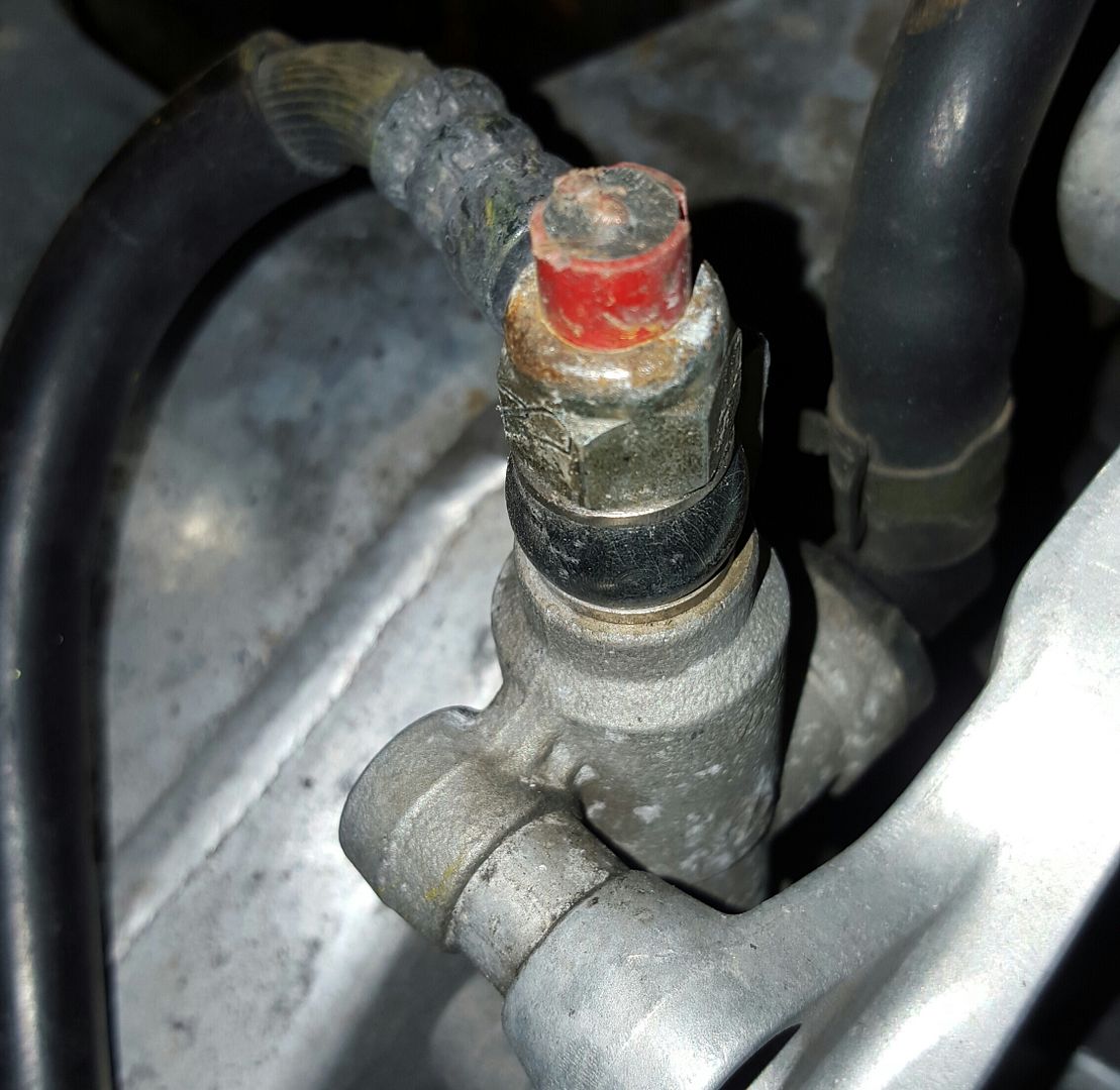

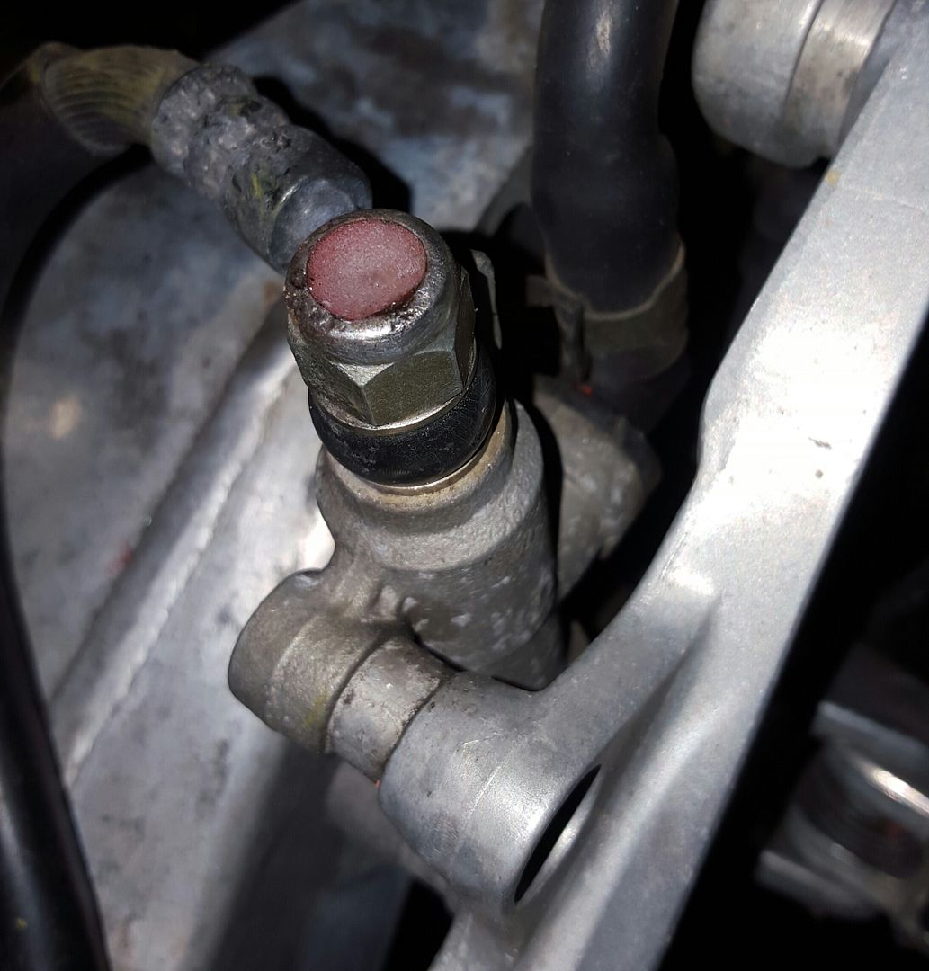

The bike is fitted with a standard brake light switch but it looks like it's still got the remnants of an old banjo switch................
I've probably got a spare banjo bolt in my box of bolts somewhere but thought I would just see if I could tart it up a little without removing it. I took a drill bit and drilled into it about 3mm or so. Mixed some bodgers glue (Araldite) and filled it with the epoxy resin.............
The colour should change a little once it's cured, only took a couple of minutes to do so I'm happy with that .......job done.
I will be removing it later as I will be cleaning the arse end up a little later.

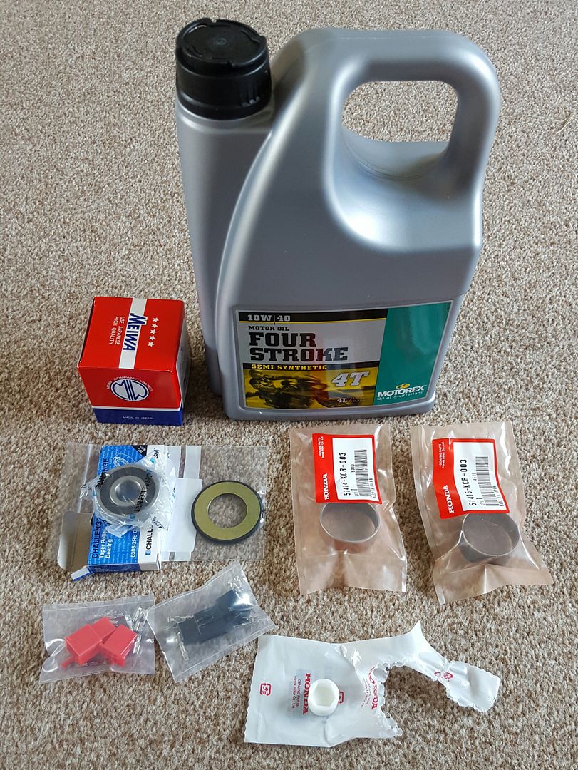

Just waiting for a few parts to arrive before I do anymore of the build. Parts on order..........
Radiator & fan switch.
Fork bushes.
Wheel bearings.
Speedo drive plastic joint.
Oil & filter.
Lower yoke dust seal.
Electrical connectors.
While I'm waiting for parts there will be another interlude.....
 Post subject: Re: Project.......Joker

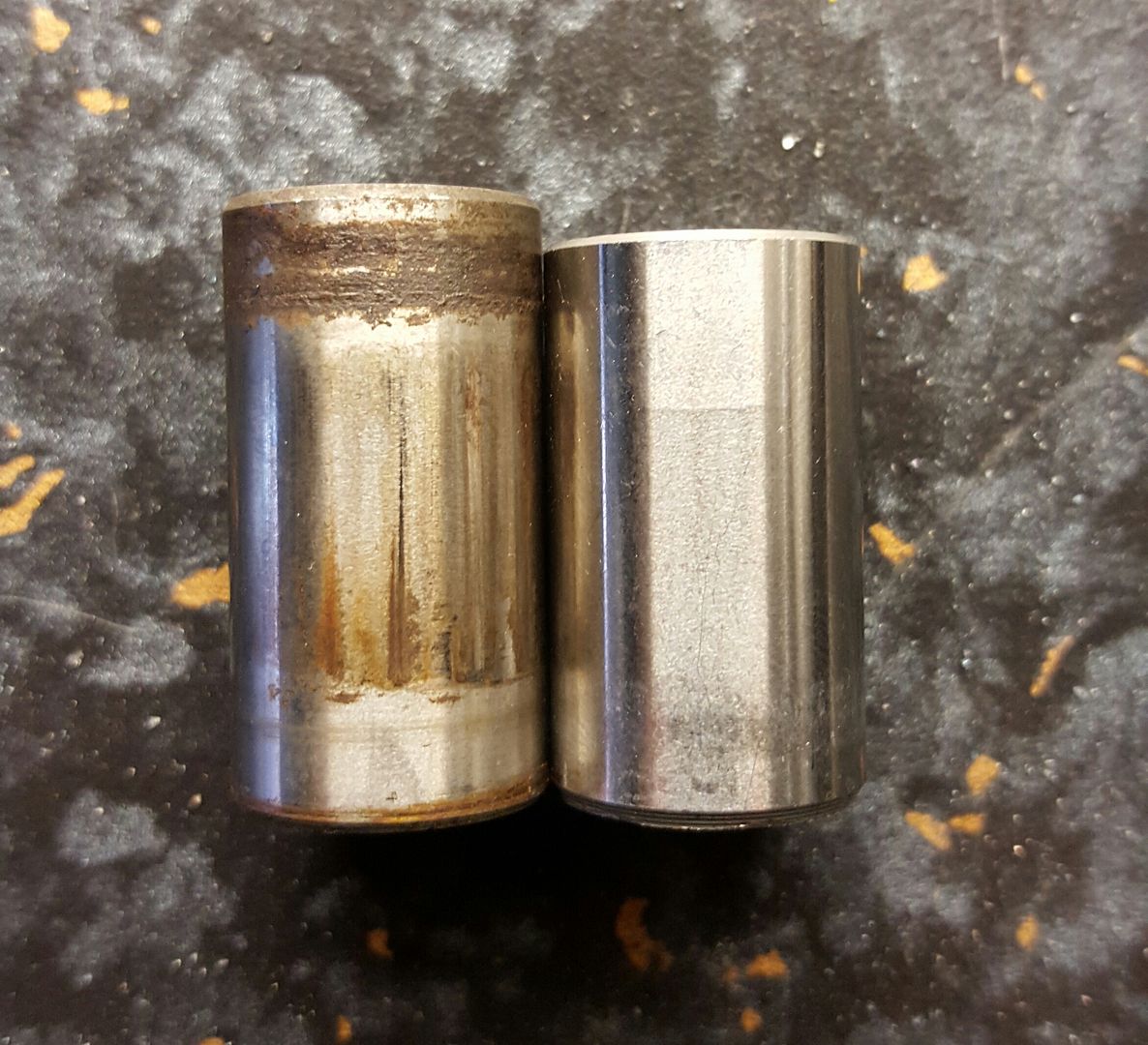

 Post Posted: Tue Oct 13, 2015 9:28 pm
£61 of parts arrived from David Silver spares. The genuine fork bushes were cheaper than pattern aftermarket parts! It does pay to shop around.
Top of the range from eBay :p rear wheel bearings £3.90 a pair delivered!
2 x 6 way connectors £4.80
All were next day delivery so top marks to the seller's.

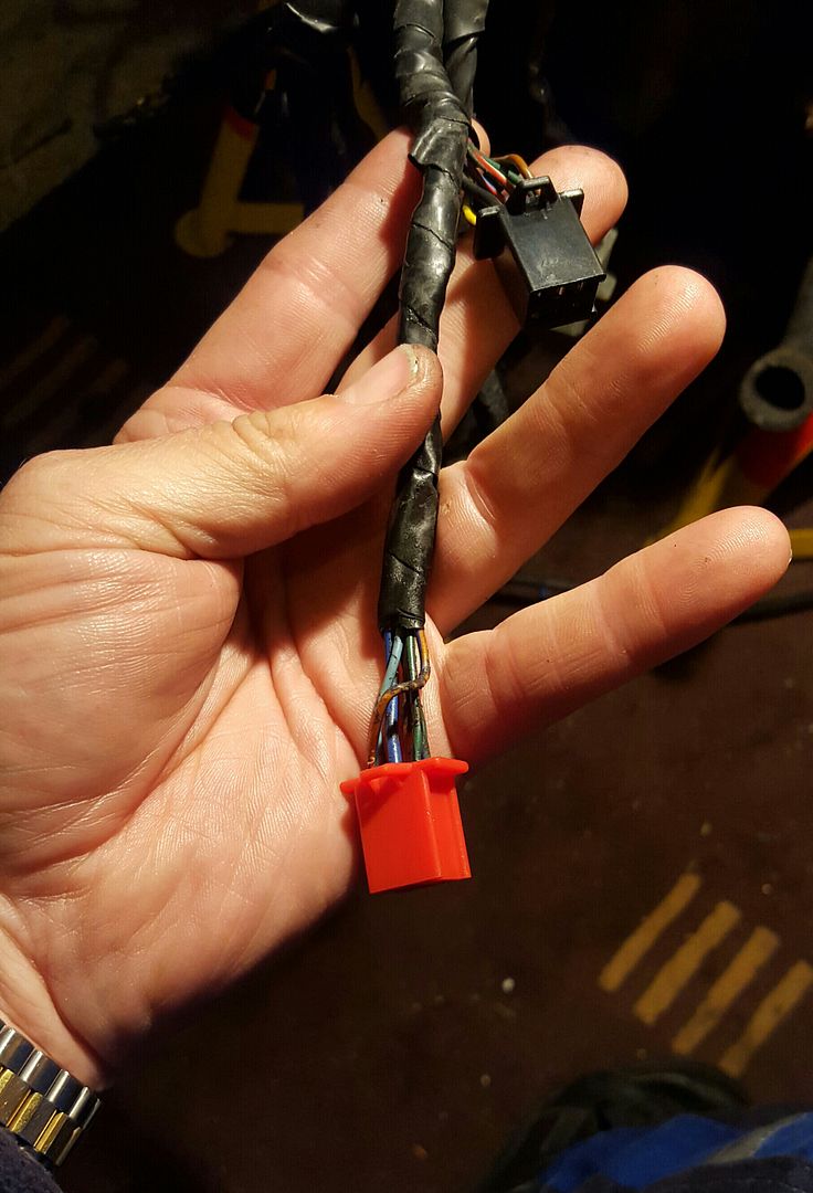

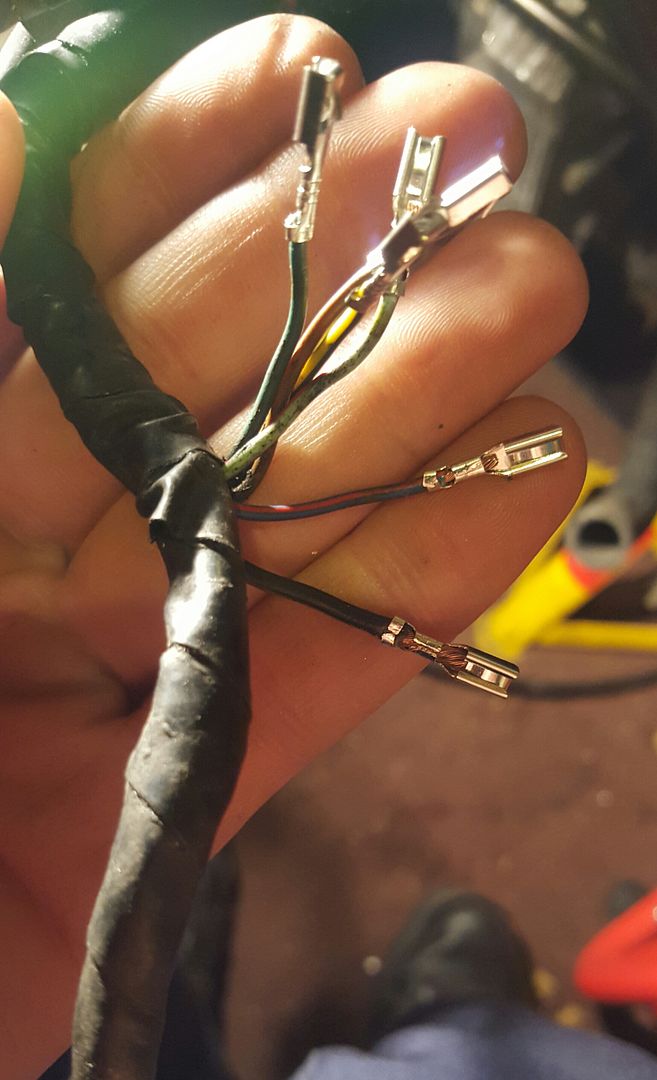

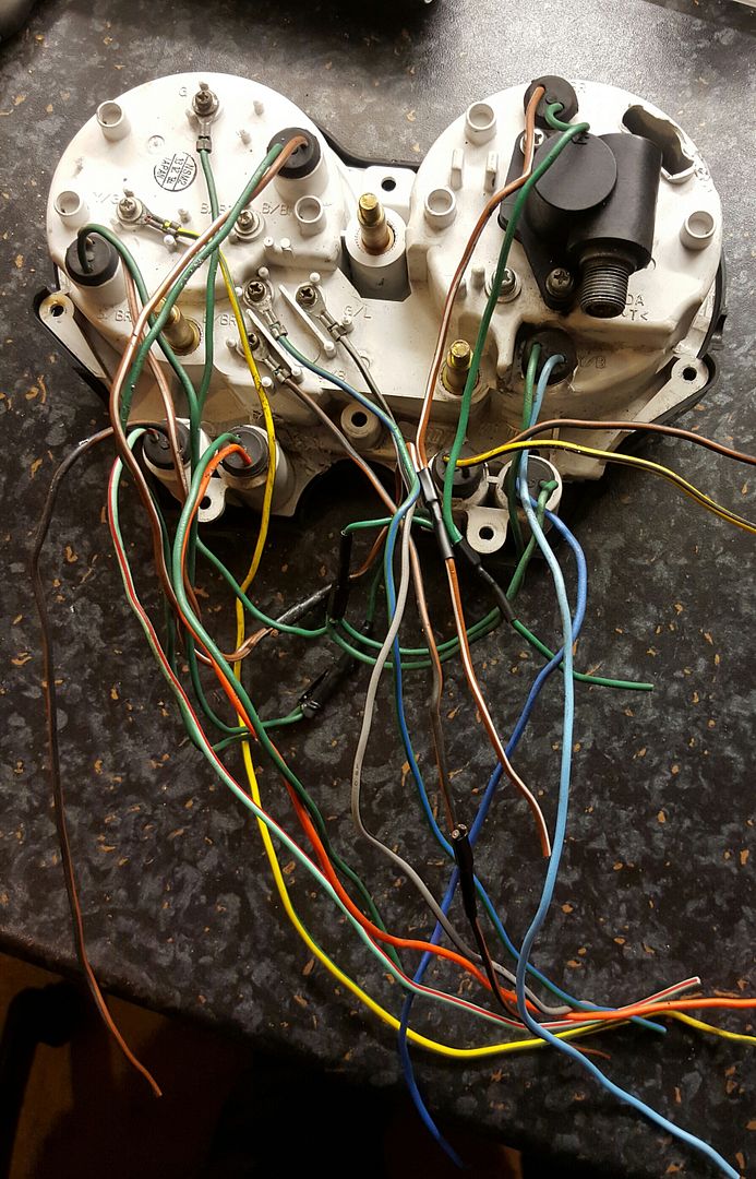

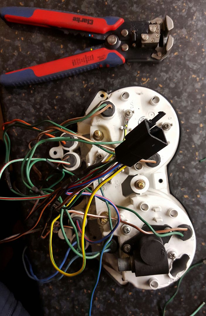

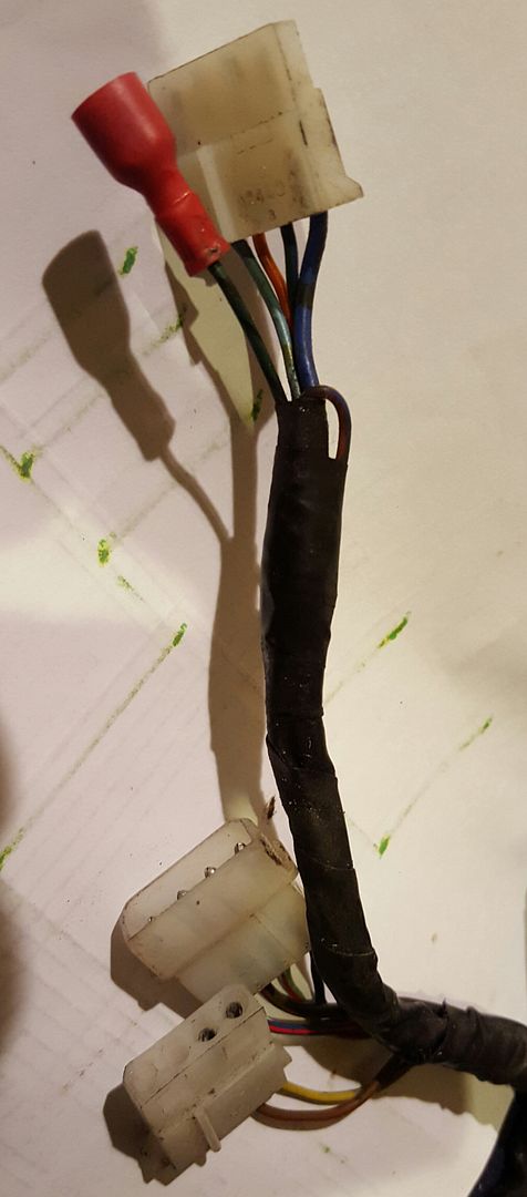

Not much spare time at the moment but managed to make a start rewiring the main loom clock connectors.
The main wiring loom had the original connectors changed so I chopped these off and crimped some original type ones back on.
Once the original type connectors were put back on I turned my attention to modifying a vfr750 clock loom to fit the 600 clocks.
A little bit of head scratching, soldering and crimping and it's halfway there.
For some reason Honda decided to used two different size push in bulbs on the clocks so I had to carefully drill out the plastic clock socket to ensure a snug fit.

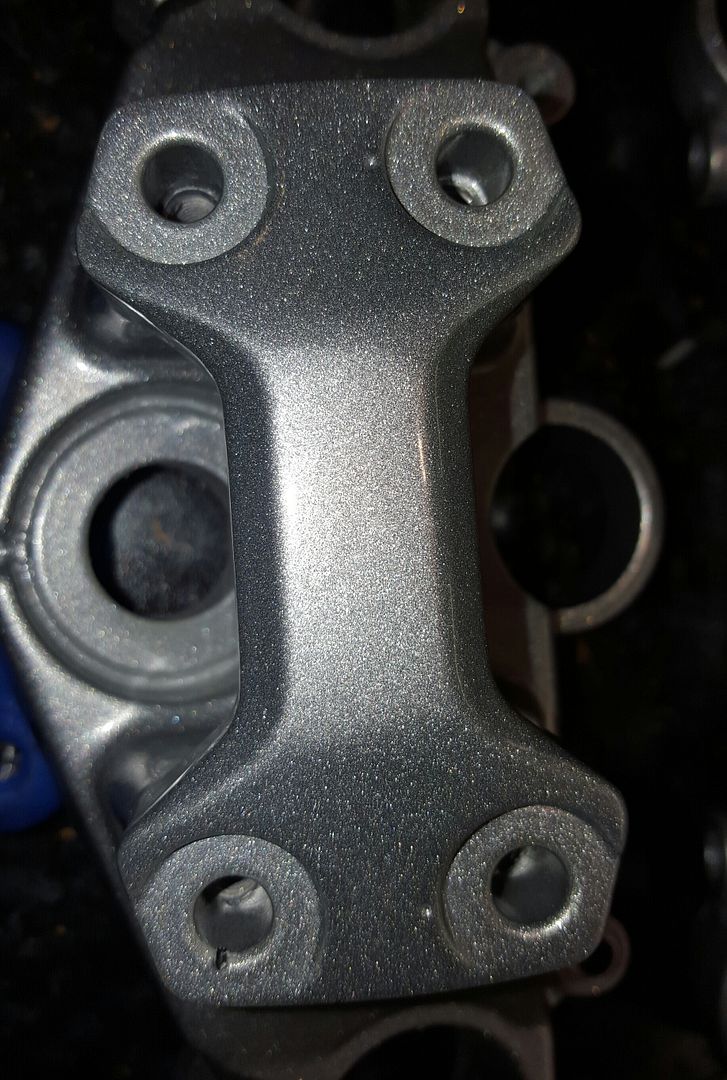

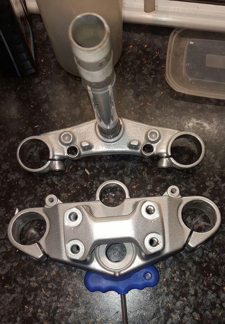

Popped out this morning before work to pick up the parts that I've had powder coated.
Sparkling silver handlebar clamp.
Sparkling top yoke.
Yoke top and bottom.
Credit where it's due, the power coating I've had done is probably the best they have done for me and looks excellent close up........but fugging hell what a barsteward the masking tape was to remove!!

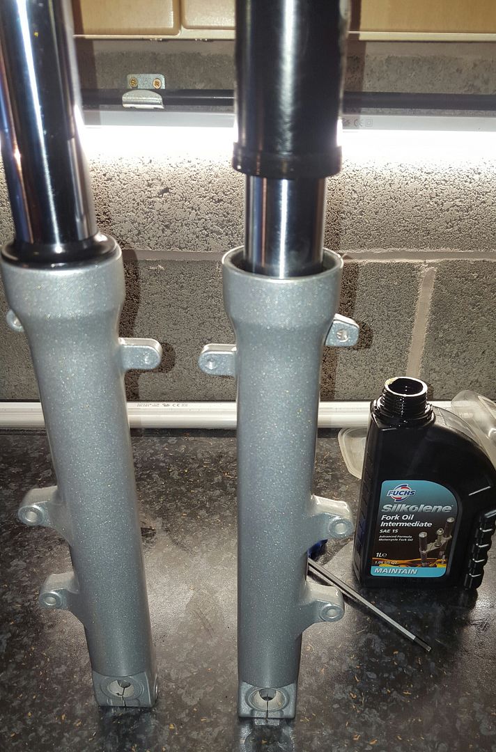

Managed to get the forks rebuilt with new bushes and seals.
The fork on the right has a 43mm bit of plastic waste pipe and the old fork seal that I used as a fork seal driver. It does the job a treat :D

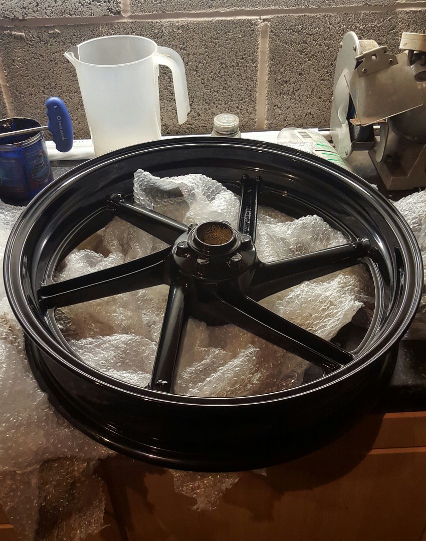

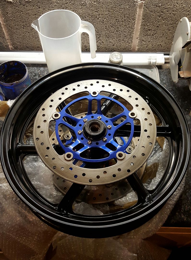

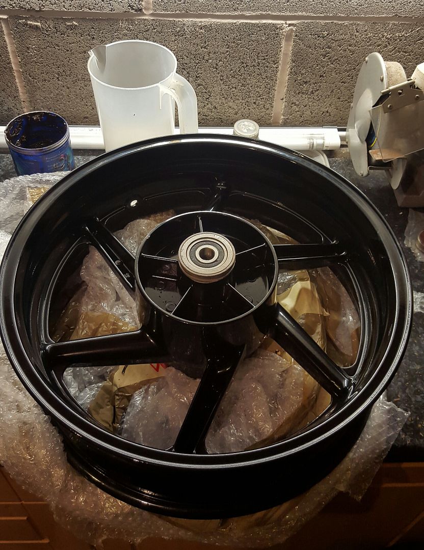

Wheels done in gloss black........
Front wheel.
Front wheel rebuilt with bearings, discs and stainless bolts.
Rear wheel built with new bearings.
And that boys and girls concludes tonight's exciting episode, do sleep well and tune in tomorrow.................

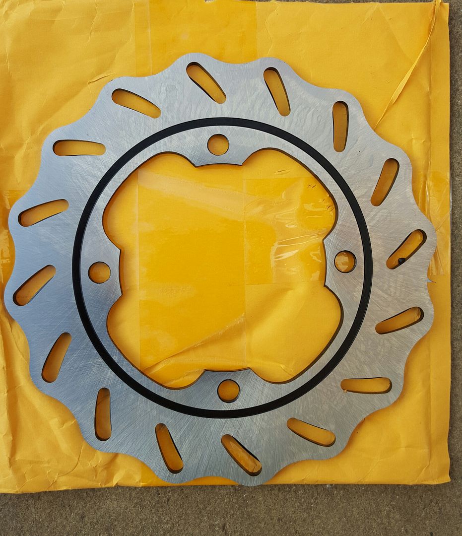

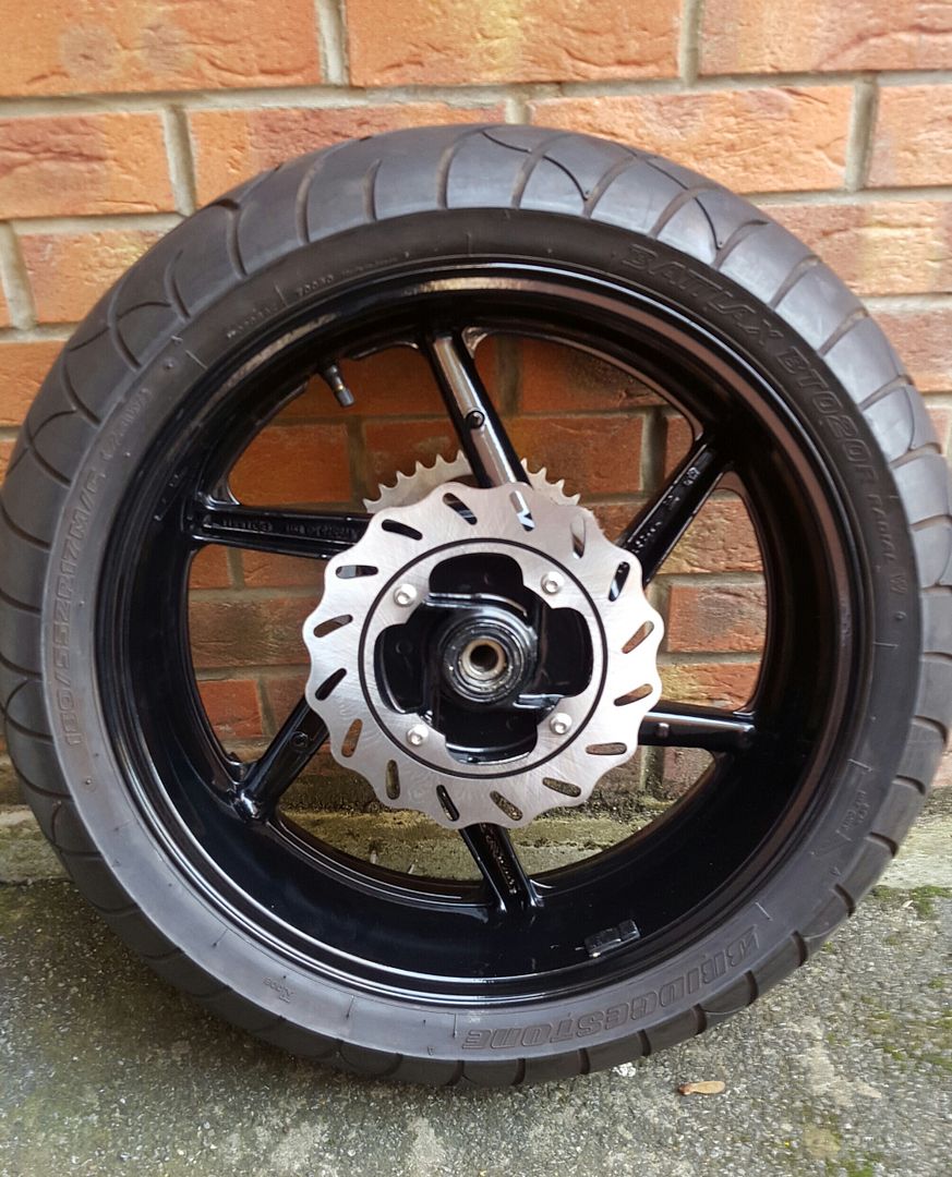

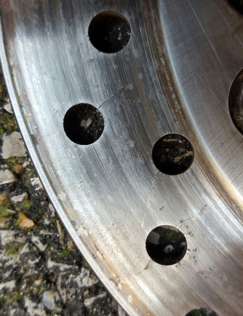

A little bit of an update. I noticed on close inspection that the rear disc I purchased had quite a few cracks!!
A bit of a bugger as I have already left good feedback :Bang
I have already purchased a brand new cheap replacement for £18.99 delivered.
 Post Posted: Sun Oct 25, 2015 4:15 pm

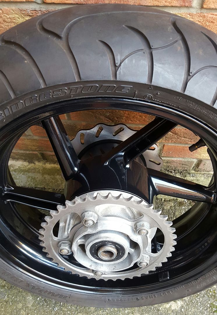

A cheap new replacement disc must be safer than a cracked old disc i say.
Managed to get it fitted to the wheel with new stainless bolts.
All clean and shiny. I don't usually fit old tyres to freshly coated wheels but these have loads of tread left so they went back on.
I don't think the chain and sprockets have had much use as the renthal rear sprocket looks quite new.

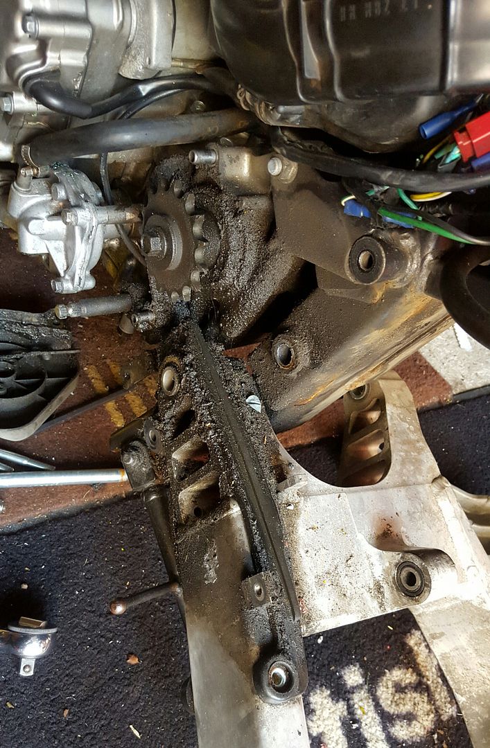

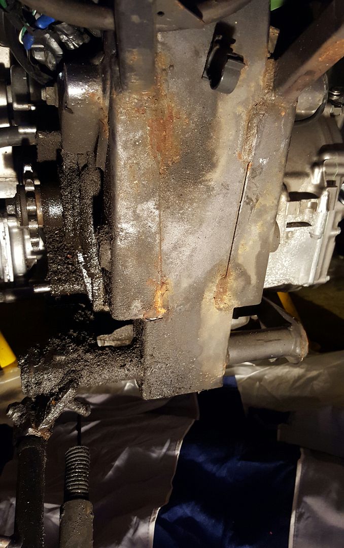

With the bearings removed from the Swinger and the footrests stripped of all the associated s hite I popped them to the powder coaters this morning.

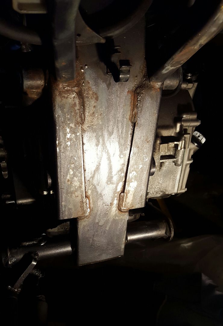

Frame looks a bit grotty back here so i made a bit of a start cleaning and prepping for paint.
Attacked the sprocket side with some Jizer and a paint brush so looks a little cleaner. Not sure if the gear shift lever seal has been weaping oil so for the sake of £1.99 delivered I have decided to change it.

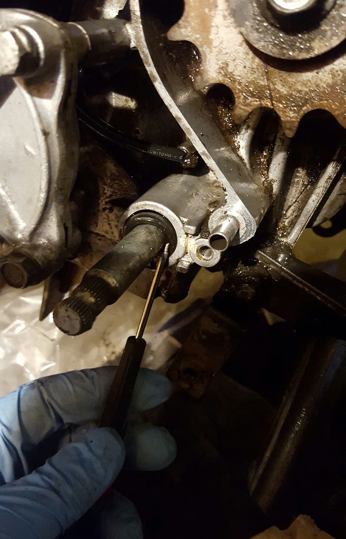

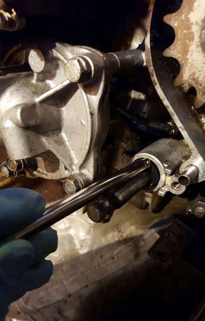

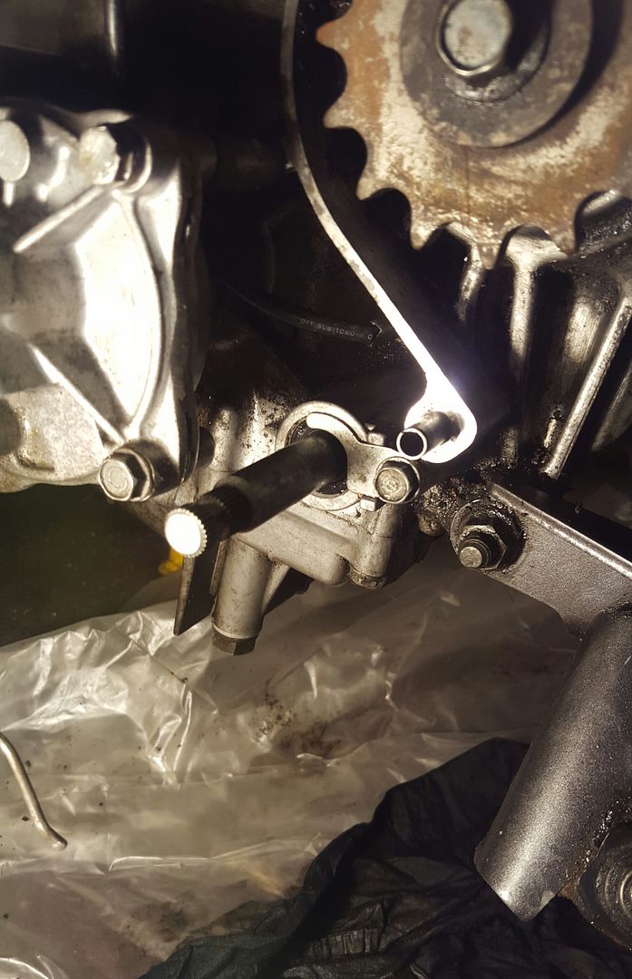

Right then boys and girls this is easy peasy to do...........
With the 10 mm m6 bolt and retainer removed get a pick or a small screwdriver and prise the seal out.
Wipe away any oil or crap, smear a little new oil on seal and gear lever shaft.
Slide the new seal then the old seal over the shaft and gently tap the old seal so it pushes the new seal home.
Refit the retainer and 10 mm m6 bolt.
Sit back and open a cold one!
And that boys and girls concludes this evenings lesson :mic

Hey. Enjoying the thread. Very satisfying seeing many grubby things put right.
One question though - What is going on with the tank? If it was me I would sell it and get a clean stock one but that's just my taste.

It's nice to watch your progress but you're making me feel bad for not getting on with mine.
One tip I was given for installing new gear shift shaft seals was to put a small patch of cling film over the splines before pushing on the new seal. The cling film is supposed to protect the seal from the sharp edges of the splines. :)
