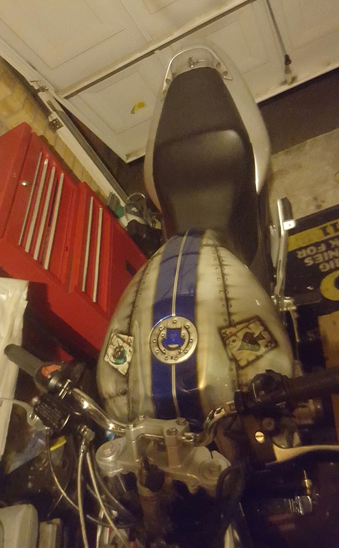

The tank paintwork is absolutely immaculate, it's not to everyone's taste I know but it's a shame to change it that's why I'm sticking to a similar theme.

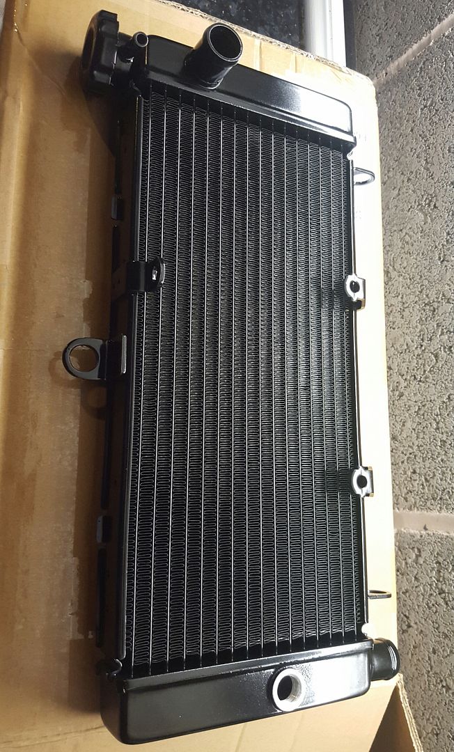

After waiting over a month for a radiator to come from the land of the cheap and nasty I have now had my money refunded :mic

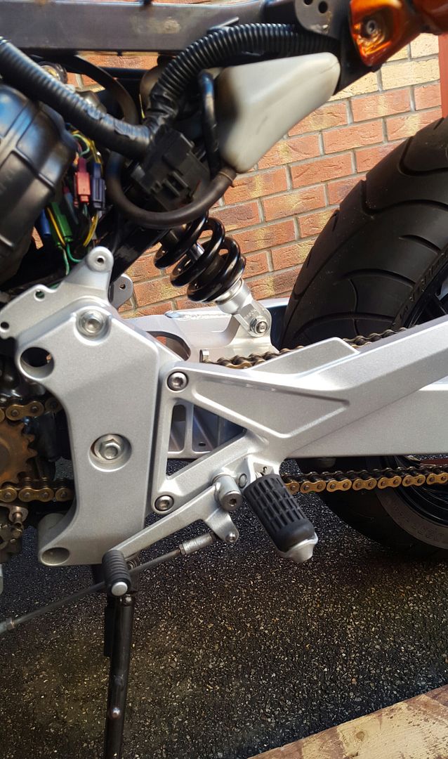

Side plates and rear brake hanger

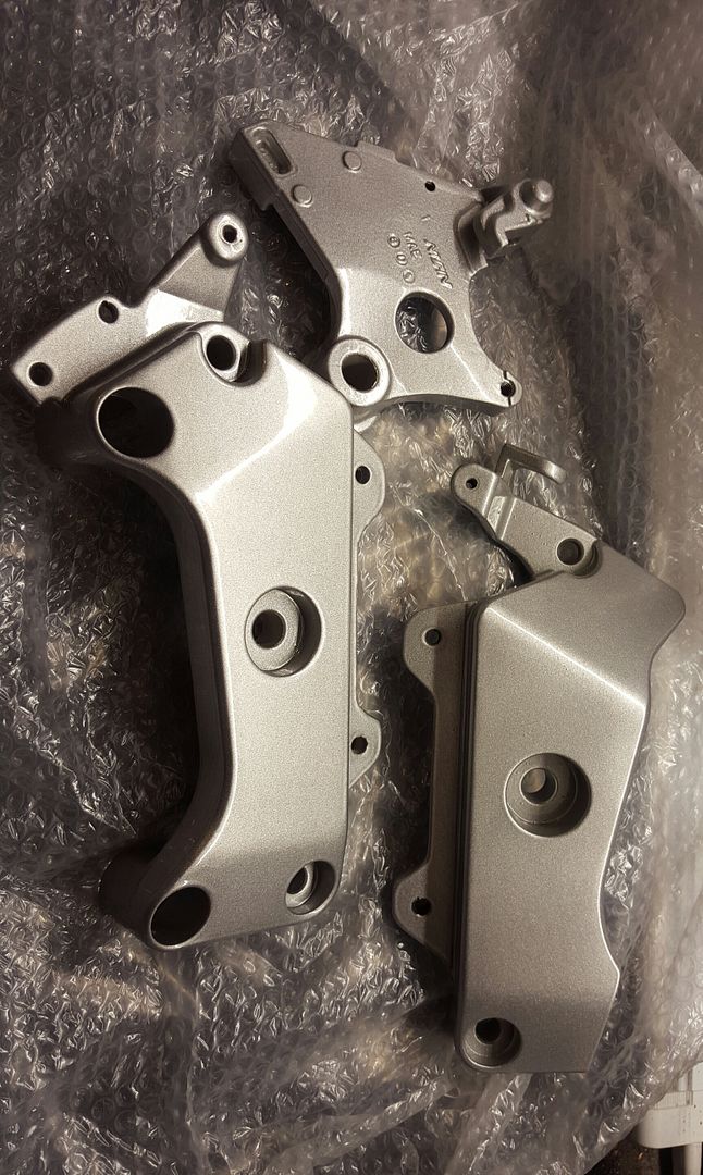

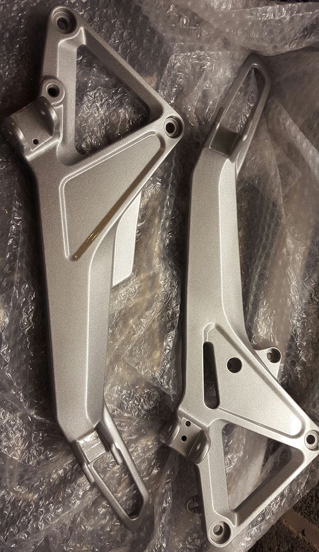

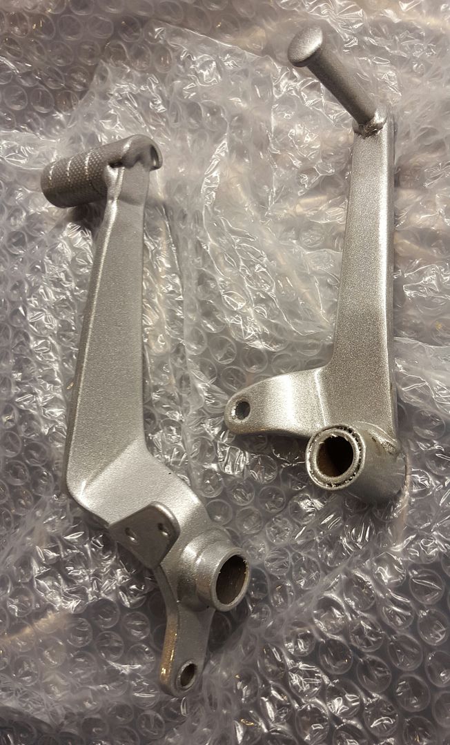

Levers and footrest brackets........

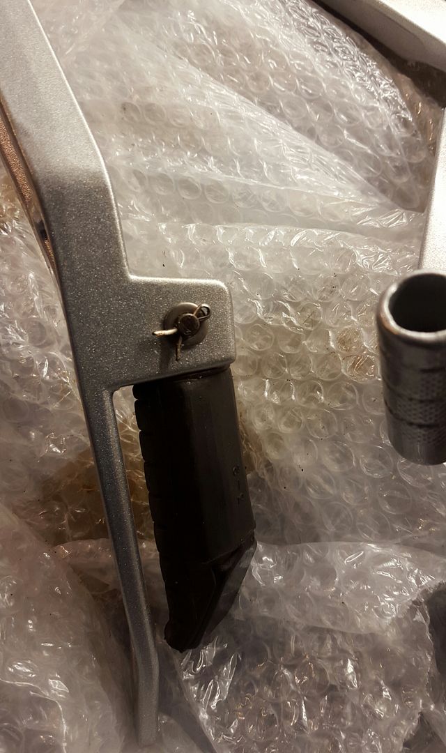

Made a start rebuilding the footrests with top of the range stainless steel split pins and washers at no cost!!

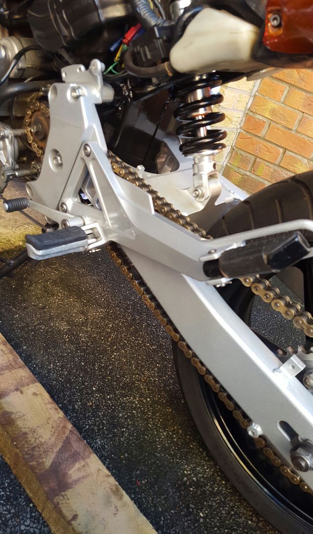

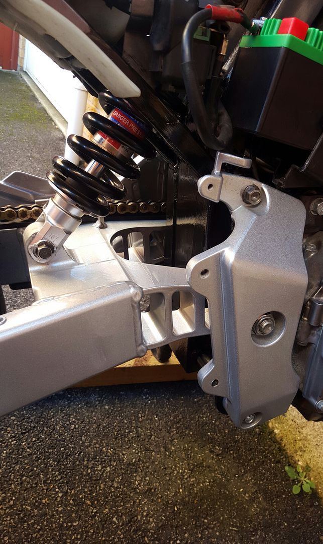

That said so on with bolting parts back on. Image

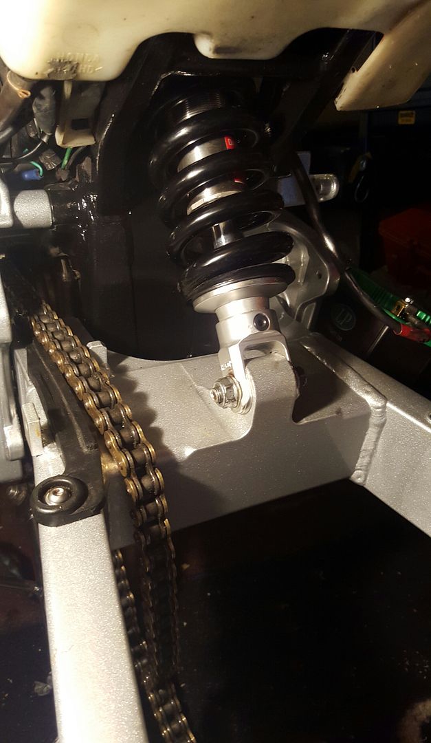

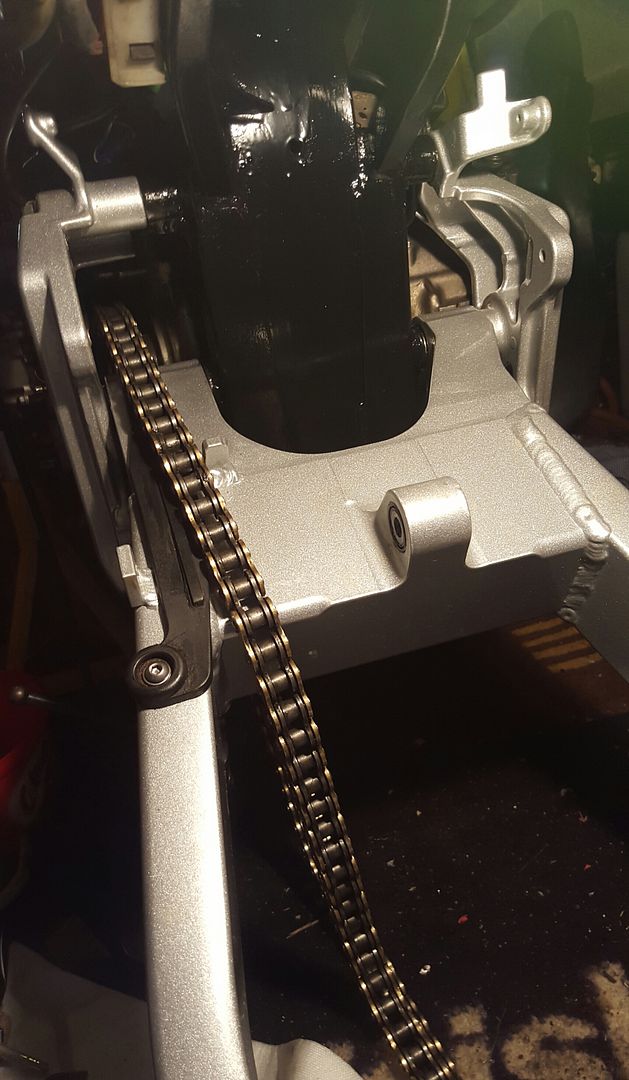

Swingarm, chain and side plates.
Some would say this build is shock in!
Another shock in picture...........so time for a rest 8o

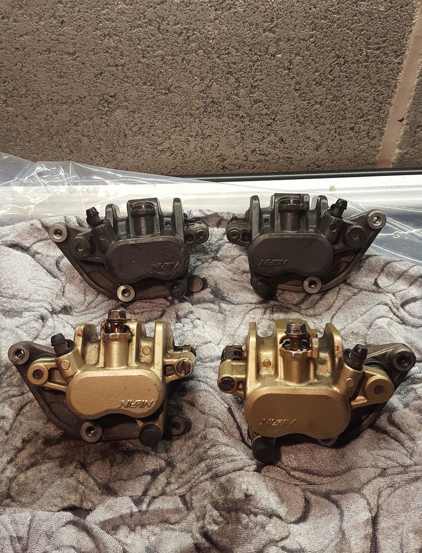

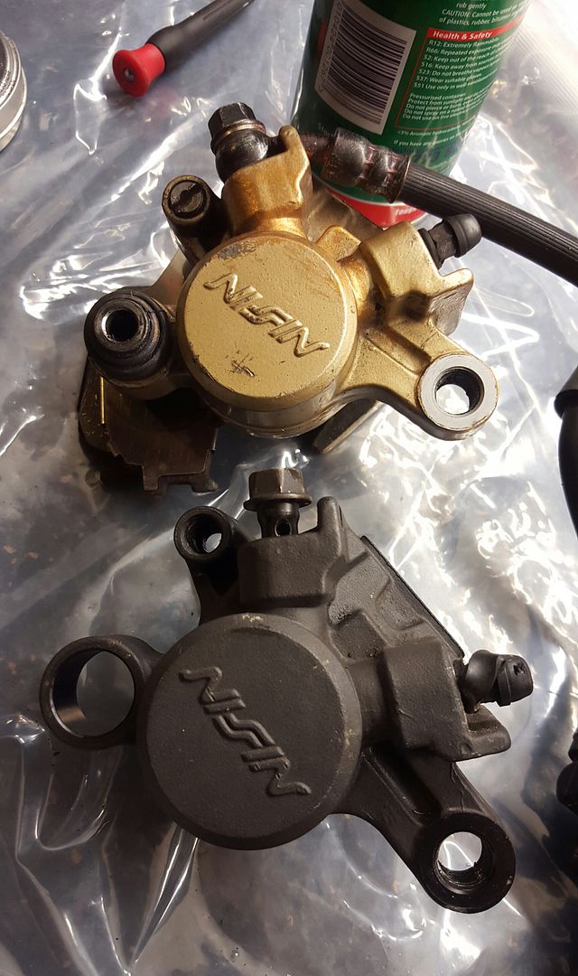

................. A brake caliper or two!

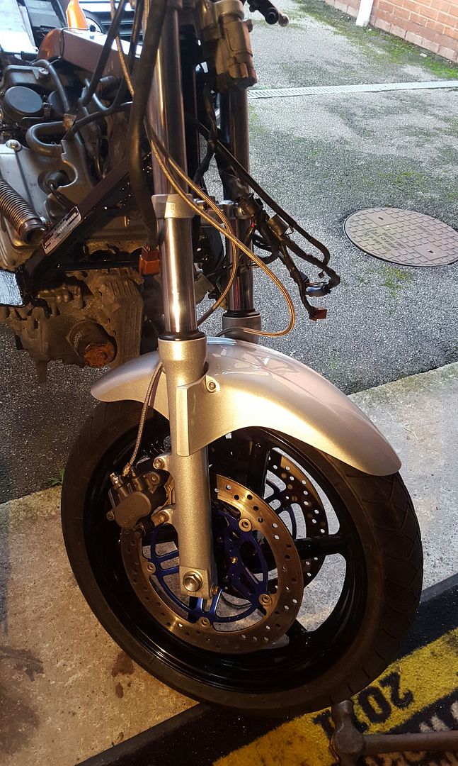

But what about the front? I hear you say..........

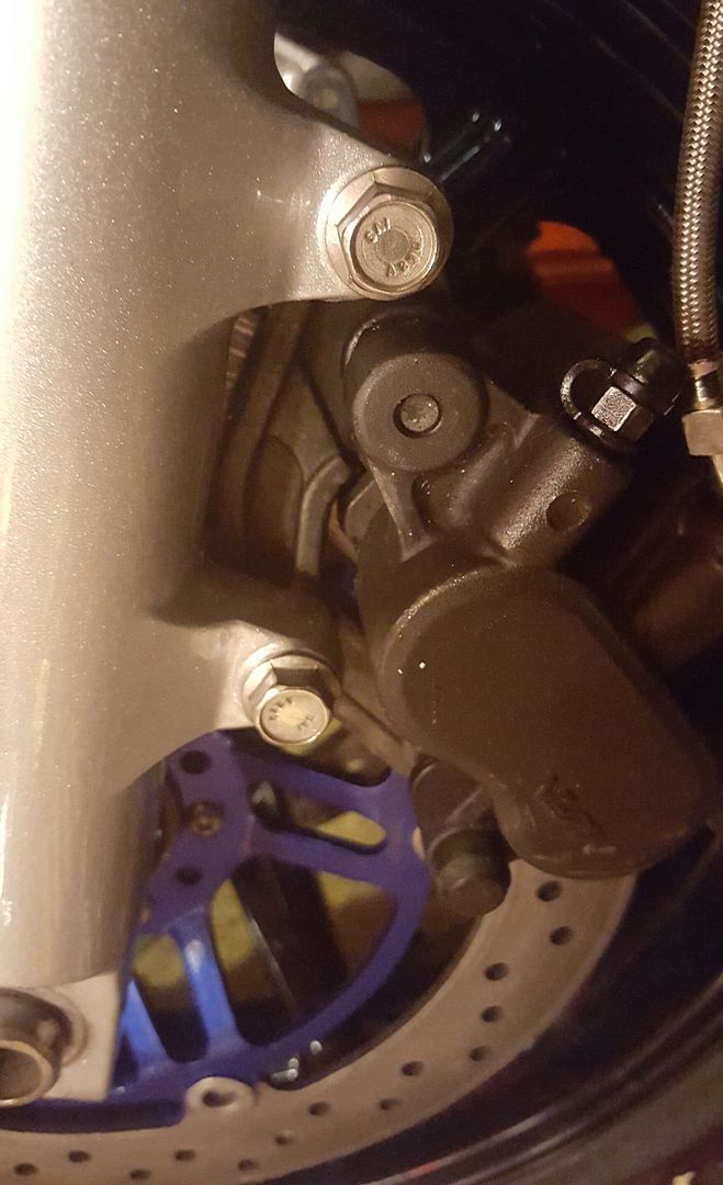

I have decided to change the calipers for the black ones as these are in better shape than the gold ones. These came in a box of parts I paid £50 for.

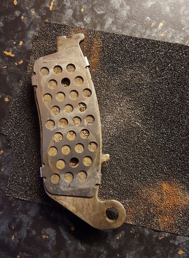

Not knowing which pads fit which disc I decided to re-face them.
This looks like emery cloth but is actually grip tape as it's sticky on one side. I stuck it to the worktop and sanded a couple of thousand miles off them I should think :p
The top pad has been sanded and looks like a new pad now.
Front end and calipers fitted.........

I have ordered another new radiator from China, hopefully this one will turn up :Pray I have also ordered some new brake caliper bolts but in the meantime I decided to bleed the bleeding brakes. Whilst bleeding the brakes I noticed that the fluid that came back up to the master cylinder looked really manky!!

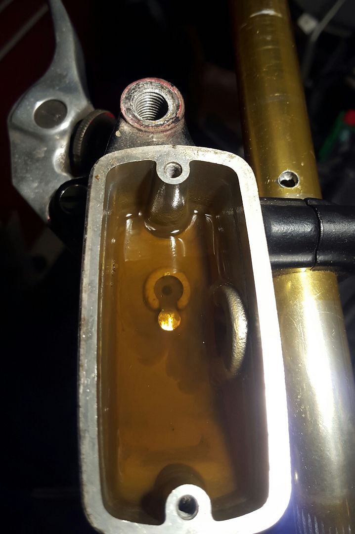

Check out the dark area at the bottom. I decided to completely drain all the fluid and start again as it was just brown sludge at the bottom! ! The brake lever now feels firmer than a nob on viagra :eek

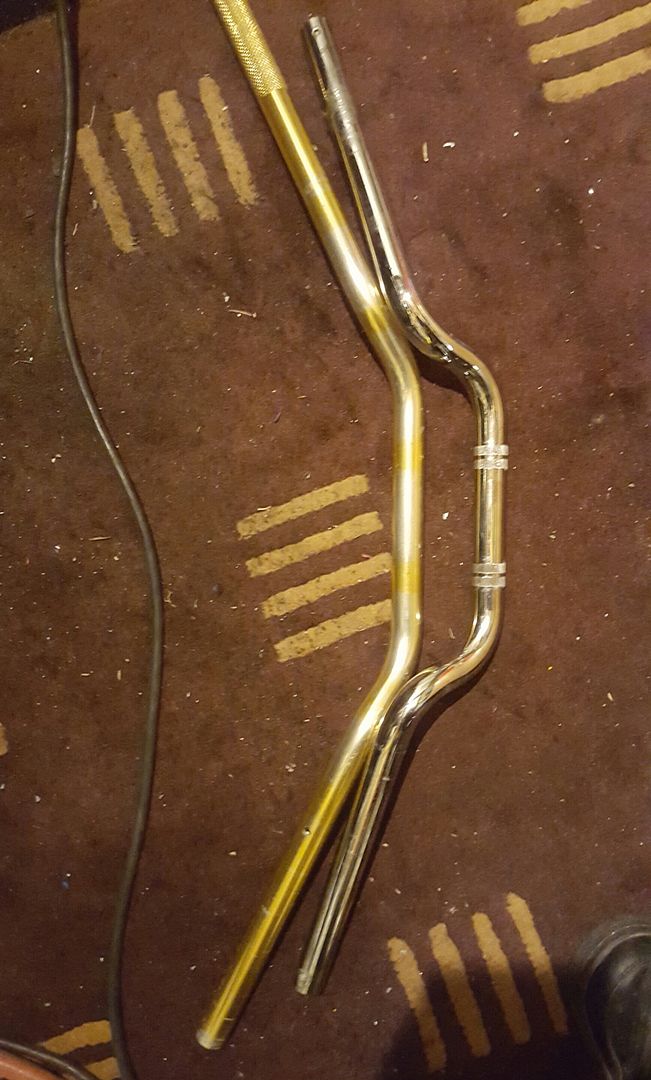

If you notice the gold handlebars they have seen better days as the anodizing has faded in places but it just so happens that I have another set of bars in my spares box.

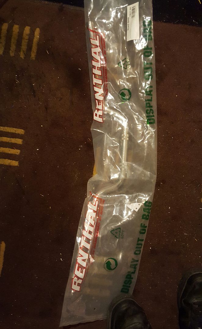

I wonder what is in the renthal bag?
If you guessed it is another set of renthal bars then you are wrong! !
These are in fact a spare set of standard bars that came with a 59 plate 600 I bought a while ago.

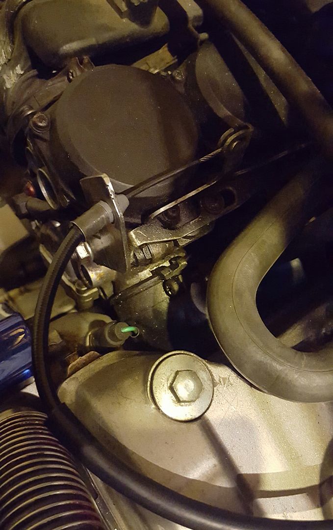

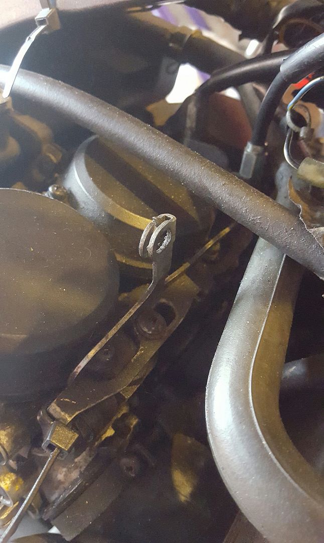

Apparently this 600 has cbr600f3 carbs according to 370steve and whoever owned it before me had not connected up the choke cable as the carbs are missing a bracket!
Check out the cable tie attached to the choke slider......well that's one way to get the choke on :lol

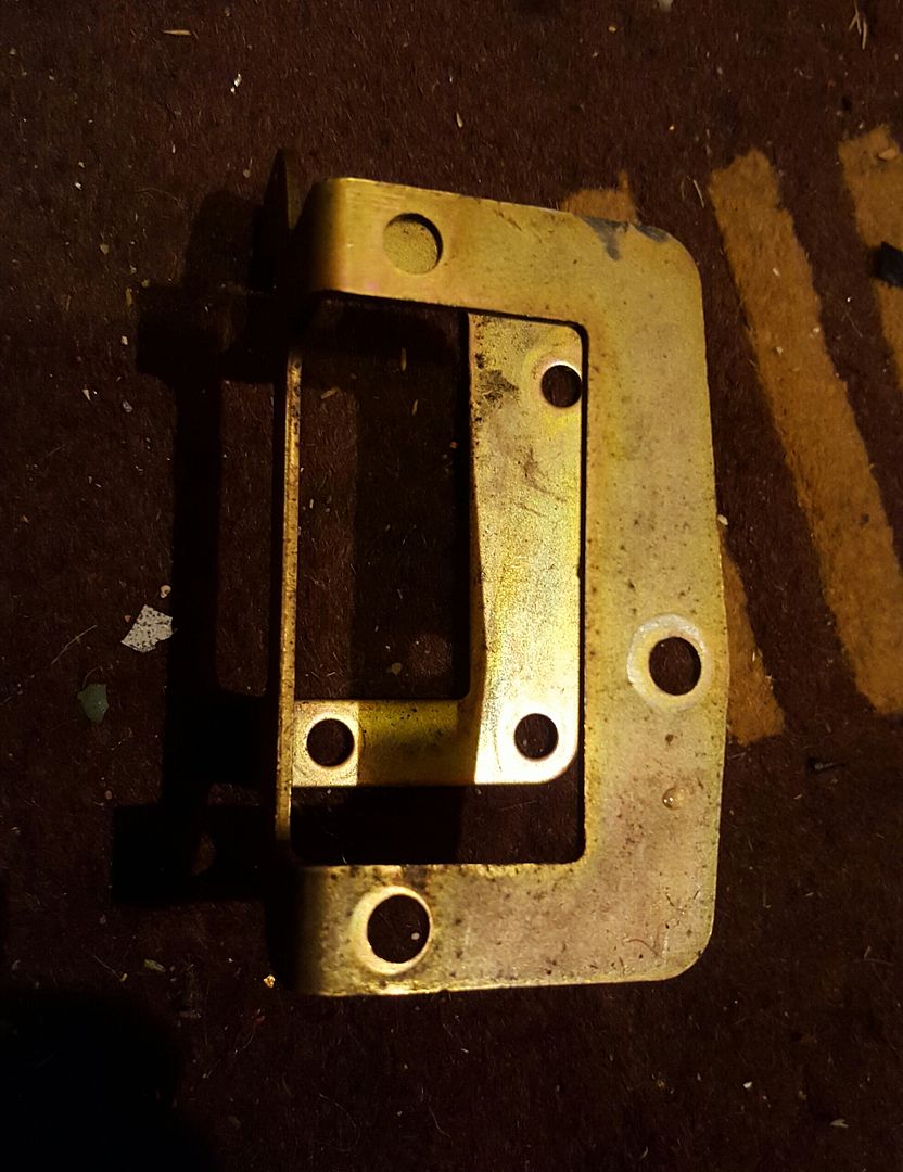

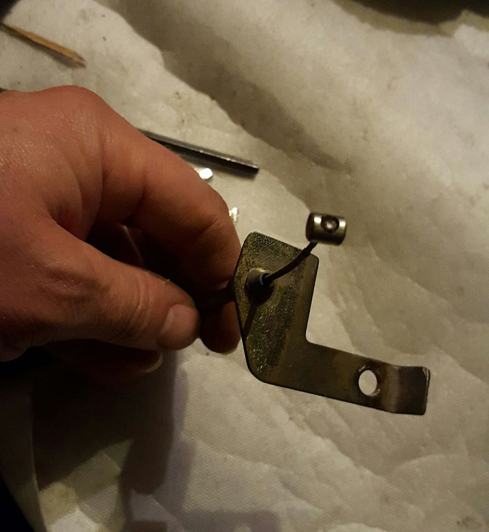

Had a look in my spares box and found this bracket...............
It's a coil bracket........I attacked it 370steve style with a hacksaw, drill and a file.

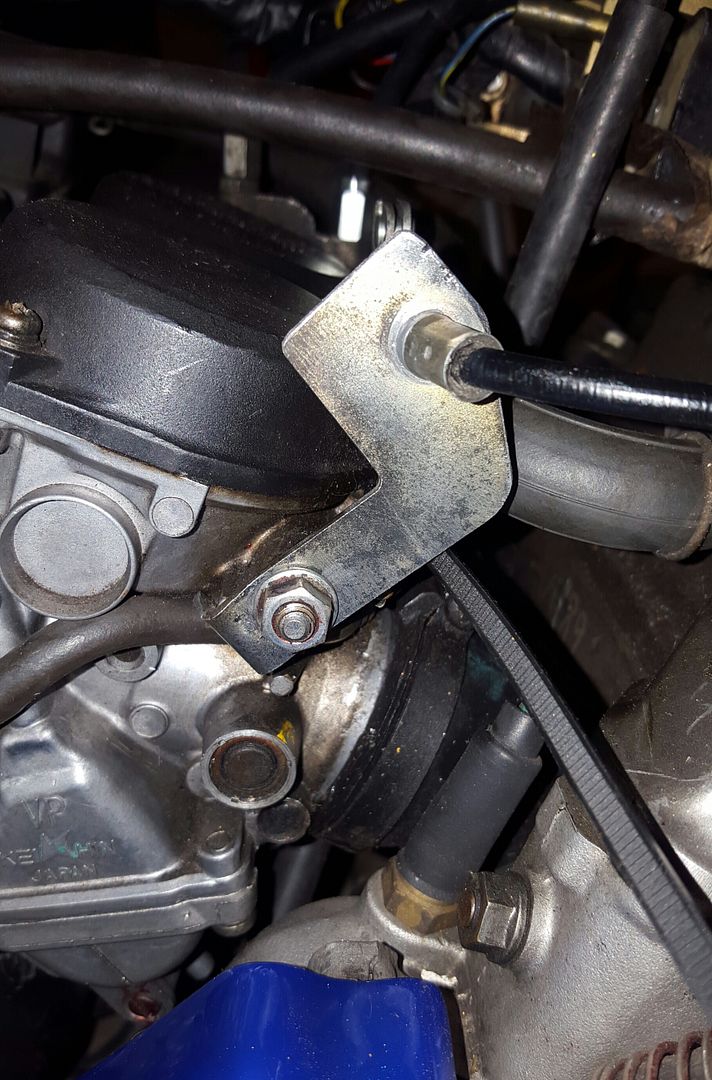

Bolted it on for a trial fit...........
Works a treat so just needs a lick of paint to finish.
dont knock it!! thats how the CBR carbs choke worked on my track hornet :angel

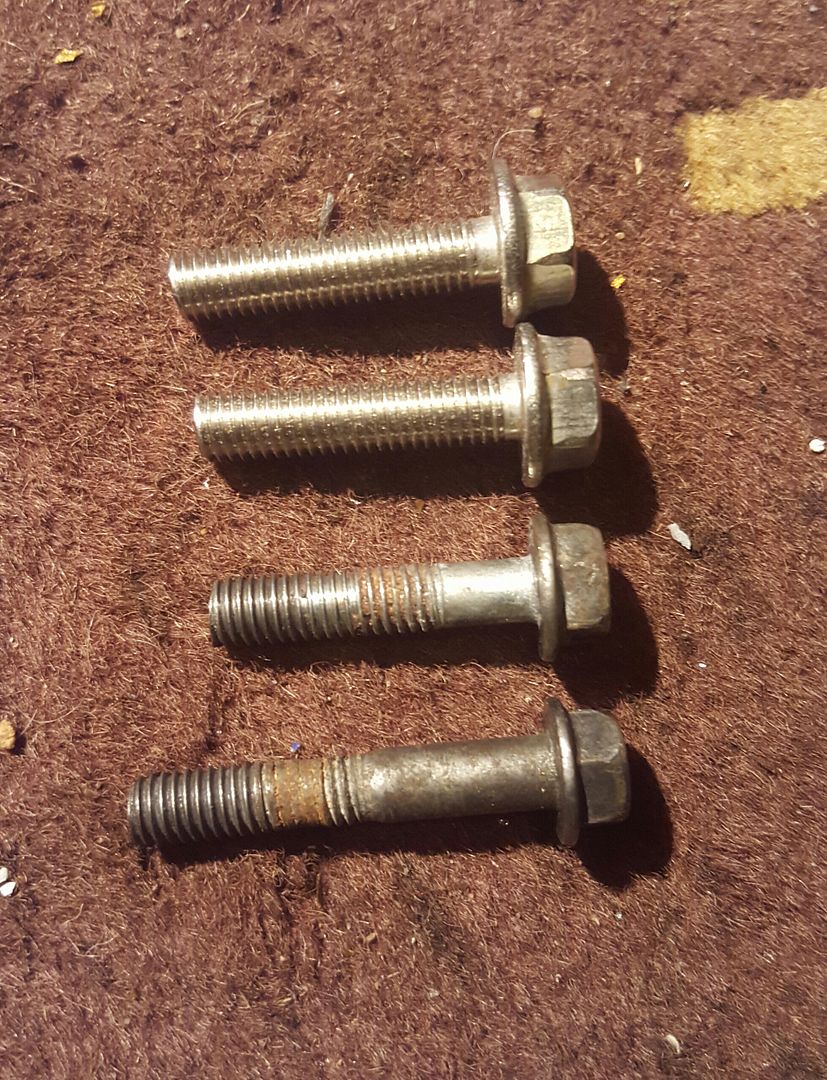

The brake caliper bolts I ordered turned up or to put it another way......the m8 x 35mm flanged stainless bolts I ordered arrived :mic The original size bolts are m8 x 32mm so the new ones are a nats cock to big. Two options, grind/cut them down or use a washer to pack it out enough so it doesn't catch on the brake disc bobbins.
Looks like someone has used longer bolts previously. New top of the range bolts were £3.55 for 10 delivered ..........always handy to have a few extra!

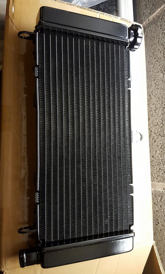

Had a busy day today. Started early running around for some bits for the conservatory then went to work, finished work and came home to wire the conservatory electrics up. On the bike project side I had a delivery of my new radiator, first impressions are it looks spot on.
Only £58 from china........let's hope it fits ok.

I will be bolting on an original fan and radiator guards so will check the fit.

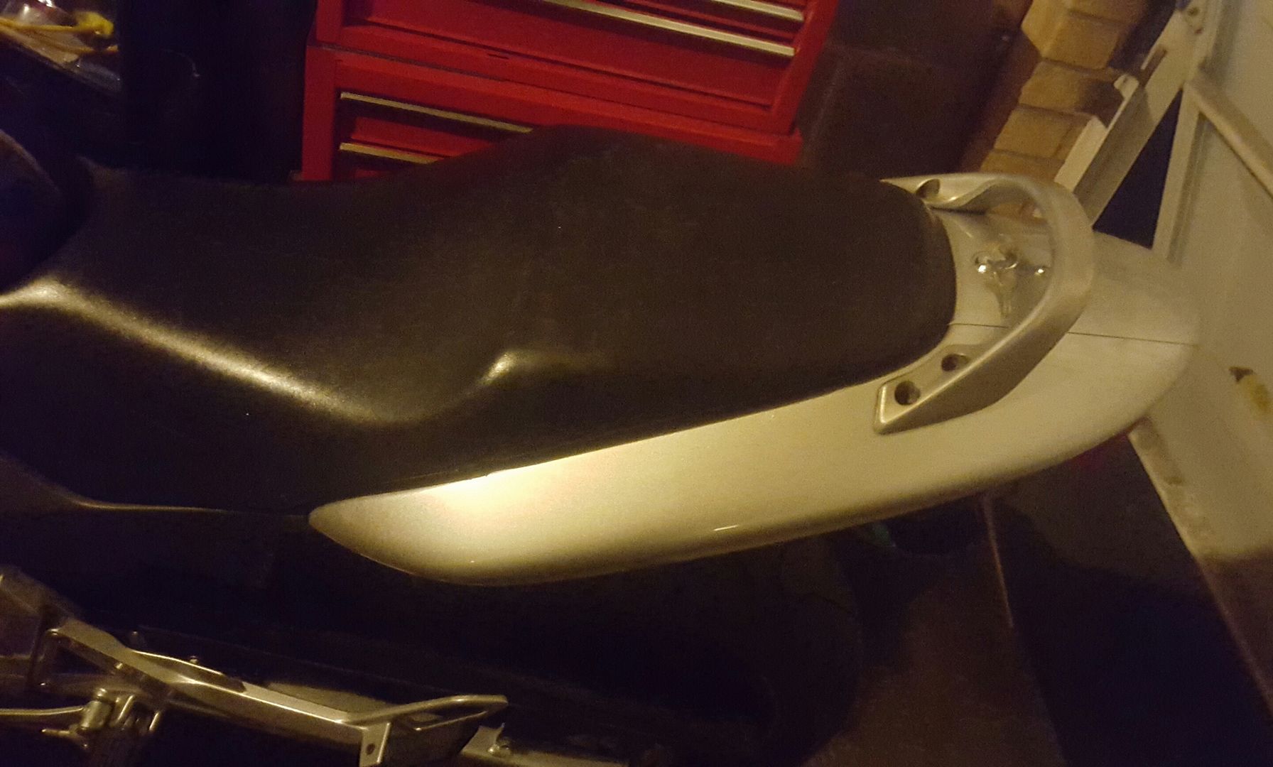

Bars, levers, switchgear etc fitted. Also picked up a standard rear tail piece in silver for £25
I'm not sure if it's going to look ok with the standard silver on the rear with the paint job on the tank. I think I will buy some blue vinyl that matches the blue stripes and see how it looks instead of splashing out on painted stripes. I need to get a grabrail and think I will get it powder coated in gloss black..........Probably :p

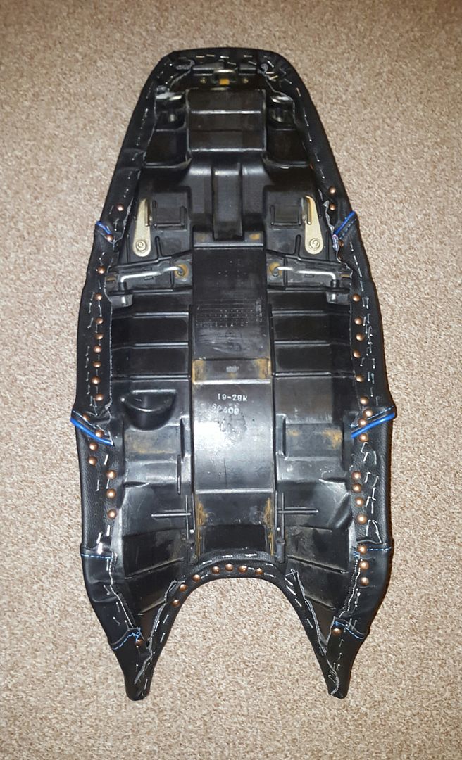

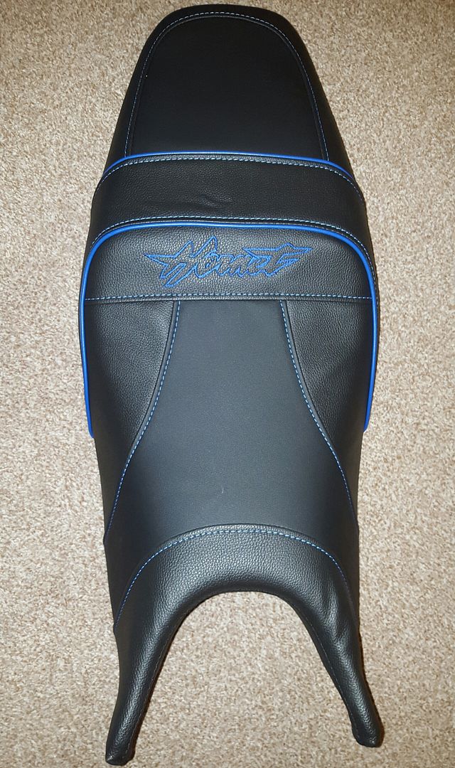

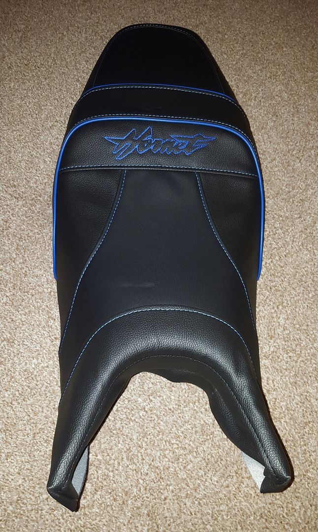

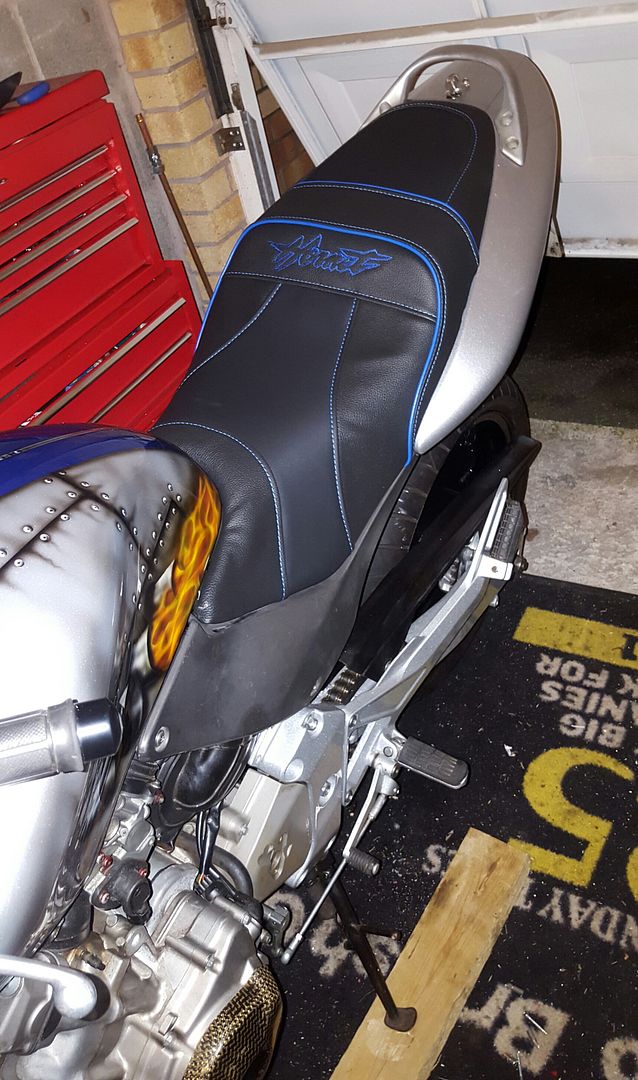

Stripped off the old seat cover and stapled the new one on, had a lot of trouble with the stapler which didn't seem strong enough to pierce the plastic seat base :Bang bought some upholstery pins / tacks which just bent over as soon as you tapped them in :Bang
As this is my first seat recover I think it will do.

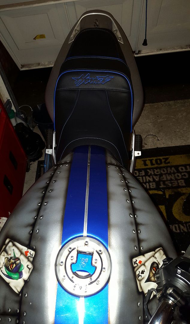

A quick trial fit on the bike.......
There's a couple of area's that could be smoothed better but hopefully when my fat farter gets on it, it will iron them out!
And for £12 I think.............

Did a little bit to the bike today, fitted the fan to the radiator. I had given it a lick of paint the other night ........
The fan fits the Chinese £58 radiator a treat. I fitted the rad to the bike but first I gave it an oil change and fitted the downpipes as with the rad removed it made life a little easier.
