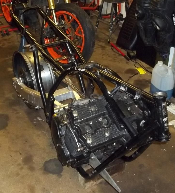

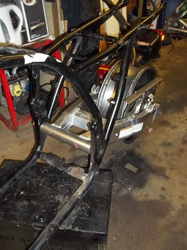

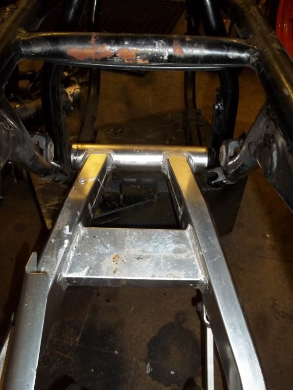

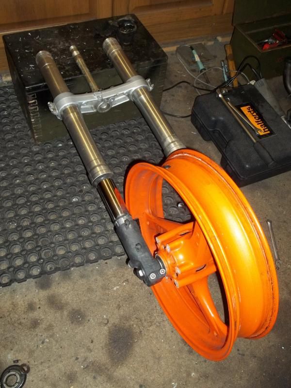

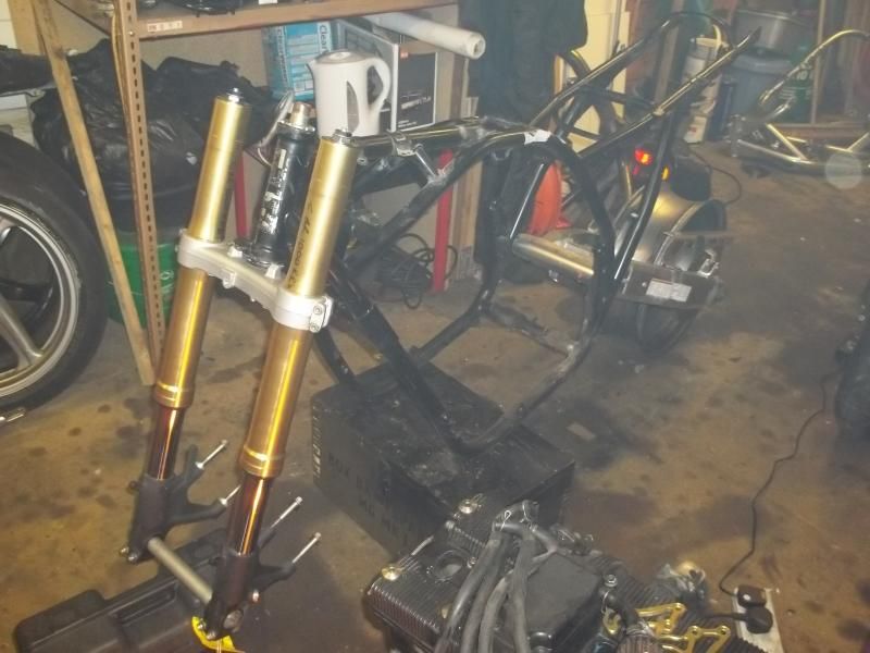

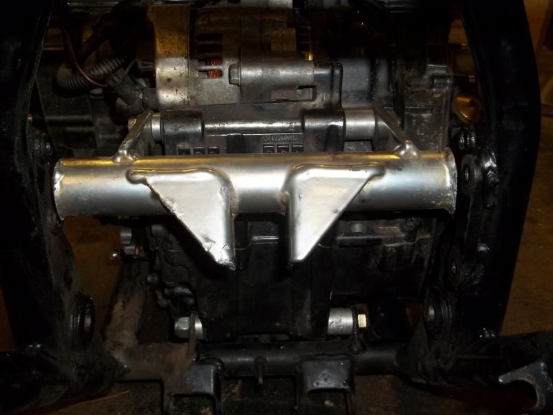

 Post Posted: Fri Oct 14, 2016 12:23 pm
Joined: Mon Jul 13, 2015 8:08 am
Posts: 1912
Location: In The Garage

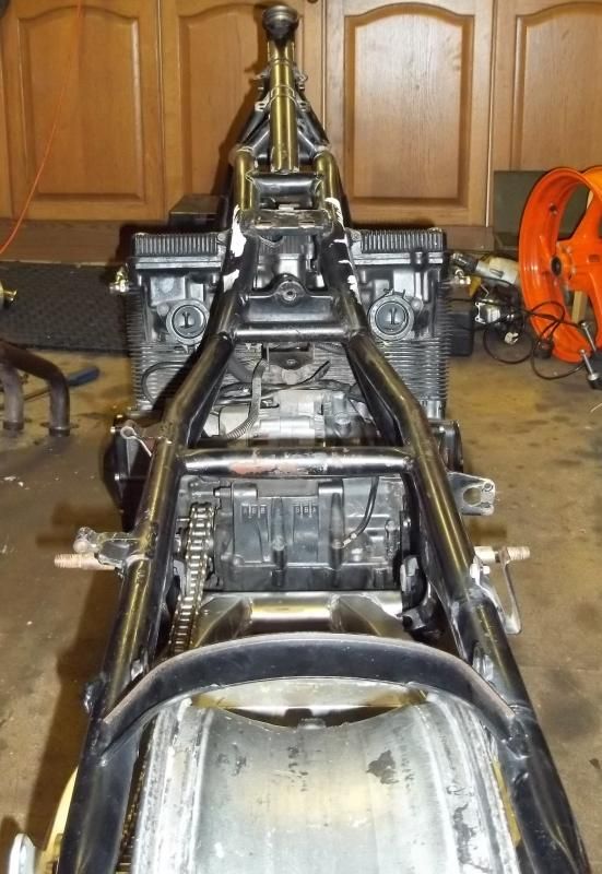

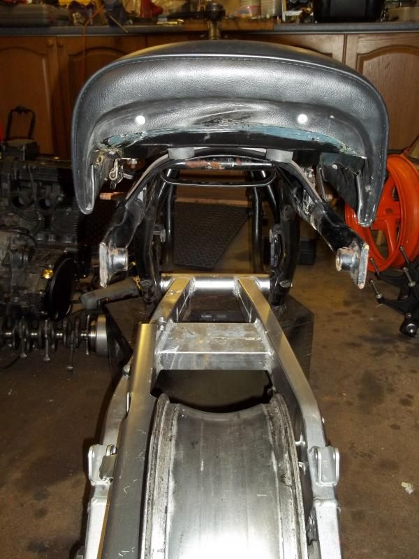

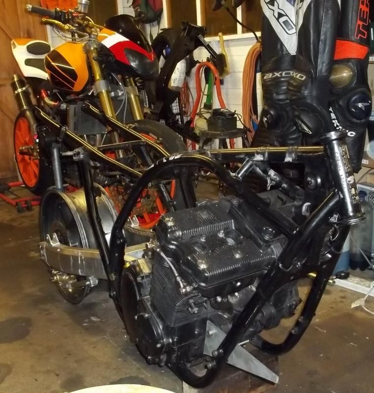

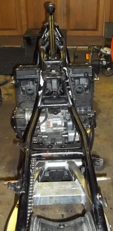

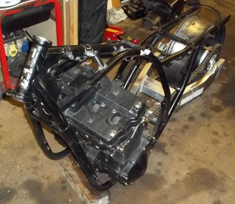

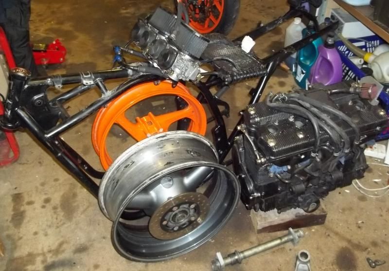

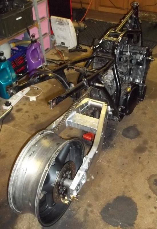

Image1 EXHAUST PORTS PAIR VALVE STUD copy by Hoon Ninetyeight, on Flickr
ImageHEADERS 3 copy by Hoon Ninetyeight, on Flickr
Image3 HEADERS 2 copy by Hoon Ninetyeight, on Flickr
Image2 HEADER STUDS copy by Hoon Ninetyeight, on Flickr
Image4 HEADLIGHT OFF by Hoon Ninetyeight, on Flickr
Image5 REAR SET by Hoon Ninetyeight, on Flickr
Image7 ENGINE OUT 1 by Hoon Ninetyeight, on Flickr
Image8 SIDE VIEW PLUS WHEELS copy by Hoon Ninetyeight, on Flickr
Image9 REAR SIDE VIEW MINUS WHEELS copy by Hoon Ninetyeight, on Flickr
Image10 ENGINE REMOVED by Hoon Ninetyeight, on Flickr
ImageWS FRAME REAR VIEW copy by Hoon Ninetyeight, on Flickr
 Post Posted: Fri Oct 14, 2016 12:39 pm
Joined: Fri Jul 17, 2015 7:02 pm
That oil cooler is so ugly... but might it look good with the removable part painted bright red, or yellow?
Then file the tops of those fin like casting lines and polish then. It'll look like superchargers do in some car engine bays.
What's your plan with the engine... actually what's your plan with the whole bike, taking it back to stock or going for a custom look?
 Post Posted: Fri Oct 14, 2016 1:57 pm
Posts: 1912
Hi Knee-Jerk :D - yeah - the oil cooler is a bit of a carbuncle :puke - but the whole plot looks a lot cleaner minus the pair valve assembly!
Regarding the engine (and the rest of the bike for that matter) - to quote Amy Winehouse i'll be going 'Black to Black' mixed with hopefully some kind of subtle metallic colour for the tank and tail.:
The whole point is to come up with a more contemporary colour palette for the Hornet - the original late 90's bike with it's Chrome and 'Candy' metallic colours really dates the bike - which is fine if you want a historically faithful example of the bike - but personally I would like to bring the bike aesthetically up to date..
Either matt or satin black engine.
Black headers.
Black fork lowers.
Black swingarm.
Black frame.
Black clocks casing.
Black after market mirrors.
Black brake/clutch levers.
Black after-market rear sets.
Black headlight rim.
I'm planning on a muted, modern metallic colour for the tank and tail - either one of those nice Audi/BMW graphite/gun-metal colours from Halfords, or maybe something more interesting like a subtle burnt orange or fawn metallic.
The front mudguard will be black.
Wheels will be matt black (I've toyed with the idea of different coloured wheels - light gold or something but decided it would be over-kill and would detract rather than add to the looks).
Regarding the custom look - I'm going to be going for a relatively light customisation - I'm planning on replacing the standard tail unit with a Hornet cup item to give it a single seat look - plus I'm planning on replacing the standard rear tail light with a couple of round rear tail/brake lights.
I'm also planning on fitting a Hornet cup belly pan which I'm thinking of painting matt/satin black.
Other aesthetic changes will include some retro style fork boots and the aformentioned after market mirrors (either conventional or bar-end) and levers and mini indicators.
I'll be losing the standard can and chrome shroud for a Black Widow end can.
Suspension: Hagon progressive springs at the front and a standard OEM shock for the rear which I got cheap from Italy.
I'm going to fit the original can and tail unit for intitial testing and carb set up (I'm rebuilding the carbs) and the MOT - if everything is hunky dory I'll then fit the after-market can and tail unit.
I'll also be fitting an after-market fly screen - one of those small tinted ones - not one of the larger more practical hideous ones.
At the end of all this If things turn out well and funds allow I might remove the clocks and replace them with a single, small round digital unit (probably a Koso or something). I'm also planning on fitting a small digital voltmeter (for keeping an eye on the electrics) and a gear shift indicator (not really necessary - just a bit of fun).

ImageTPS copy by Hoon Ninetyeight, on Flickr
ImageDSCF5775 copy by Hoon Ninetyeight, on Flickr
ImageTPS COST by Hoon Ninetyeight, on Flickr
ImagePATTERN PART by Hoon Ninetyeight, on Flickr

About the TPS - you might not need to worry about it.
The FCR on my DRZ has one and it plugs into the ECU. A common mod for the SM crowd is to buy an aftermarket version of that carb (as the DRZ SM has a cheaper/smaller carb as standard), anyway... these FCR carbs did not come with a TPS but once installed you couldn't tell the difference.
One of the main men who tunes these engines (in the US) said his dyno has resolution down to approx 1/4 hp and it could not see the difference with connected or unplugged.
So it might be worth giving it a try without it.
I guess the TPS does more on a fuel injected bike but on a carb'd bike it can only adjust the timing a little so I suspect it makes very little difference.

Thanks Knee-Jerk! :D Yeah that's definitely food for thought - would be great if I can just ditch the thing :D
