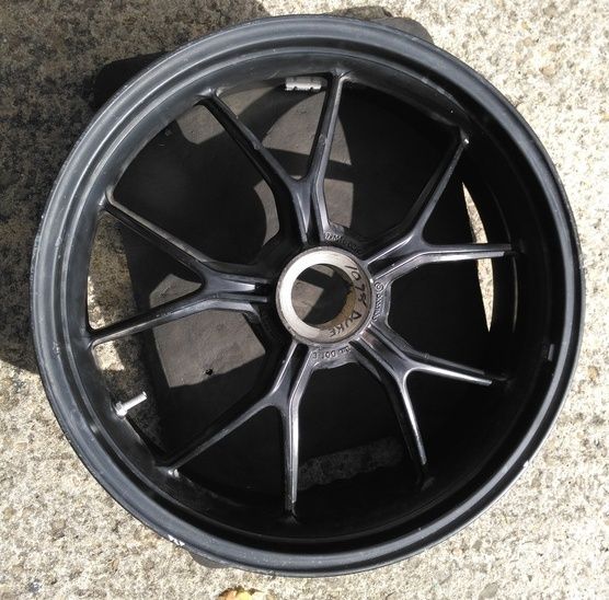

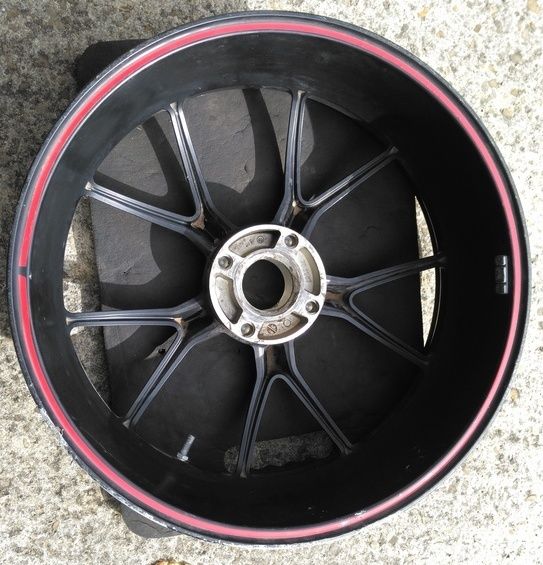

done a deal on a Ducati 1098 lightweight wheel off a member of another forum
just a case of waiting for all the bits to get here now :D

got the wheel and hub assy :) just waiting on the wheel and sprocket holds nuts now :)

It will (or should :help ) make a big difference i hope, the wheel is MUCH MUCH lighter than the car wheel, the Ducati hub with lightweight sprocket carrier are also much lighter than the VFR one coming off.
in total i would guess that i will be around 14lb lighter at the rear.
also i will be fitting a tyre that is supposed to be fitted to this rim, so will have a profile that is more in tune for going round corners than the one coming off.
