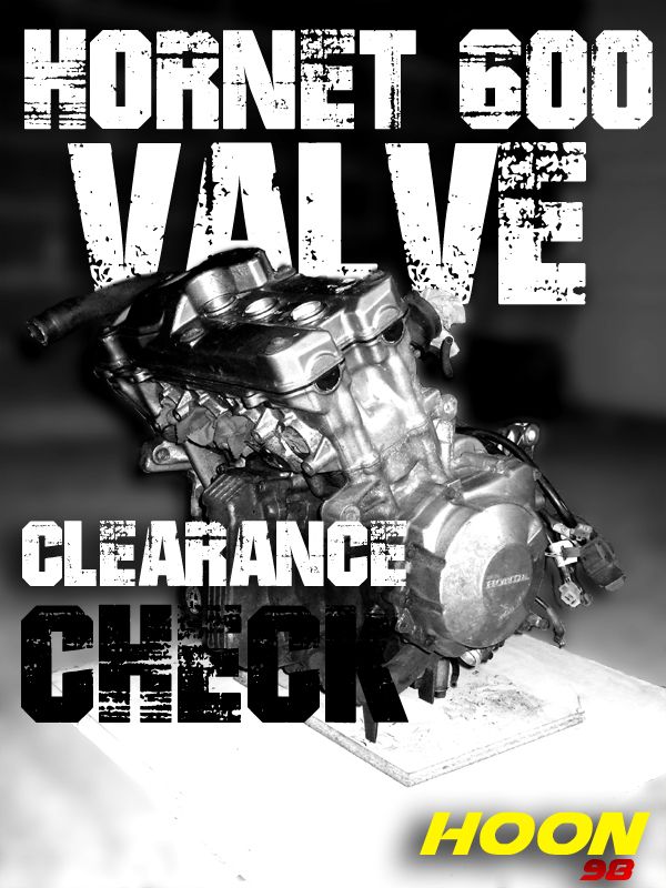

Hi guys,
As part of my restoration project I'm going to be checking and potentially re-shimming my 1998 Hornet 600's valve clearances (depending on the results of the clearance check).
I'm hoping that this thread will prove to be useful for fellow forum members who are looking to improve their service and repair skills (like myself) and who wish to check/adjust their clearances in the future - so if any of the more mechanically experienced and knowledgeable members (you know who you are! :D ) see any bad practice or mistakes I will amend the thread in order to show best practice - as I don't want to mislead fellow Hornet owners! So if you see anything amiss please shout out! :D
I will be following the Haynes manual in combination with the Honda shop manual to ensure that the procedure and data supplied are correct.
As you will see - I will be checking the valve clearances with the engine out of the bike - so I won't be showing people how to remove fuel tanks, HT leads etc - but then if you are confident enough to be contemplating checking and possibly adjusting your valve clearances these tasks should not be an issue for you anyway.
As you can see from the title pic above I'm going to bling up the photographs a bit with an attempt at some graphic design and some funky text etc to make the thread as attractive as possible to look at.
Thanks for your attention :D
Let the fun commence . . . :hb

Is it possible to do this with the engine in the bike? I suspect not.
Hi mate - yeah - actually usually you would check the clearances with the engine in the bike - there is no need at all to remove the engine for this job.
The only reason the engine is out of the bike in my guide is that I'm doing a rebuild and the engine was lying on the floor so I thought it would be a good opportunity to show the process without the frame and cooling hoses in the way etc.
All you have to do is remove your fuel tank, pop out the HT leads and then remove the valve cover (if I remember rightly it can be worth unbolting the rad so that you can move it forward very slightly to make it easier to remove/install the valve cover) - then you will be in able to do everything I have demonstratred above including removing the cams if you need to re-shim.
2nd question, if the engine is sat on the floor, is it sat at the same angle as it would be in the bike? Reason I'm asking is that would 'straight up' be the same when the engine is off the bike?
Yeah - good point and something I checked out - as far as I can see it's at the same angle. I'm probably going to reshim with the engine back in the frame - so i'll check the clearance again and check the figures match up - but like I say - not something you have to worry about as you can do this job with the engine in the frame.
Also how did you support the engine when its out? can it just sit on its little legs on the sump or does there need to be some other support?
Yeah - it sits on the legs which project out of the sump - very thoughtful bit of design - thanks Honda!
