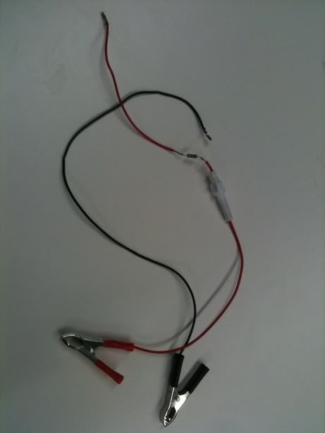

- I recommend a 1K Ohm 1/4 watt resistor instead of the 100 Ohm 1W resistor shown on the page.
Honda cable replication - further notes
Basically, it appears that all we need to do is to supply a "HI" signal to the ECM via the red plug (Ignition Pulse Generator plug?).
I'm not sure why Honda charge 100GBP for the programming cable. It's literally just two leads!
I used 2x 2.3mm female spade sockets I found at my electronics store to hook into the socket without risk of shorting.
I've heard of people making the cable with:
- A resistor inline to the circuit (This helps protect the battery, as if the cables are shorted, the resistor acts as a load
- A diode inline to protect the ECM if hooked the wrong way around (I suspect the ECM doesn't draw any current, but why risk it)
- A fuse.
I decided to hybrid two of them, and I soldered a 1K Ohm 1/4W resistor in series with a 1A quick-blow fuse.
These probably aren't necessary, since it's likely we're hooking it into a digital or ADC input, but I wasn't game enough to take the risk :). I've read of some people getting it to work without the resistor, diode or fuse.
Good luck! Just a 5 minute job!

Summary of instructions in case original source disappears:
- Buy a spare blank Honda Key with Transponder that corresponds to your bike.
- Get the key cut.
- Remove side panel with one bolt on battery side.
- Hook +12V to yellow cable of red IPG plug (the socket with male pins)
- Hook GND to white with yellow cable of red IPG plug
- Place working key into ignition and turn to on
- Unhook positive cable from battery for at least 5 seconds
- Re-attach positive cable
- You should see 4 slow flashes, indicating that the key registry was wiped, and the current key in the ignition was added.
- Turn key to off and remove key. DO NOT disconnect power source yet.
- Place blank, already cut, new spare key into ignition and turn to on.
- Watch for 4 slow flashes. Once that happens, the 2nd key is added - turn key to off, take it out.
- Repeat for any more spare keys you want to program (Up to 4 keys total can be remembered I think).
- You're done! unplug the power supply, remove the cables to the socket, re-attach IPG plug and you're done!
