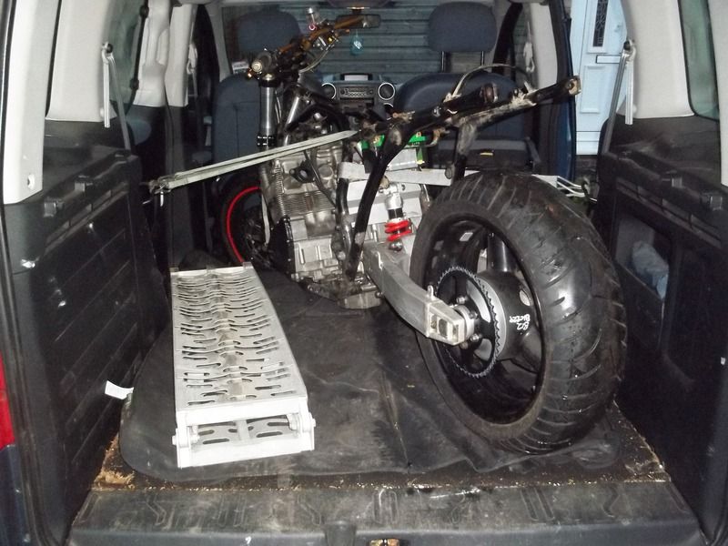

got bike in back of car ready to take to work tomorrow, going to tack all the bits in place, strip the engine out and take the frame round
to the welders, that way he can do the work as and when he gets the chance.

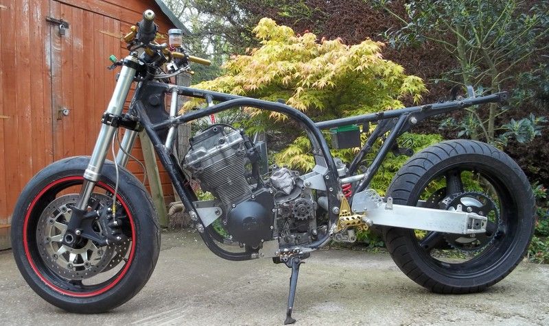

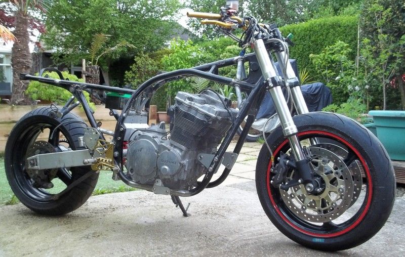

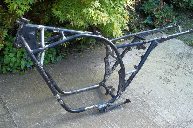

got bike tack welded, all the bits now in place, stands a little bit too upright on the side stand, so will either
cut it back off and re weld or cut a bit off the end!
will get all the bits off and get the frame round the corner soon as posible.

frame now with the welders for final instalment, should pick her up again
some time this evening all ready for clean up and dressing off ready for powder coat.

spent most of this morning cleaning up the frame, grinding down the weld infills, and removing unwanted metal.
is now all but ready for trip to the powder coaters.

frame now sorted, holes all filled with old bolts, steering head sealed with some old plates.
just need to get it to the coaters.
will be removing all the engine cases, swing arm, wheels and plates for coating too.

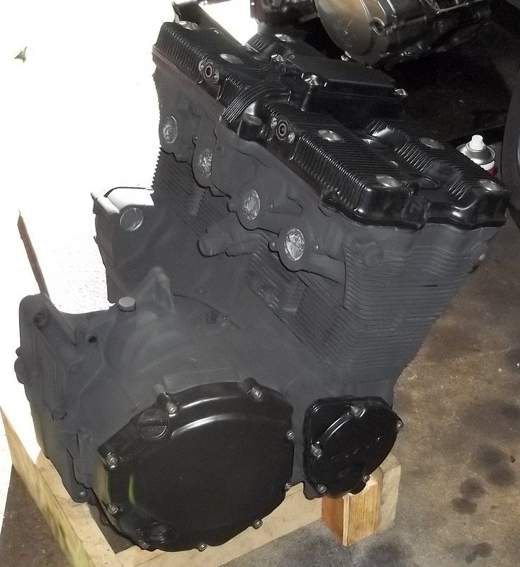

spent this afternoon going over the motor with a wire brush attachment in my drill.
came out quite well, just a few small areas that need doing (didnt have a small pointed attachment left, will be getting one)
then it will be de grease, paint and off with casings for powder coating.

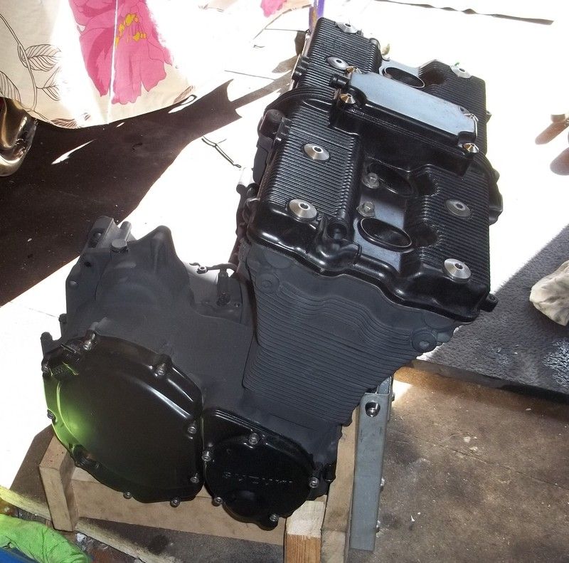

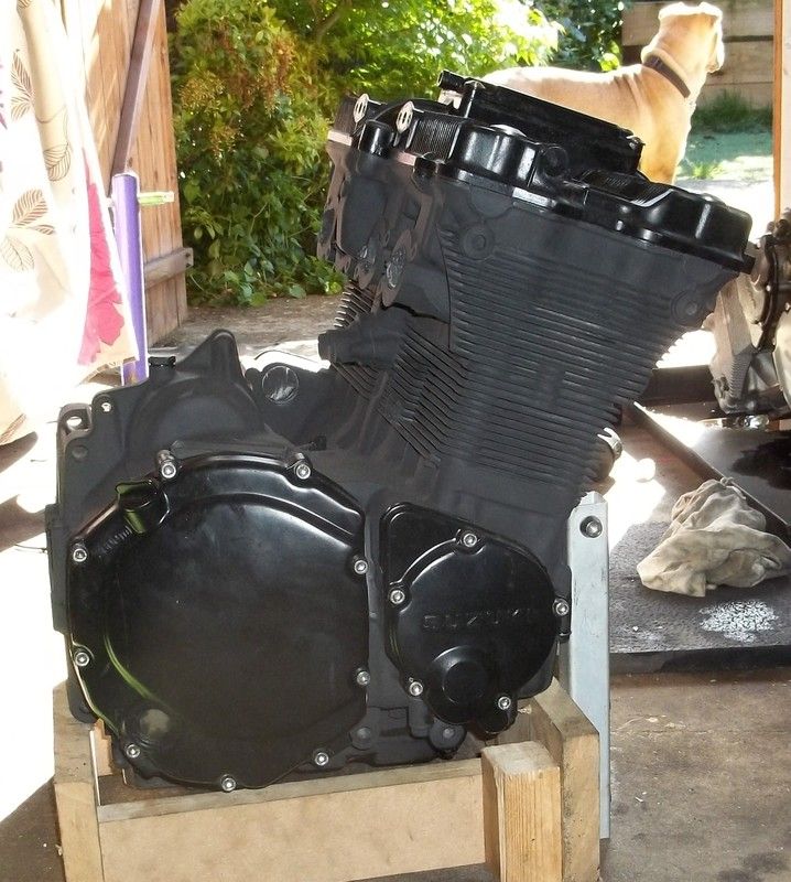

as the weather was good i finished off cleaning up the engine, gave it a couple of coats of matt black, looks darker
in real life, pics dont do it justice.
but i think it goes well with the semi gloss cases.
starter motor, generator and sump will all be semi gloss too.
